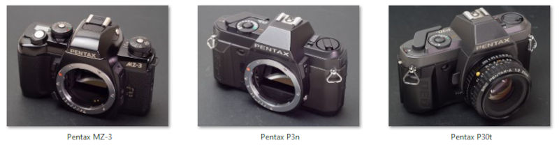

I wouldn't say that refurbishing Pentax MZ/ZX/P3/P30-series cameras has been particularly lucrative for me, but there's a certain sense of accomplishment in turning junk into something useful again. I sold this trio the other year, haven't decided whether to continue fussing with Pentax or Minolta SLR repairs, but sometimes find myself lingering over Minolta XD-S, Asahiflex and Pentax SL auctions.
