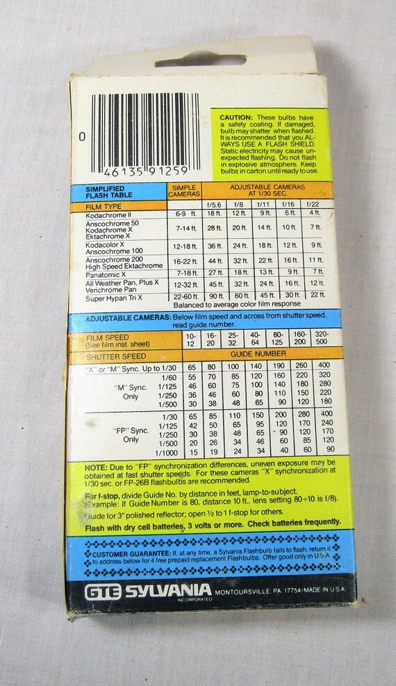

I'm seeing on the back of a box of M3B's (link) that it has guide numbers for focal plane shutters. If I use this in my BC-7 and Nikon F do you think it'll work? Anyone have experience with them? I might have to do my own tests.

Regarding flash sync, I believe AG1 bulbs work well with focal plane shutters with fp sync.
