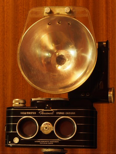

I use M3 flash bulbs with my View-Master camera. It was designed to take larger M5 and M25 bulbs but I find that even the M3 bulbs are too bright for an ISO 100 film. I use an adapter to use the M3 bulbs. I replaced the clear shield on the camera below with a translucent white plastic to reduce the intensity. The people I take pictures of were very thankful, their vision is starting to recover. I did a series of test shots with the new shield at various distances to determine the best exposure. I put a sticker on the back of the flash that tells me what f-stop to use at a given distance.
View-Master Personal Stereo Camera by Bryan Chernick, on Flickr

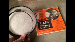

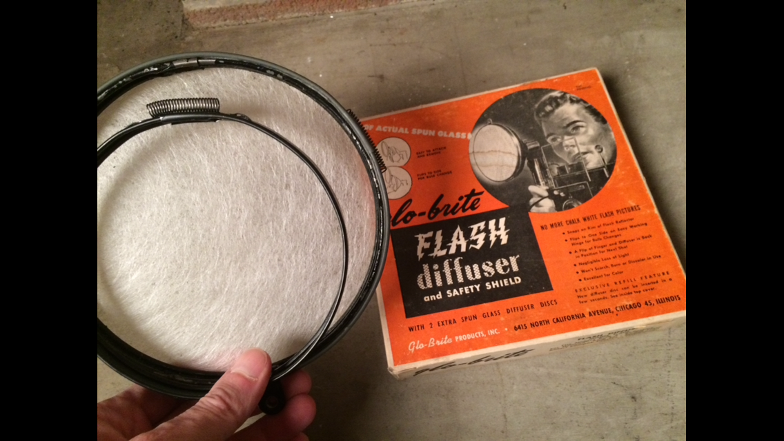

The box arrived today and came with an interesting item. A spun glass flash diffuser and safety shield.
