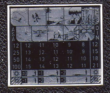

Love the graghics on theback of my Rollei!
