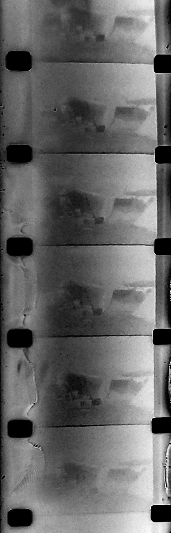

I have an update. I've processed the OP's film B&W negative and there are some images on it. The film is still drying so this sample is near one end and still wet. I just put the film up against a bright lamp, photographed it with my phone and reversed it electronically. I'll take another look likely tomorrow when it's fully dry. Fogged, but images!

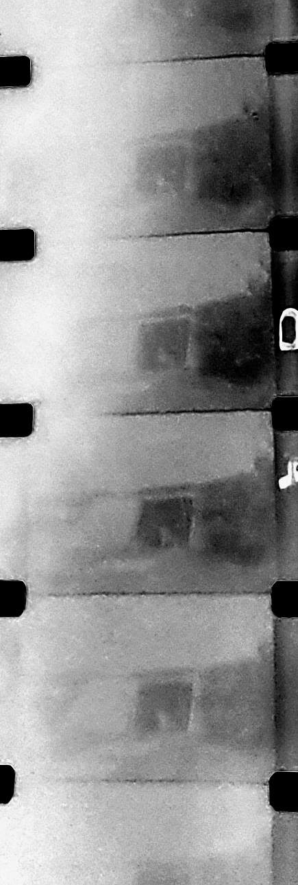

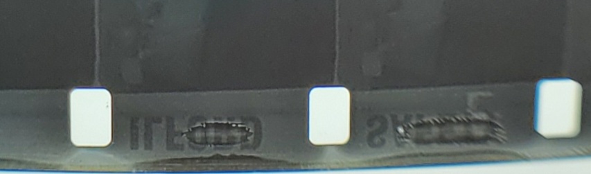

The film is now dry, I've had a look and most of it seems to have visible images, albeit fogged so low contrast. The film is Ilford, when did Ilford last make 16mm cine film?
OP suggested from my first image that this could be a camping holiday, and that's definitely a possibility.

Ilford 16mm film was available into the 1990s, FP4 Plus was available as 16mm motion picture stock in 400ft cans., there may have been other sizes. I don't know when it was discontinued. FP4 Plus was introduced in 1990.
Ian
Good to know @Ian Grant
I knew 35mm Ilford cine film was available until about 1995, but wasn't sure at all about 16mm.
In the next few days I am going to mail this back to the OP, who might have it professionally scanned. As an exercise in retrieving what could be very old images, it was fun to play my part.
I want to express a huge thank you to Angus for processing this film for me. It's interesting to note the Ilford branding inside the cassette, it seems it has been re-filled and used in the past then!
I will have this transferred and post the results onto YouTube and provide a link, it will be interesting to find out an approximate date of when this film was exposed and work out how long exactly its been waiting in the camera for its chance to show the world its content.
