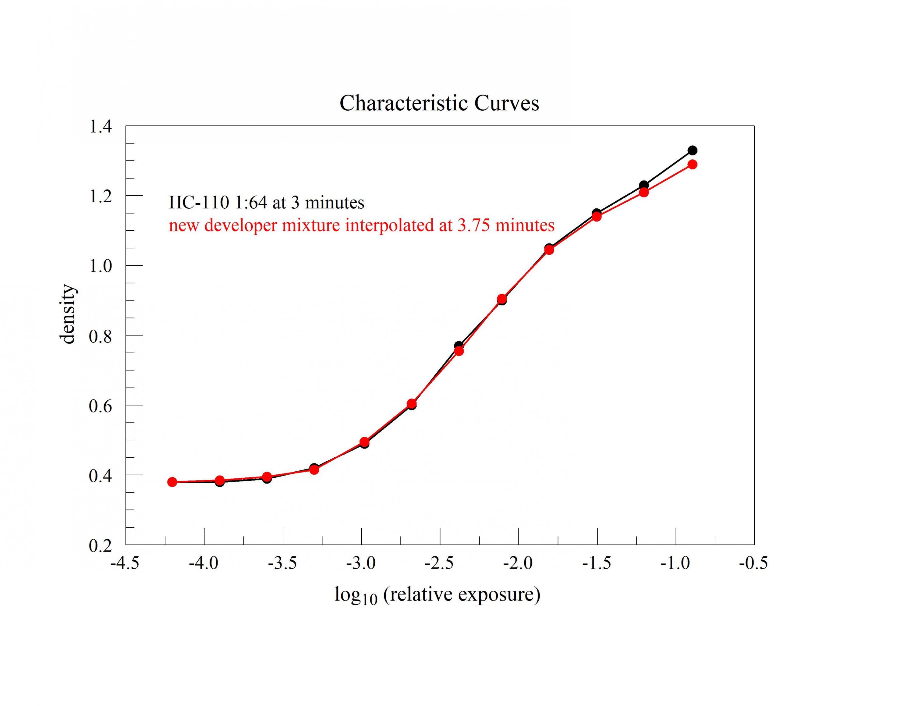

However, before doing that run I also did several other experiments. One was a clip test to see how much vinegar would give a development velocity roughly comparable to 1:64 HC-110, and a 1:16 HC-110 diluted into 0.625% acetic acid developed the clips almost as fast as the 1:64. This was evaluated by eye as the clips developed under regular room light, so it was only a very rough test to get a starting point.

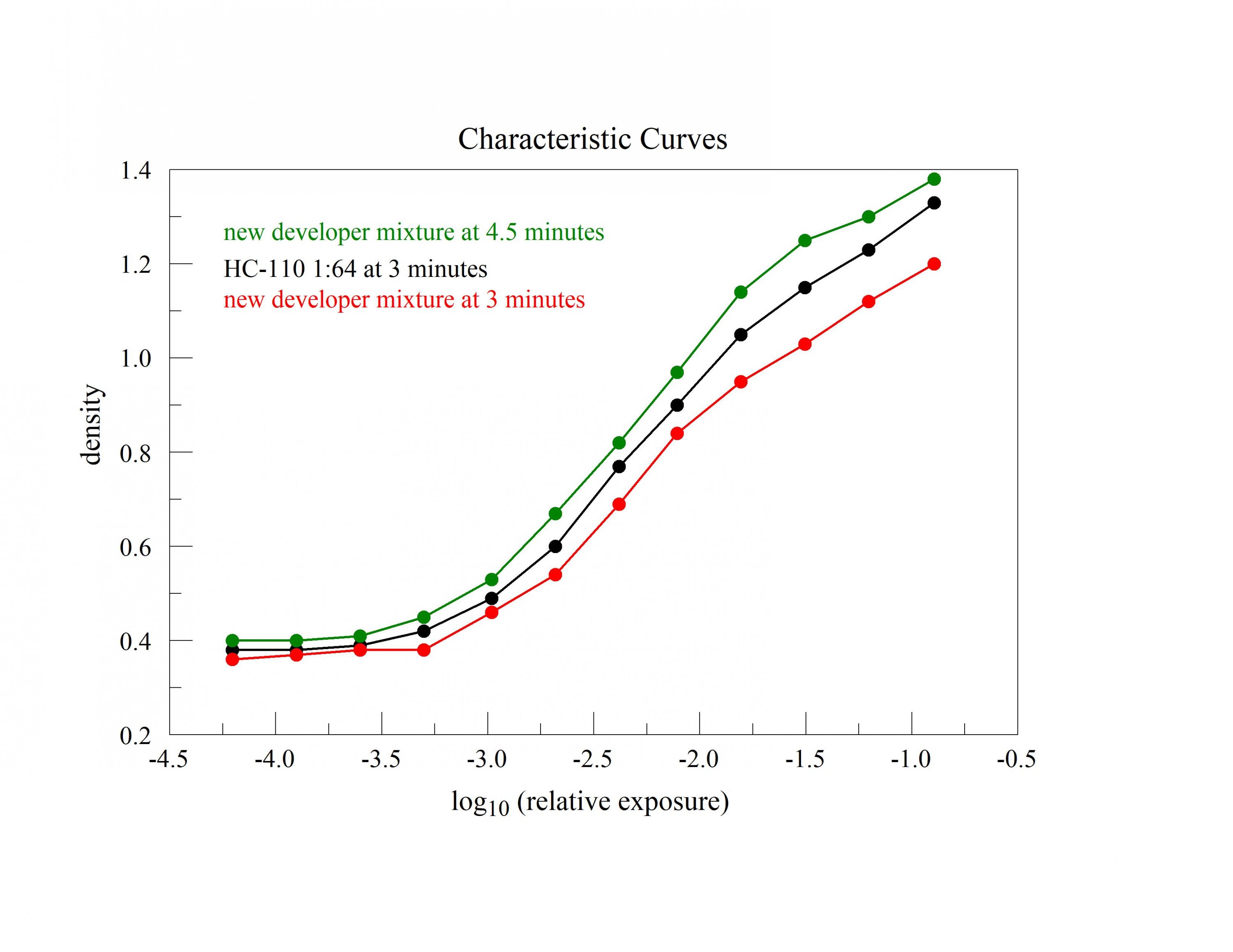

Before I generated the characteristic curve for the new developer run at 6 minutes, I did three other runs. One in 1:64 HC-110 developed for 3 minutes using a series of exposures of a blank wall, one in the new mixture (1:16 in 0.625% acetic acid) developed for 3 minutes, and one in the new mixture developed for 4.5 minutes. I didn't plot those results because I wanted to avoid too much information-clutter. However, I now show them here.
As expected, the new mixture was roughly equivalent (but slightly less) in activity compared to the HC-110 1:64 mixture. If I ran the development a little longer it was slightly more active. Interpolating between those to curves to predict how the HC-110 1:64 developed for 3 minutes would compare to the new developer run at 3.75 minutes the overlap was virtually perfect, except for possibly a little more shoulder at high exposure using the new mixture. Here's a plot showing this.

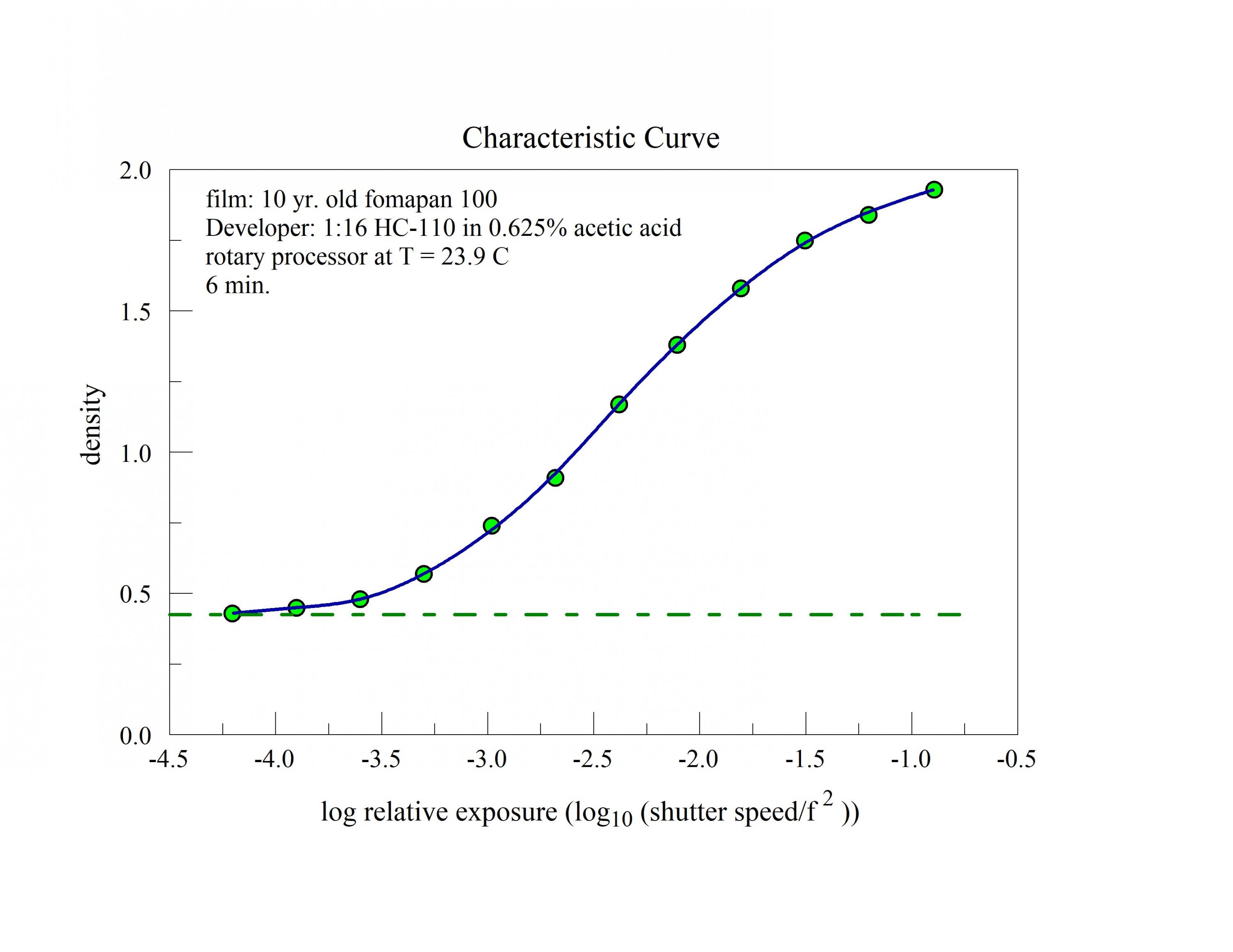

(Note, this is a predicted result for the new developer mixture based on interpolating the results at 3 minutes at 4.5 minutes, not an actual experimental measurement.) The amount of development is a little too low, so I estimated that to get the desired level of development I wanted would probably take somewhere between 6 and 9 minutes. I did a run at 6 minutes and got the curve below (which is the same one I plotted earlier).
As noted in my other post, this might be slightly overdeveloped, but I figure it is good enough for my purposes, although it might be worth dropping the development time just a bit to tame the contrast a little.

Yes, the new curves you posted show a great match between 1:16+acid vs. 1:64 with times correctly adjusted, so I guess you found what you were looking for.
A final thing I still don't quite understand is graph 1 vs. graph 3 in your posting. In graph 1 you compare HC-110 1:16+acid with development times at 3 and 4.5 minutes against HC-110 1:64, with no temperature specified in this graph. In graph 3 you developed for 6 minutes at 23.9°C and got somewhat more contrast. Was graph 1 taken at the same temperatures? If 3 3/4 minutes is normal development, then 6 minutes should be a massive push ... am I reading this correctly?
All development was done at the same temperature. The results at around 3 minutes are under developed. The result at 6 minutes is closer to normal development, though it might be slightly overdeveloped. (The results at 6 minutes are actually pretty close to the slope specified by iso for determining film speed, which is 0.62 vs. ~0.65 in these results, although some people consider the iso conditions to correspond to over development.)
