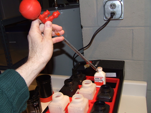

Two way that work well in my darkroom to slow down development.
1) Lower development temp. I was able to get my Jobo down to 18C with crushed ice in the un-used bottles. I did have to keep replacing the crushed ice in the un-used bottles, as 18C is much warmer than 4C icewater.
2) Dilute the developer out into spare bottles. I was able to do 100:1 Rodinal that way using six bottles; dumping and re-filling with fresh developer five times during the development cycle.

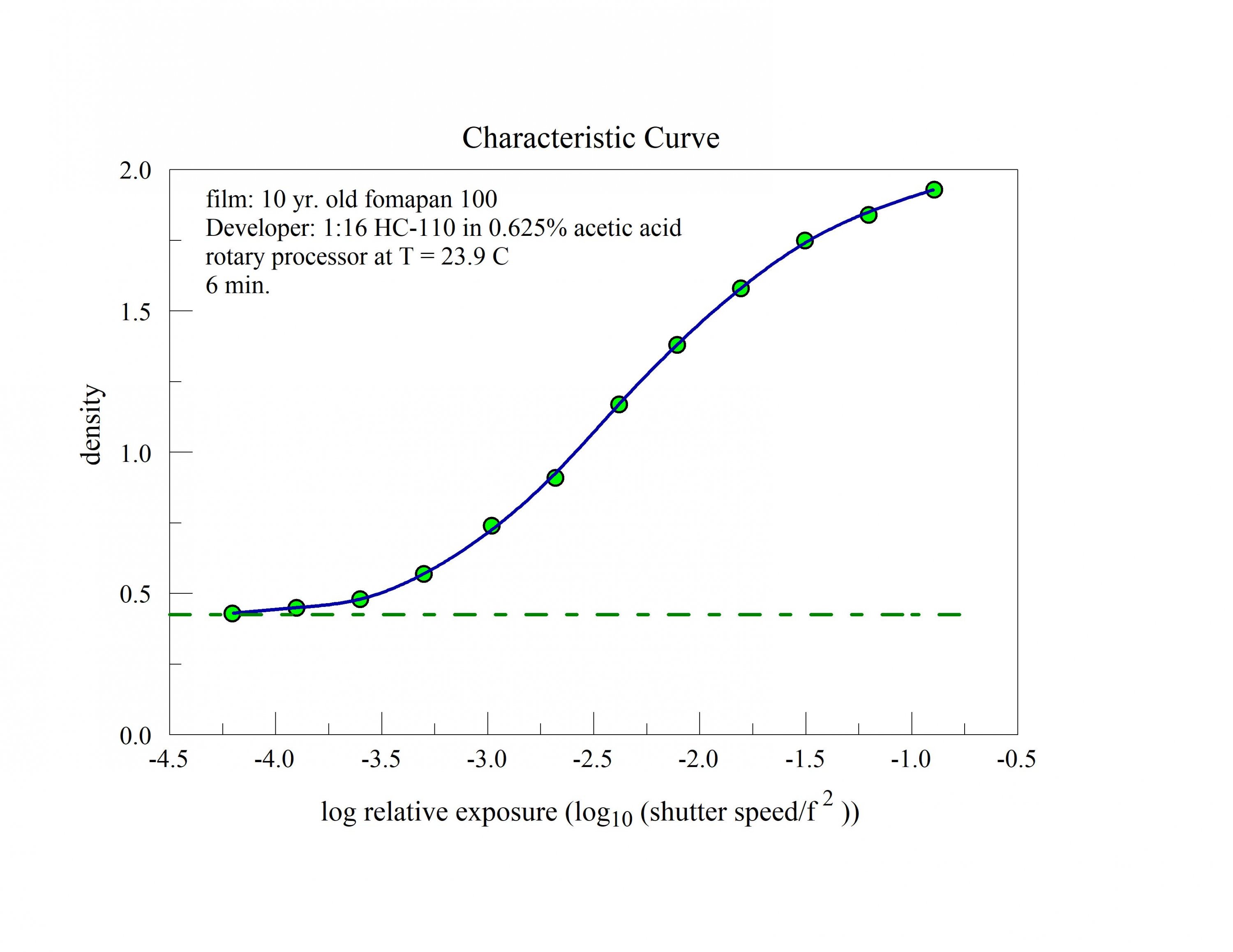

I did a little more work. I used 1 part HC-110 and 15 parts of 0.625% acetic acid. (The acetic acid solution was made by diluting 5% distilled white vinegar into water.) I am posting the characteristic curve I got. The development conditions are listed on the figure.
A couple of observations: HC-110 is often said to produce an upswept curve. However, in this case the curve is distinctly S-shaped. I would describe the curve as having fairly long toes and shoulders. What do you think? The fact that I tortured the HC-110 rather severely by diluting it into 0.625% acetic acid is probably responsible for the change in character of this developer. I might have overdeveloped the film slightly because G-bar is about 0.65. Cutting the development time a bit should bring the slope down... or maybe I will just leave it as is.
The effective film speed worked out to be an e.i. of about 50, which is about half of the nominal film speed for Fomapan 100, but pretty much everyone says that rating Fomapan 100 at an e.i. of 100 is wildly optimistic, plus these film samples are years out of date, so this result is probably not much of a surprise.
I haven't tried evaluating other factors, such as grain or sharpness.
Any thoughts?
It's kind of hard to comment on developer characteristics if you use such old film ...
Also, it would be helpful if you also post a graph made with straight HC-110 1:16. This way you'd also have a proper reference regarding film toe shape and location.
[QUOTE="Rudeofus, post: 2164294, member: 34922"...Also, it would be helpful if you also post a graph made with straight HC-110 1:16. This way you'd also have a proper reference regarding film toe shape and location.[/QUOTE]
Fomapan developed in 1:16 HC-110 would turn out black because that dilution is too active for this film. That's why I reduced the activity by adding acid, and 1:16 was required in order to get the recommended minimum 6 mL of developer per roll of film, given the volume of the tank in my processor.
