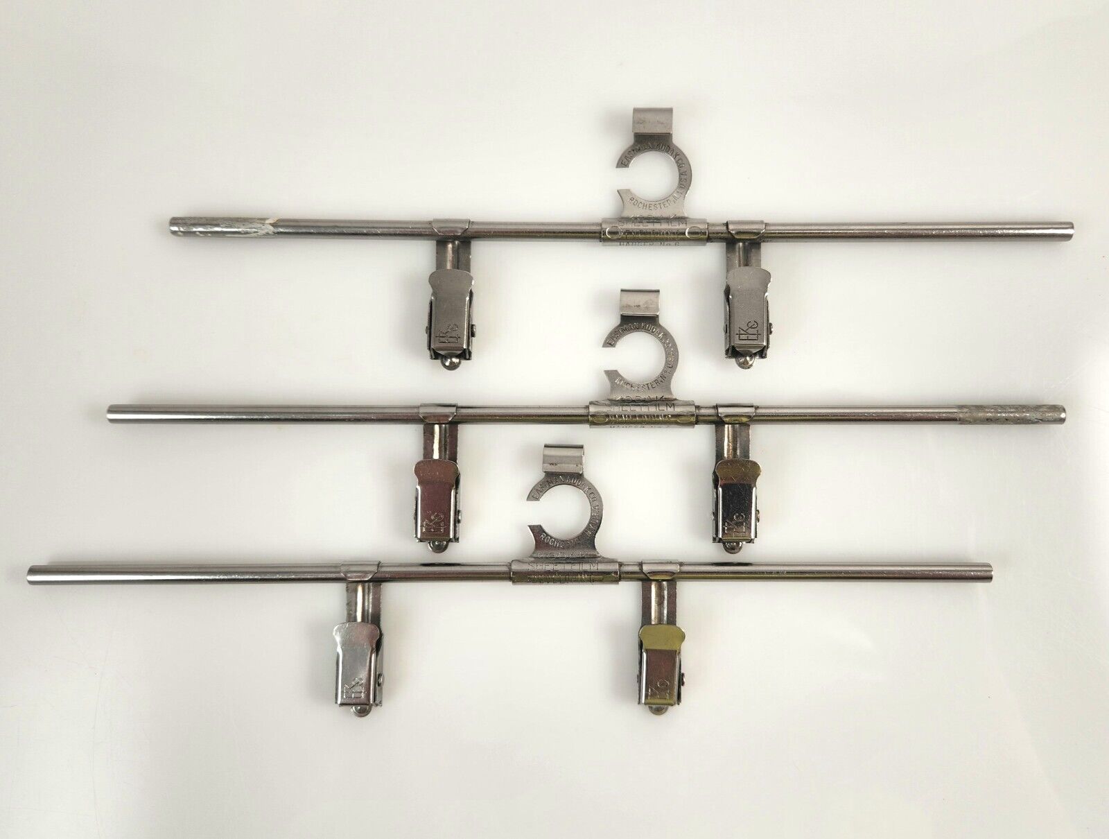

First, I would note that I process everything in the dark in 2 litre open tanks or larger. (I have temporary covers I place over the tank when I want to leave the darkroom between semistand or EMA agitations so I don't have to sit there in the dark for an hour!) This allows for plenty of developer and room to properly position film.
For sheet film, I use frameless pinch clip style hanger, though an X-Ray film clip would probably work. The idea is to hang the film horizontally so that the bottom edge is well off the bottom of the tank and to do this with the absolute minimum of contact with the film. Some people (Steve Sherman leaps to mind) have gotten very good results by making PVC tubes to hold their film to achieve this same idea...
For reels, I invert a small funnel, placing the nozzle in the center core of the reel. Then I feed the reel lift rod through the wide end of the funnel. That way, when I place it in the developer, the lift rod is there as usual, but the reel is suspended off the bottom of the tank 1-2 inches. As I mention in the paper I wrote, I'd avoid plastic reels and stick with the Nikor stainless type reels that have good spacing between wind layers.
To date, I have found this approach to work well with highly dilute D-23, DK-50, HC-110, and Pyrocat-HD. I initially prewet the film for 3 minutes in a running water bath temperature matched to the developer. I then continuously agitate the film in developer for 2 minutes and proceed with my agitation scheme thereafter (either semistand or EMA).
Image below is the sheet film hanger type I mentioned above.
