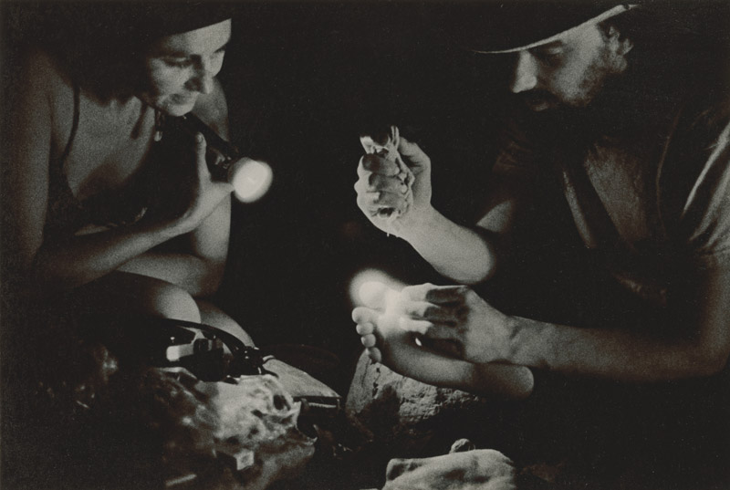

Well, just to offer a bit of perspective, I'll present a couple of images made under very harsh lighting conditions on 2475 recording film.
The first was made solely with the light of the included flashlight in a cave on a dark night. The lens was a 35mm Canadian made Leitz Summicron. This one shows obvious halation. Ain't it cool?

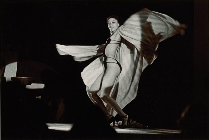

The second was made at a fashion show with the light provided by a followspot. The lens was most likely one of the old silver metallic barreled Canon 85mm LTM f/1.9's. I don't see any halation here. Of course, there could be some, but if so, it is slight and compensated by other factors.
The difference has to do with the quantity of light that actually reaches the film BASE. Films without anti halation coatings don't necessarily show noticeable halation. They will if the quantity of light is sufficient.
