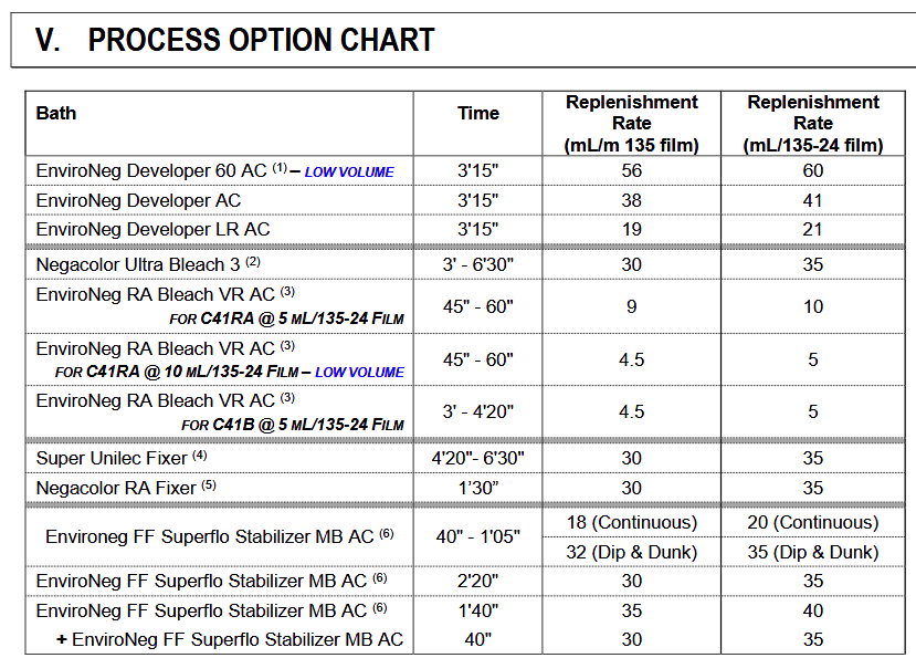

PS: this is from a FUJIFILM C41 Technical Bulletin:
Note the exact same times as those Bellini gave for rapid access processing and RA chemistry: 0:45 bleach, 1:30 fix.
