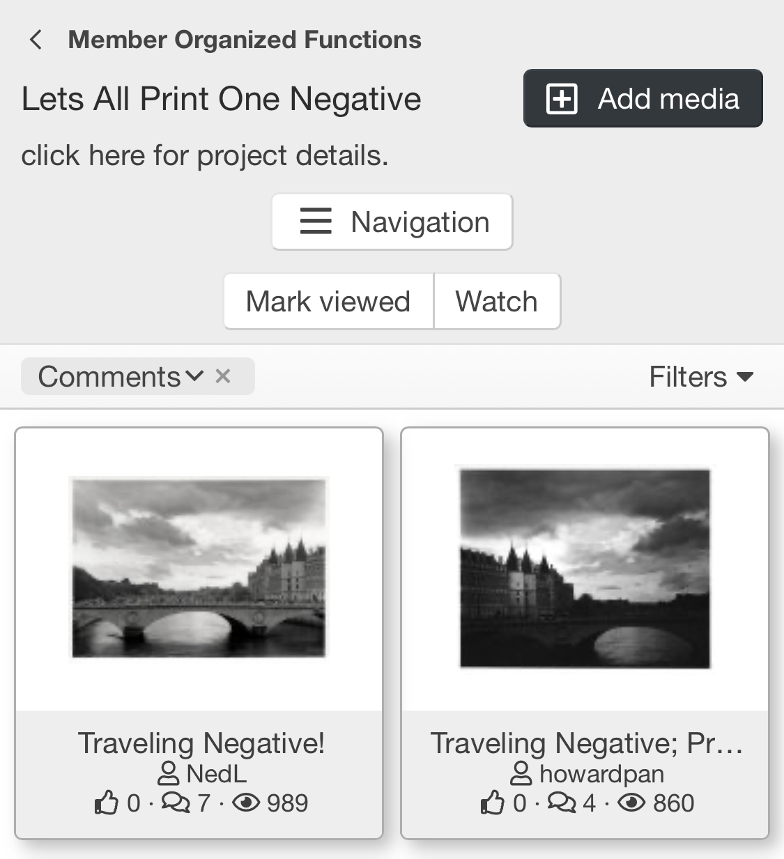

A better example would be the same negative printed by both techniques. The more challenging the negative, the better the test.
I once participated in a “print from the same negative” function here.
My negatives on 120 TMY2 batch 0149 came out with “Kodak” imprints.
Then I jointed the 4x5 team and received a 4x5 negative with beautiful sky and magnificent scenery. I think I made a print that didn’t do my ego any good. I am pretty sure I didn’t fulfill my obligation.
Here’s a similar member organized function and the different looks. My prints normally look like NedL’s here.
I imagine howardpan used split grade techniques.

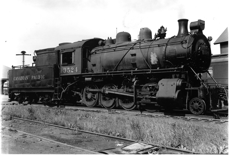

I couldn't find the prints I had made a number of years ago, so I reprinted the negative this afternoon. It's a 3½" X 5½" negative, taken in July, 1948. Because of the size, there is a bit of cropping in my 4x5 enlarger. I made the prints about 9x6"
First, I made a unfiltered print on Ilford Multigrade IV. According to the leaflet with the paper, unfiltered tungsten exposure is equal to grade 2. Next I made a split graded print. I use an Omega colour head, so I used the yellow and magenta filtration in the head. I use a RH Designs stopclock timer, calibrated for Multigrade IV. Once I determined my soft and hard time it tells me the equivalent contrast grade, which in this case was grade 1.6
I matched the tones on the cab side and firebox, when I laid the split grade test strip on the unfiltered print the tone and density were identical. Then I scanned the prints with an Epsom V750 flatbed scanner. The images on screen don't capture all the differences visible on the prints when they are side by side, so you'll just have to trust my descriptions!
Once thing that is immediately obvious is the unfiltered print has lower contrast than the split grade. The sky is darker and there is less separation in the grasses. The blacks in the shadow areas under the locomotive have equal apparent density. When viewed side by side, the unfiltered print appears muddier, although in theory it should be the higher contrast print. I have not tried another print to attempt to match overall contrast.
Some observations are that the split grade print has better tone separation, the driving rods have more definition between edge and centre, the highlight on the driver flange is more visible. The lettering on the builders plate seems crisper and more visible. Also noticeable is the grasses have more separation and more definition between the grass and taller weeds.
The scans here are really a poor approximation of the actual prints. I'd encourage anyone wanting to do a comparison to make their own prints and compare them, rather than relying on these scans.
