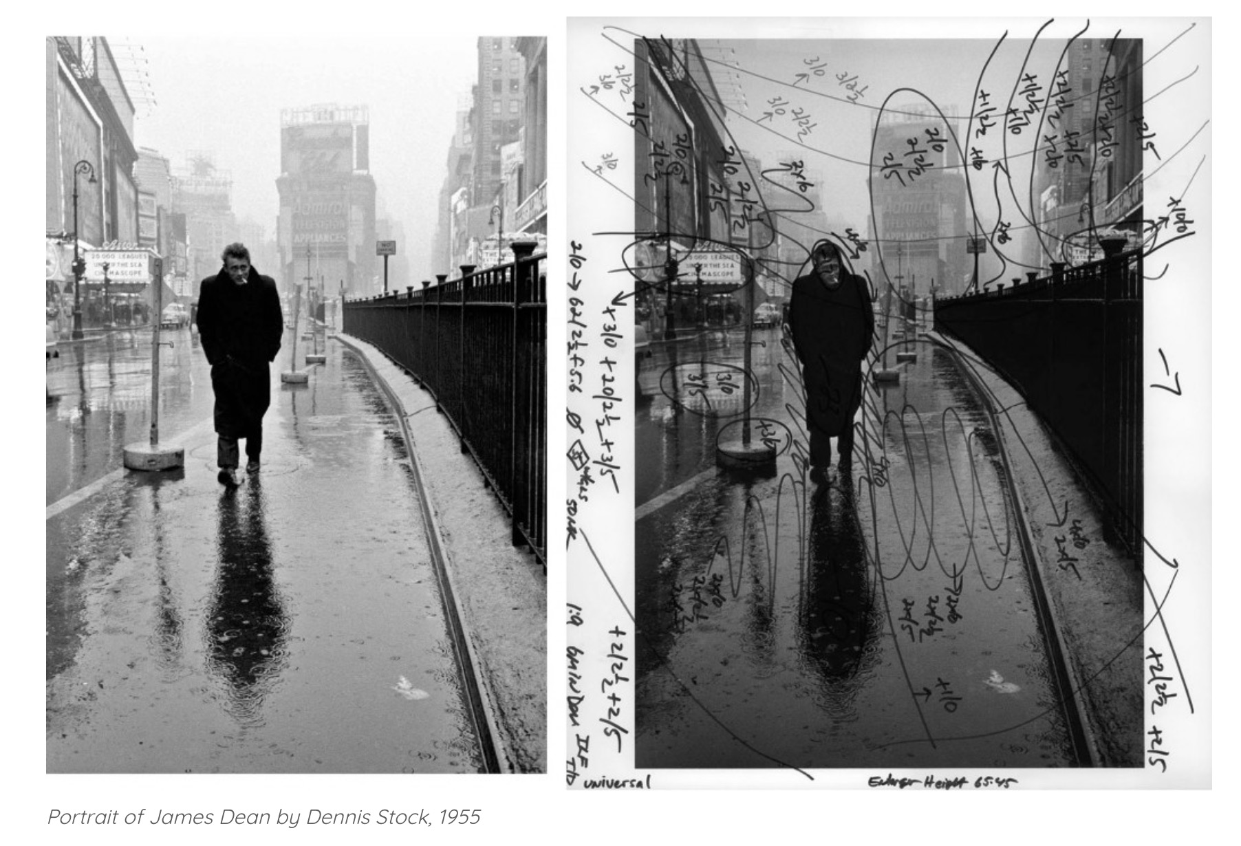

Looks like these notes are # of seconds / contrast grade for specific burning - the base exposure is 45 seconds at filter 2 plus 15 seconds at filter 2.5 -- all at f5.6 (which is bright for a 1 minute exposure). That, of course, may be wrong.
Is there any example anywhere of a straight print and an Inirio (or other master printer) compared, for any famous photograph?

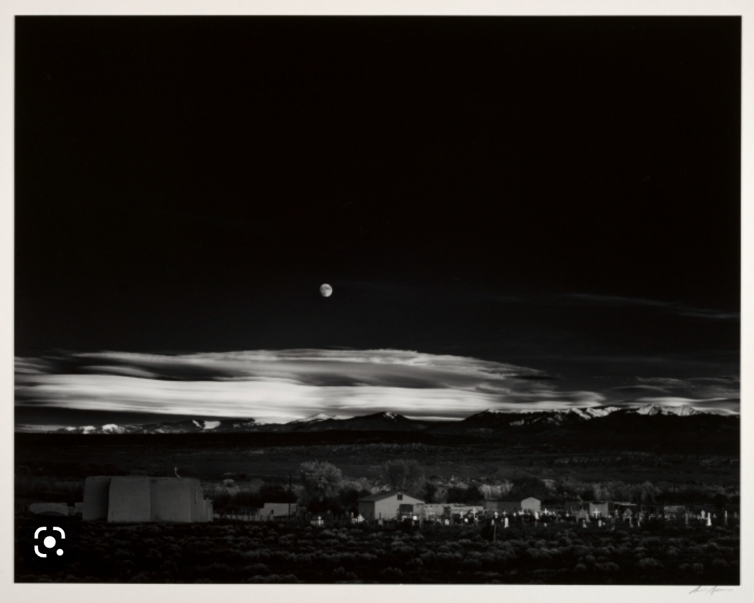

Here's an example. Also, Ansel Adams made a number of his famous prints with different amounts of dodging and burning, you might try to locate images of some of those.
AA's.....Moonrise Over Hernandez, maybe some haven't seen it yet. I've never seen one with printing notes on it, though.
If you do a Google search on "Dennis Stock James Dean 1955 NYC" you'll find a number of versions of the image Pieter12 posted, some with different crops and exposures. Pablo Inirio's is just one interpretation. It is too light to me. I'll let you know when Magnum calls me to head up their darkroom.

Maybe the marks on the James Dean print and others are just bull shit to impress a talent that does not exist, as to me the correction just looks like a higher contrast print with the correct exposure.
It kinda looks like he reduced the overall print exposure by one stop....
They’re split grade notations!
Here’s the key:
Burn = +
Dodge = [no sign]
Grade 0 = /0
Grade 2 1/2 = /2 1/2
Grade 5 = /5
Swift movement = [number of passes] x
Something like that. Does the book narrative confirm?

Don't know, but you're interpreting it the same way I did. Except in the photo of Cartier-Bresson, you can see a minus sign for dodging.
Agreed, that was how I read it too. And the scribble is presumably bleach or Farmer’s reducer. In the sky, the up arrows presumably mean dodging, eg for 2 sec during the 2 1/2 grade exposure and 2 sec during the grade 0.
The notes on the tall building are a bit puzzling though: 2 sec at each of grades 0, 2 1/2 and 5? Why not just 4 sec at 2 1/2?
Do you suppose the ‘35’ in a rectangle alongside ‘w/GLS’ means ‘using a glassless 35mm negative carrier’?
With all due respect, in the James Dean case the overall result looks unnatural to me.
In the photo of Cartier-Bresson, there is also a 35 in a diamond, but it looks like it says either "no gls" or "nd gls". Maybe "w/gls" means in a glass carrier?
