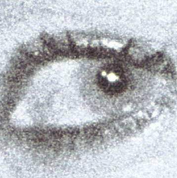

To give an idea of the development time required for the OP's proposed process, I once developed XP2 super @ EI=400 16m 24C in color developer.
The dye cloud image has very small "grain " for a 400 EI exposure.
At the scale shown, this looks very promising Alan. Is it possible to give us a enlarged crop of a larger portion of the negative of may be 10mm square enlarged to say 5x7 inches

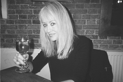

Attached the full 35 mm negative, sorry but I deleted the full size scan.

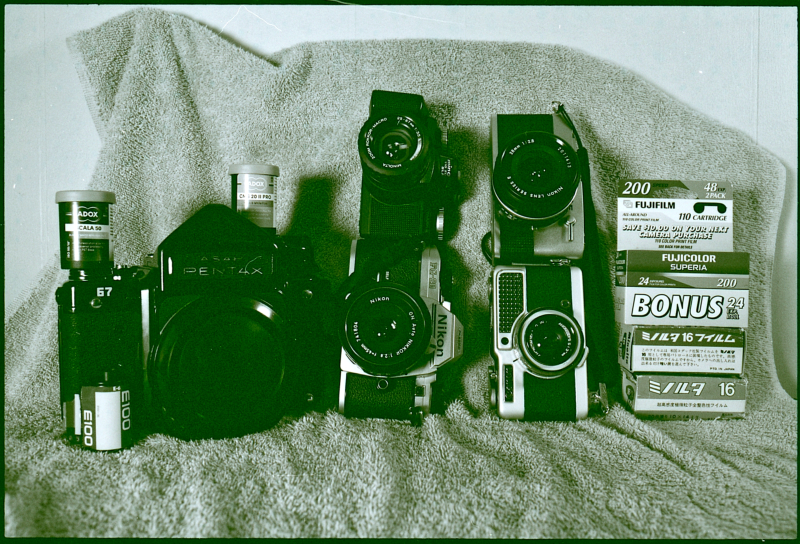

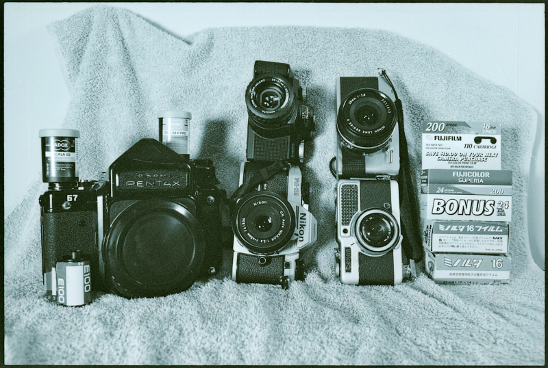

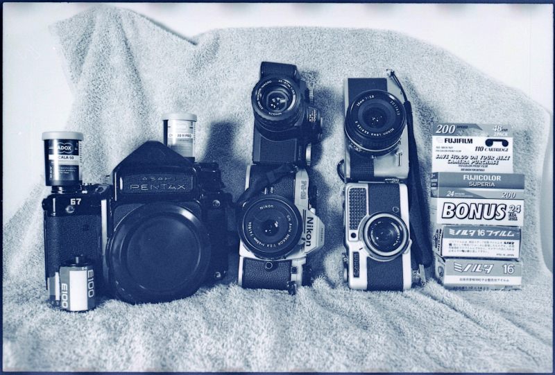

For reference, here are some XP2 frames in various color processes, all bleach-bypass. I'll bleach and rescan if anyone's interested.
Top to bottom: C-41 (lost half a frame! oops!), ECN-2, ECP-2; all standard temps, times and stop baths.
Left to right: Box speed (400), 1 over (200), 2 under (1600)
All simultaneously scanned as positive on a V800.
Some individual 1600 full-frame 'corrections' from the original bleach-bypass scan batch.
C-41, ECN-2, ECP-2. Color casts are the real deal, at least relatively. Anyone have XP2 RA-4 prints to compare?
