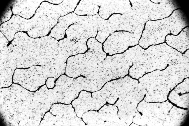

Kind of related to this, I recently collected the black gunk from the bottom of my fix and concentrated it and diluted out the fix with distilled water. I put a drop of the gunk/distilled water under a cover slip on a microscope slide to take a look at it under the microscope. It just looked like a bunch of grains scattered about, not very interesting. The next day when I went back to look at it I wasn't really expecting much but was a bit surprised at what I saw. It looks like the grains may have had some kind of ionic attractions, they formed lines and branches. Some grains just stayed spread out. You can kind of see at the end of each branch there are thicker bunches of grains, like blobs of silver are leaving trails behind them. It would be cool to try to grow crystals with it but I think that would involve dissolving it with nitric acid, not something I want to mess with.
These were photographed with a Leica IIIf using a Leitz MIKAS microscope adapter. The film is Ilford FP4+ developed in Beer.
The silver blobs were running away, "no, no, anything but the muffle furnace!"
Cool pic!
