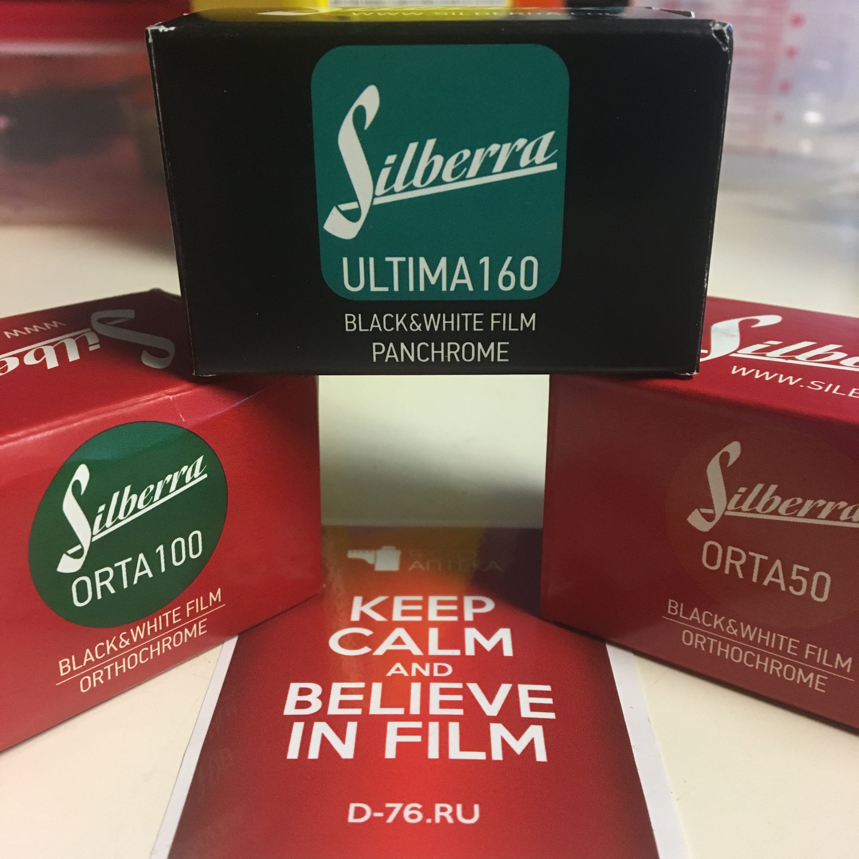

Arrived today from an online order. Very much looking to using the ortho emulsions in particular. This is very professionally packaged.

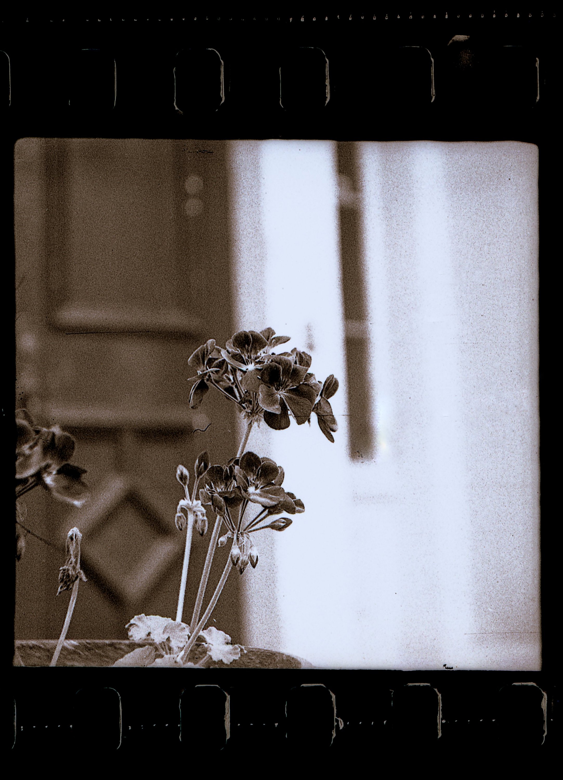

Gladly!
I only got 3 rolls thus far, and will be splitting the two rolls of Ortho mostly between a half frame Agat and an 828 Bantam RF that I use with a square frame mask to allow me to get about 4 "rolls" per source roll to get some familiarity and lessons learned.
I developed my first small sample roll in a tank and learned some lessons already...
Handle this film very gently, and use cooler temperatures to develop with less agitation than I did.
Using tray developing under safelight would have been a better idea than tanking this to avoid over-development.
Below is one of my better results from this pilot roll. The flowers and door were both painted red, and came out a bit lighter than expected, but this may partially due to my overdevelopment. Still, I am quite pleased so far at the tonal rendering and the grain pattern, and look forward to a second pass in the next few days.

I am confused. Is this a reversal of a negative and why are the colours brown? Thanks
pentaxuser
It is a scan of a negative in color bits rather than greyscale and has a selenium tone to it. I did it just before heading to work and don’t have the tools on the work PC to neutralize if I even wanted to. I was asked to share and shared what I had so far as I learn more about using this film and did.
pentaxuser

Thanks Meyer Trioplan. It is simply that those of us who are solely analogue including optical darkroom printing need to see what the neg and positive print will look like from this film. I'd assume that the negative is going to be a spectrum of black to clear and the ensuing print a spectrum of black to white including various shades of grey. However seeing largely brown always leaves me wondering if somehow a film had been produced that gives natural sepia toned prints. Yes this is a bit like someone having a sneaking feeling that maybe so someday the magician will put a handkerchief in the top hat and a real rabbit will come out :D
I appreciate your lack of time in this case but as this is the analogue section of Photrio it certainly helps if the neg and reversal is as close as possible to the real look of the neg and subsequent print .
pentaxuser

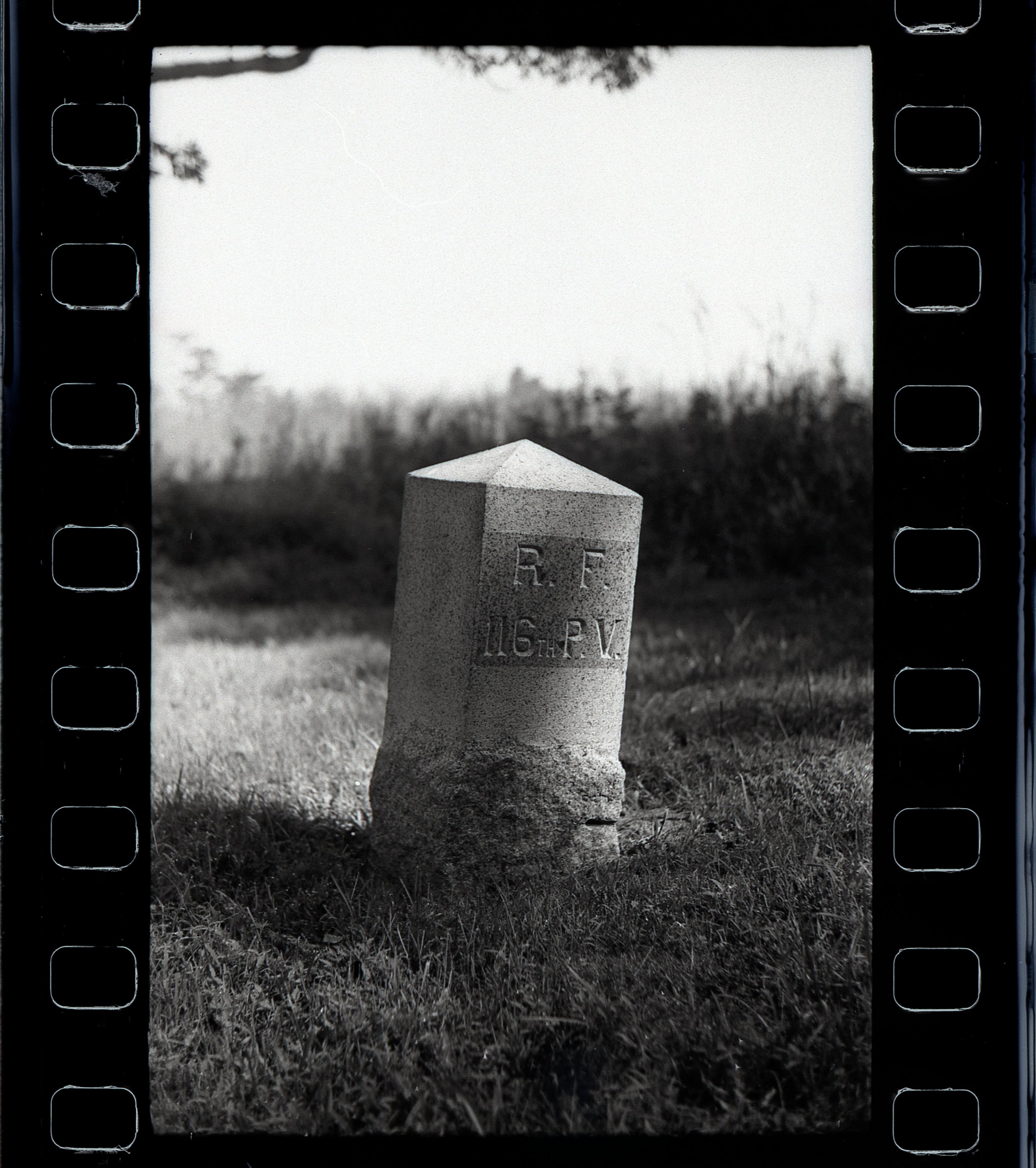

Another scan from a negative, of Silberra Orta 50 film, this time with a neutral cast, taken on a Kiev 4 with a Jupiter-8. I'm very pleased with this film so far and look forward to more being available.
