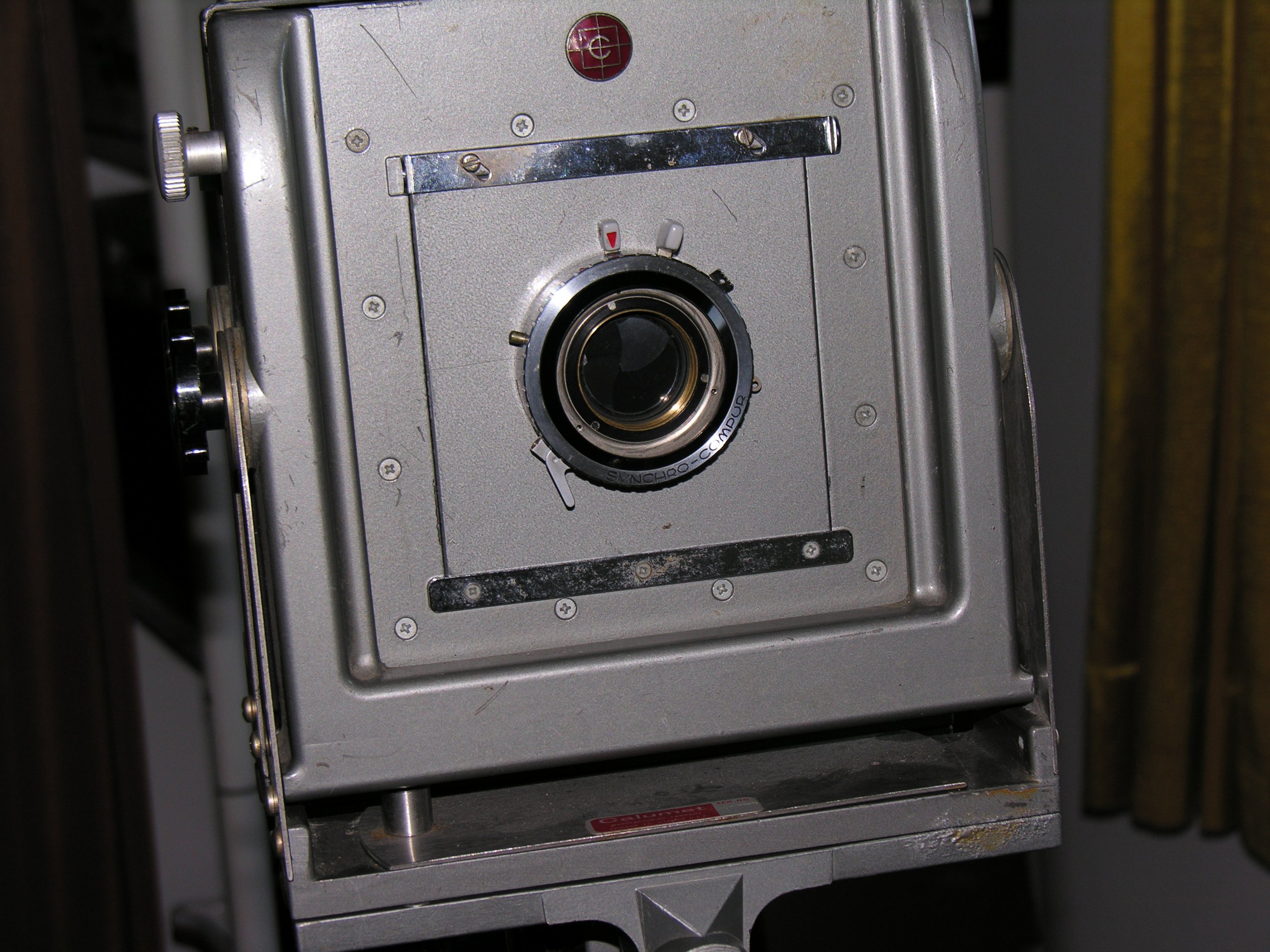

My synchro compur #0 shutter was cla'd a couple of years ago.
When returned it functioned without problems.
Now after several months of no-use the slowest speeds 1/4s to 1s are noticeably way out [ 1s = circa 5s]
I've tried multiple cocking and releases. but to no avail
I've also taken off the front and rear lens cells in case anything was 'catching' but to no change
Any comments and advice welcome

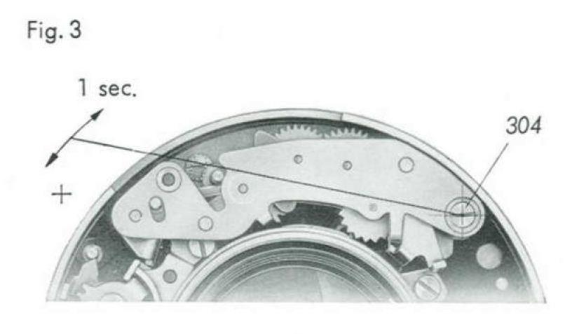

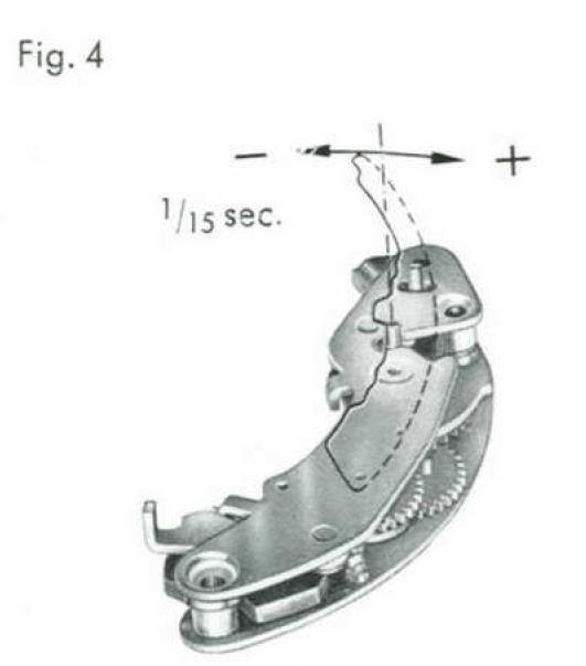

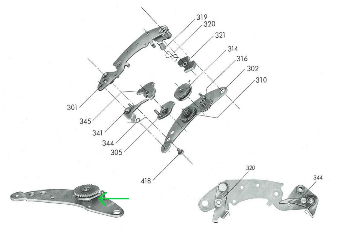

The delay timer disassembled: delay timmer 1.jpeg the coil tension spring, green arrow/314, is dependent on the other gears to hold its tension setting. A gear tooth turn in its setting will make the difference between speeds being correct or incorrect across the range of speeds.
The pallet end is moved toward or away from the center of the shutter to set the 1 second speed. Adjustment range is approximately 1/2 second.delay timer 2.jpeg
The setting end position adjusts 1/15 second speed and once the 1 second and 1/15 are adjusted correctly all other speeds should be correct.delay timer 3.jpeg
The speed ring has steps that position the delay lever at the setting end. The main cocking spring tension is the force for closing the shutter, the delay holds it open for the selected time then allows the shutter to close. If the 1 second setting end is too close to the center of the shutter it will prevent the shutter from closing.
One will not know what the problem with yours is until it is opened and checked.

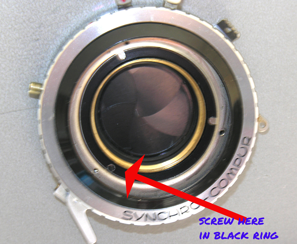

This should be a screw at the red arrow. Its tiny. Remove it, turn the black ring counterclockwise (anticlockwise) until the next slot in the black ring aligns with the next set of threads then reinstall the screw. Test the slow speeds. Repeat until the black ring has been turned no more than 180° as the speed ring and cocking lever will become too loose for proper operation and may go out of position if the black ring becomes too loose. Not having it in hand its impossible to tell if its too tight or not. There are threaded holes every 15° to 20° around the perimeter of the mating section under the black ring. As you start turning the black ring one of the other slots in the black ring will line up with a threaded hole. Mark your starting slot and screw position. Also check that the MXV lever is at the X or M position as V is delay timer and should not allow the shutter to trip/fire for 7 to 10 seconds after the release lever is operated with the shutter cocked.

Oops, wrong hole- there is a screw in the black ring. I looked at the other hole!!!
see image
