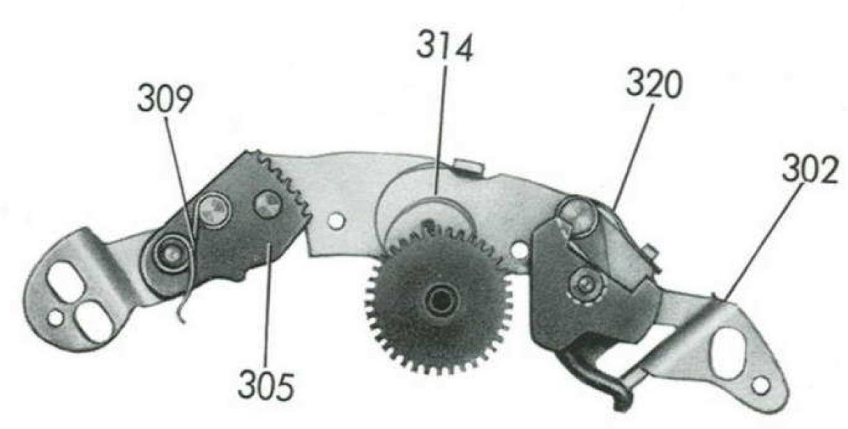

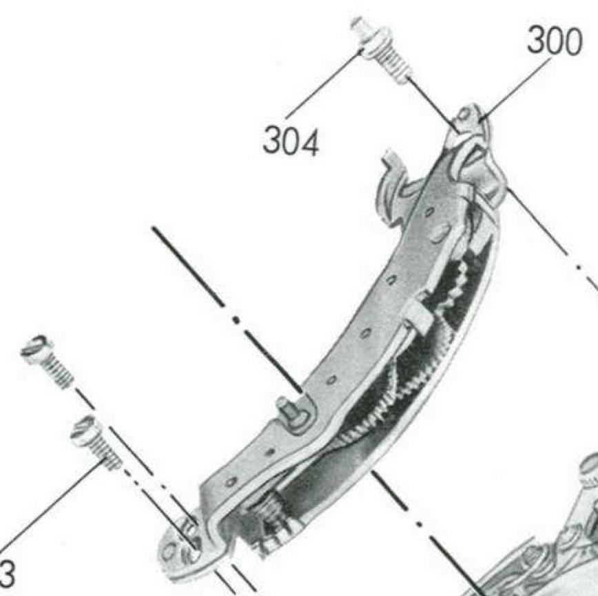

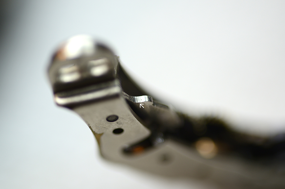

Back in post 13 I posted some screen shots of the delay timer in a CN-1110-000 shutter. The CN-1110-000 is a #00 shutter but is used for #0 shutters as the build and assembly are the same.
The Compur Service Manual can be downloaded at https://www.scribd.com/doc/44503560/Compur-Shutter-Repair-Manual

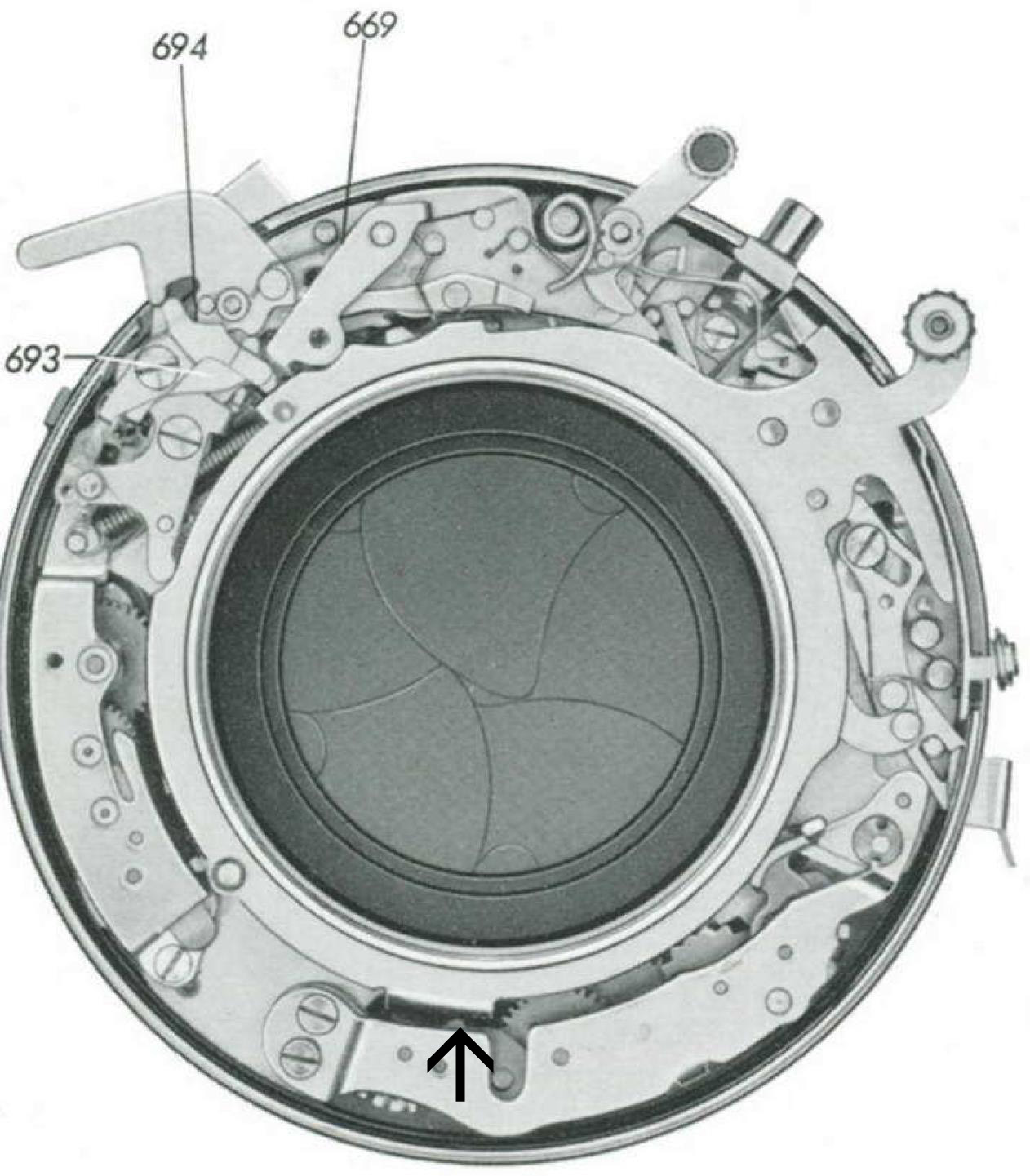

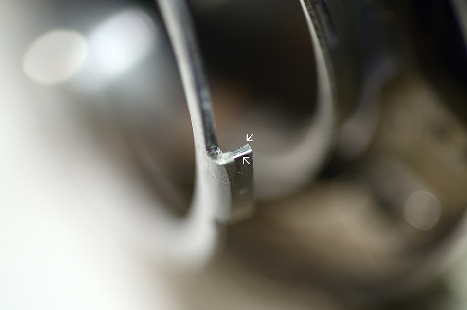

I picked up one of my Synchro Compur #1 (CN-1210-000) that would not operate on 1, 1/2, and 1/25 as well as B & T. I have had it stored for about 18 months and it picked up some light corrosion. I replaced it as I could not get it to operate to suite me.
I found that the main cocking ring (528) was hanging at the delay timer operating lever (305), ((black arrow on the manual image). Removing the delay timing assembly I discovered the notch of 305 to be rough with a shallow lip that the cocking ring 528 was catching on and the inner edge of the formed contact area of 528 (white arrow on the parts) is worn sharp on the inner edge with a hook at the bottom of the inner edge. The edges should be slightly rounded and smooth.
#1 shutter open.jpeg delay timing #1.jpeg delay timing #1a.jpeg DSC_0277_01000.jpg DSC_0279_01002.jpg
The edges at the white arrows in the pictures of the actual parts need to be polished smooth so that the spring tension will pull the cocking ring past the timing delay as it should. The cocking lever can be pushed to the closed position operating the shutter.
A shop repair tech will probably not be willing to smooth these surfaces for a customer as the bench/shop time that will have to be billed will make it too expensive.
This cocking ring to delay timer operating contact is common if not the same for Compur shutters from the Rim Set to the final production of the Synchro Compur.

Compur made in production changes that are moderate to major between their late 1940's Synchro Compur and their 1960's Synchro Compur. These changes are in the release mechanism, delay timer areas not the cocking or delay timing. My #1's problems seem to be in the press to focus area not the delay timing. I did file down the burs and wear lip with a needle file but it did not help. Taking a break from it for a while. Each shutter will need to be inspected to find what is causing its problem. I have another that runs fine with the face ring loose but will not run with the face ring tightened. The face ring is what hold the speed ring in place.

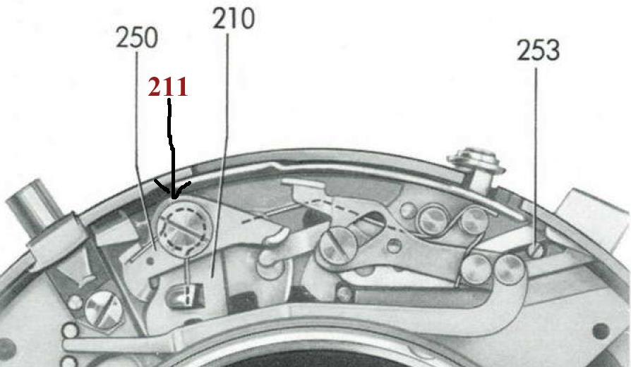

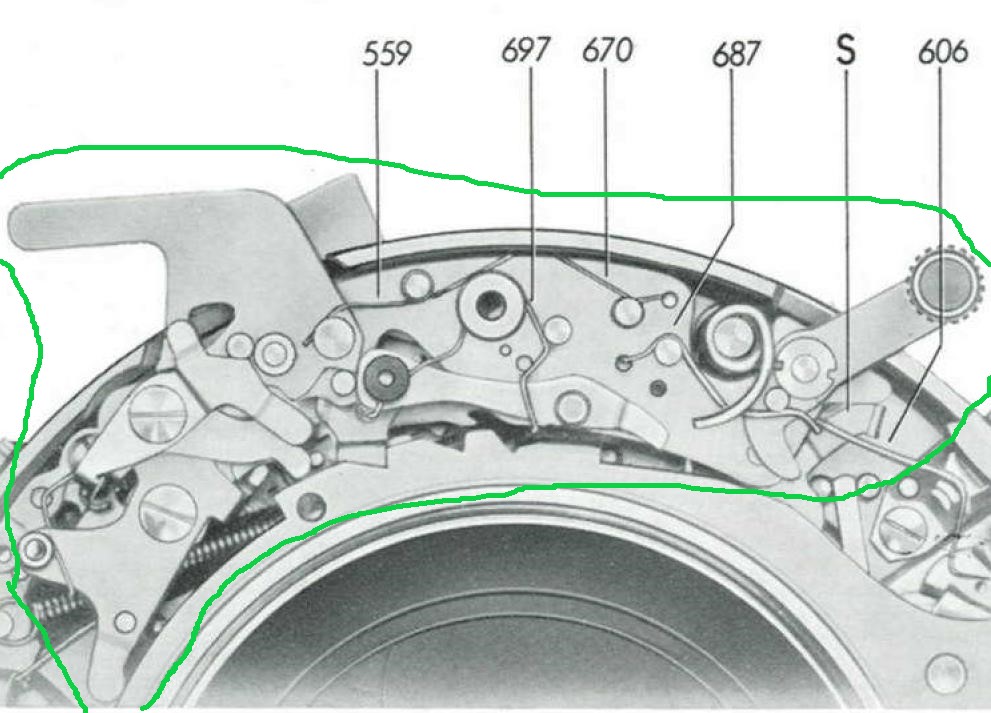

It may be a plug that is simply lifted up and out of the hole.
538 - screw or plug; 547 - the black ring, threaded internally; 540 - trim ring; 539 - speed ring; 552 - inner cover with operating notches for speeds, time, bulb. 539 & 552 lock together via a notch in 539 and lip in 552, 540 sits into grove in inner edge of 539 and is held in position by pin in the shutter mechanism engaging the hole in the outer edge of 540, 547 screws onto the center of the shutter housing and 538 holds 547's position. I've had shutters work properly on reassembly only to need 547 loosened a hole or two a few days later.
What page/illustration/table is this illustration [your listing #23] shown this in the shutter manual - I cannot find it.
regards
Tony
shutterfinger
Feb 25, 2013
5,018
San Jose, Ca.
Shouldn't this be 1210-051 for Synchro Compur #1 shutter with MXV?
No, I simply remembered it wrong. CN-1307-000 is an exact match.
CN-1110-000 pdf page 50.
