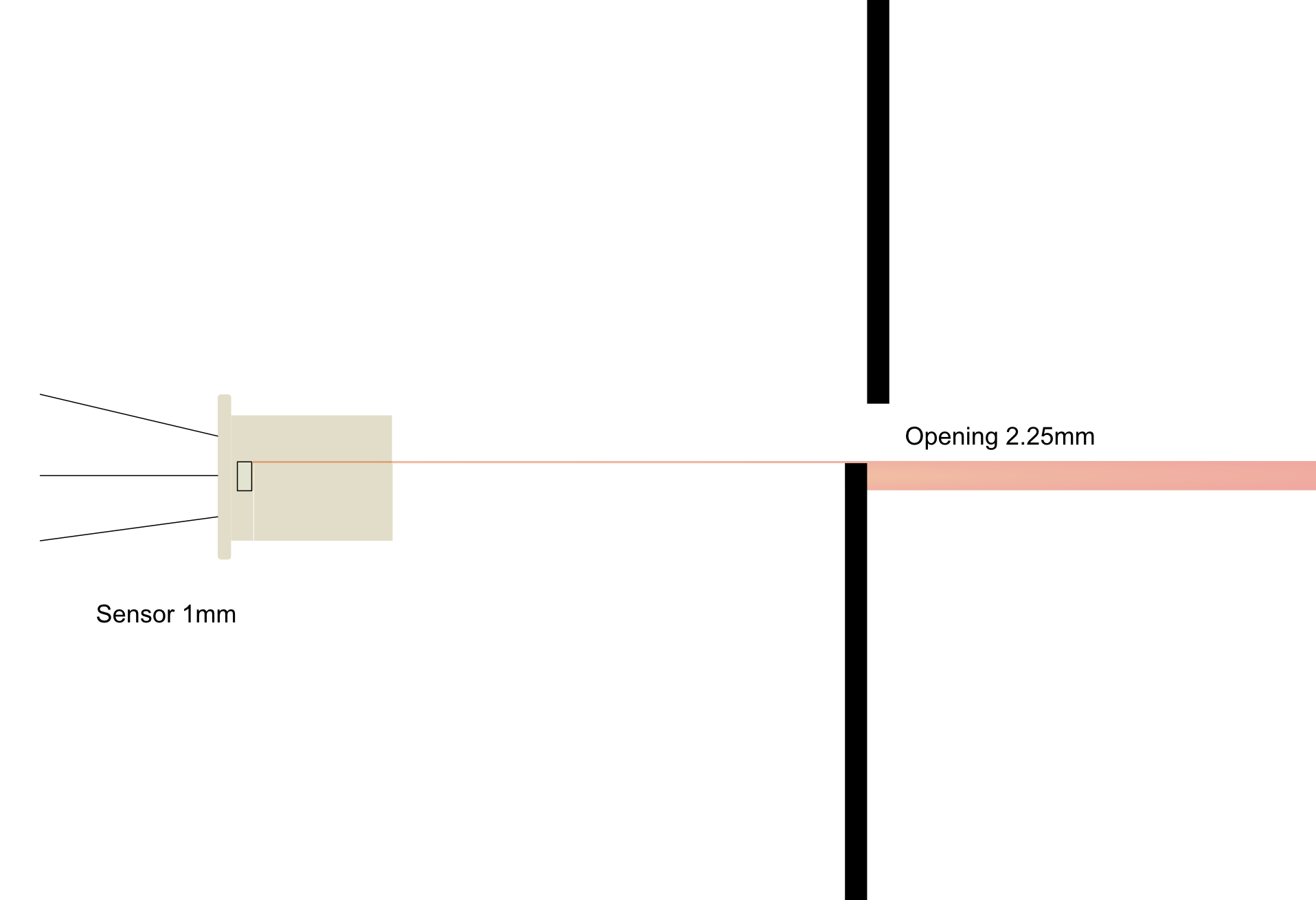

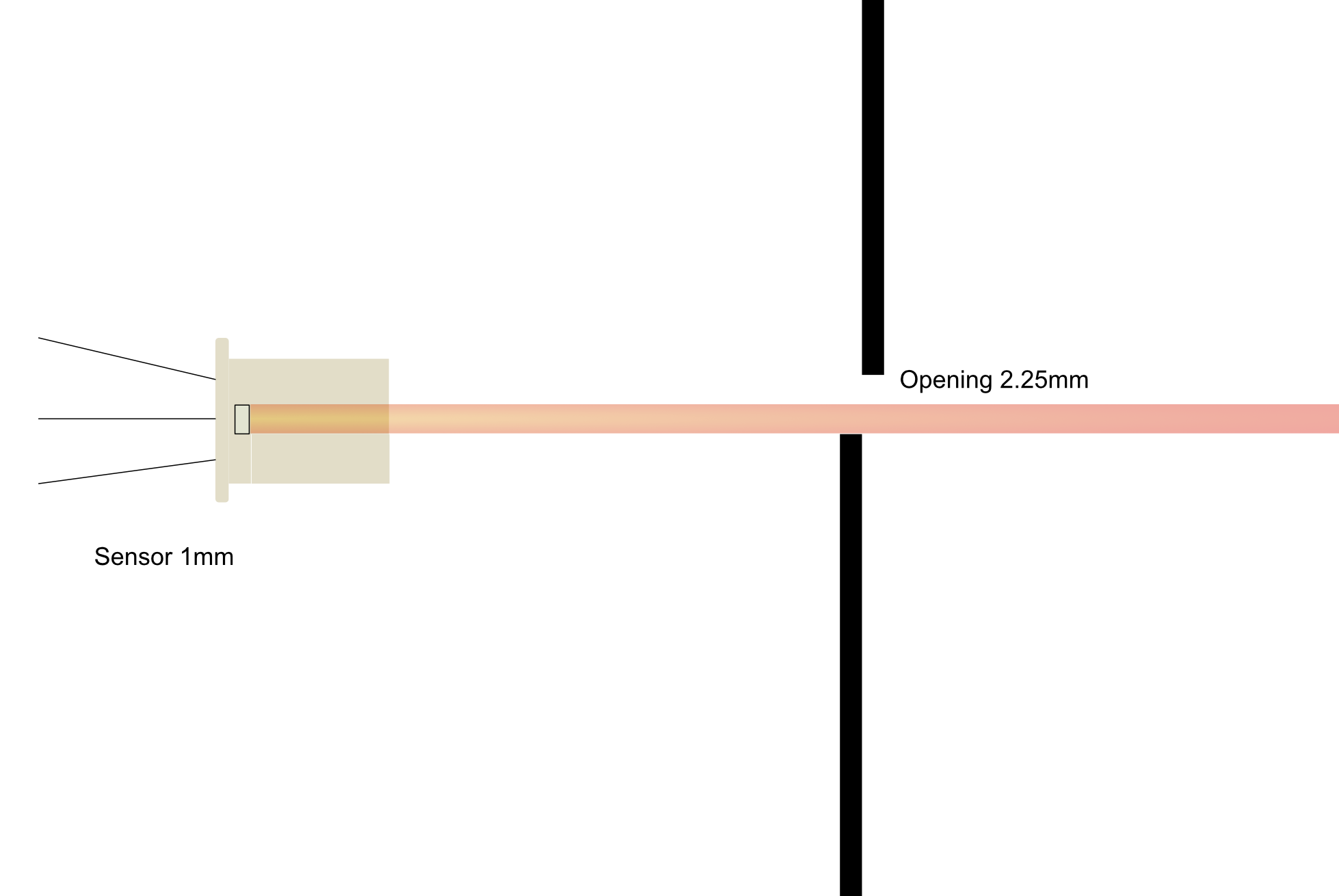

On to the problem of measuring a single point. Since no sensor is that small, one has to correct for the size of the sensor. The wider the sensor, and the farther from the shutter curtains, the larger the error. In fact if the slit width is less than the size of the sensor, the sensor only records its own width, irrespective of the shutter slit width.
In my setup I use a laser to establish a collimated light path. This allows the shutter to be placed anywhere in the beam ( the shutter does not need to be next to the sensor).
Next I choose a phototransistor with a tiny 1mm sensor.
ic-racer
ic-racer
Feb 25, 2007
16,693
USA
The math to compensate for the sensor size is simple because the time the sensor 'sees' light is related to the addition of slit width to sensor width.
For example if the slit width is 4mm and the sensor is 4mm, the time the sensor sees light is exactly twice as long as a single point would measure.
So, at 1/125, a point sensor would measure 8.0 milliseconds. With a 1mm sensor, the corrected measurement would be 8.4 milliseconds.
At 1/124, the 1mm sensor should read 8.4 milliseconds because the slit width is 18mm + 1mm sensor width = 19mm. The correction factor is 1.056 (19/18) * 8 milliseconds.
The correction factor gets more significant as the slit size diminishes.
At 1/250 the 1mm sensor would read 4.4 milliseconds because the slit width is 9mm + 1mm sensor width = 10mm. The correction factor is 1.11 etc.
1/500 would read 2.4 milliseconds.
1/1000 would read 1.4 milliseconds (rather than 1 millisecond). That is one half stop difference.

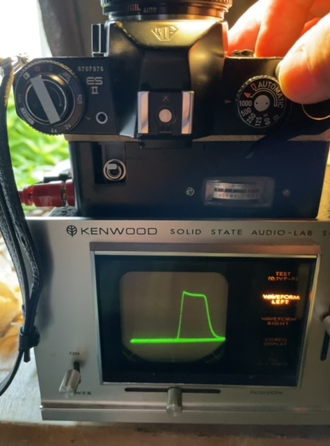

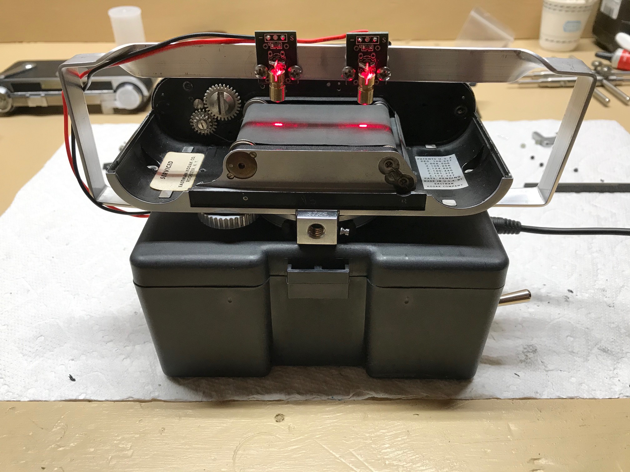

I built this shutter tester for working on Ektra bodies. Lasers are used for as close to a point light source as possible and positioned near each side of the curtain aperture.
Phototransistors with short switching times are used for sensors, they are installed inside the black box to shield them from light and small apertures were poked in the plastic housing using a hot needle, allowing a small effective aperture of approximately 0.010" which reduces the effective sensor size, as does positioning the sensor further from the aperture.
Correction factor at 1/1000 is about 1.3, and I consider within 1/3 stop to be good enough for my older mechanical cameras, so this was acceptable to me. Trying smaller diameter apertures did not reliably trigger the phototransistors.
Slight difficulty was encountered, as for the Ektra in particular correction factor needs to be calculated differently for each sensor, since the curtain gap does not remain constant across the film plane. At the start of 1/1000, it's about 1.3, but by the end it is closer to 1.08.
This type of tester is best connected to a 2 channel oscilloscope for measurement.

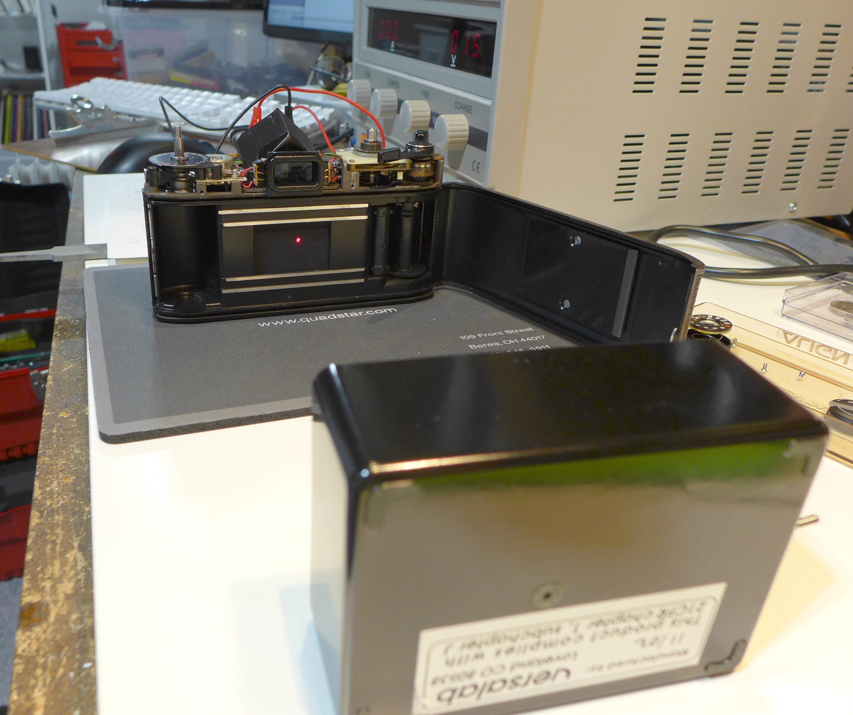

Sometimes one sets x-sync a fraction of sec (0.4 millisecond) after the first curtain passes the threshold on the far side. Problem is then the second curtain will travel somewhat past the 2.25mm slit when the flash fires at the closing side. One can, however, say that if the gap at 1/1000 with flash is GREATER than 2.25mm, the slit is too big.
Some cameras (like early Pentax) you can set the X-synch by a continuity tester on the contacts as one slowly cocks the shutter and starts bringing the first curtain over. But it is still hard to get it to fire just as the first curtain crosses the threshold because the second curtain edge is obscuring the first curtain from view as one is trying to set it.
In terms of sensor, I still have to post the images, but I used a laser to shine on a phototransistor with a 1mm sensor. This was done in room light, no black box, slit or additional hole needed as the laser beam should be perfectly collimated with negligible diffraction from the shutter curtain edge.

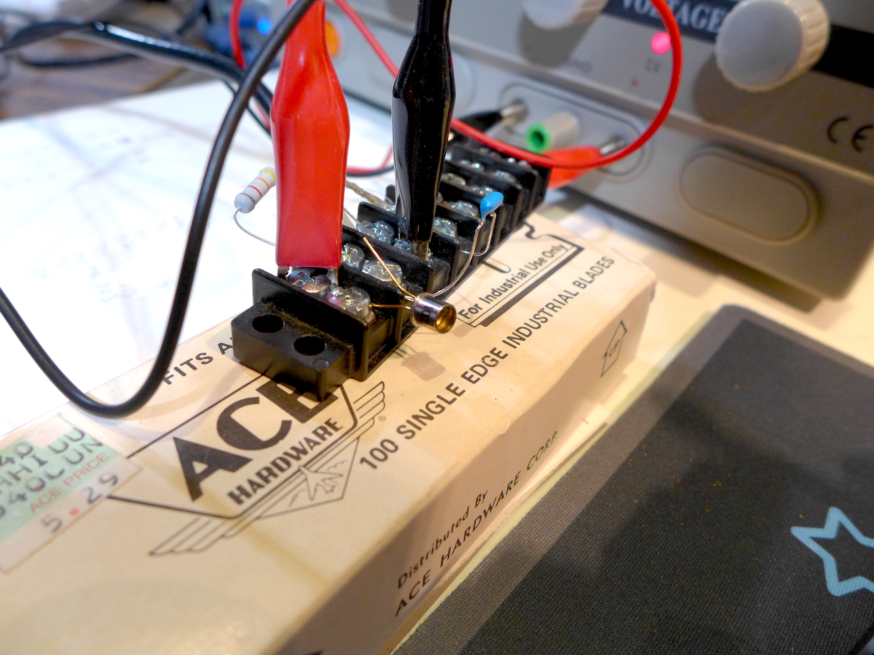

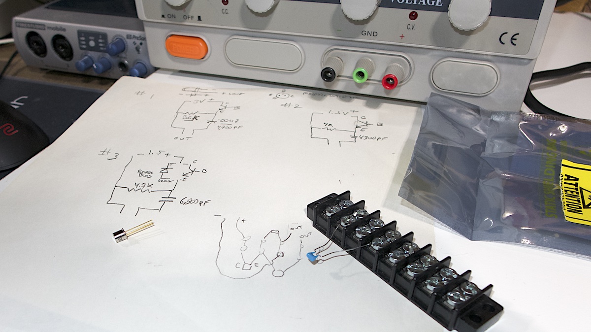

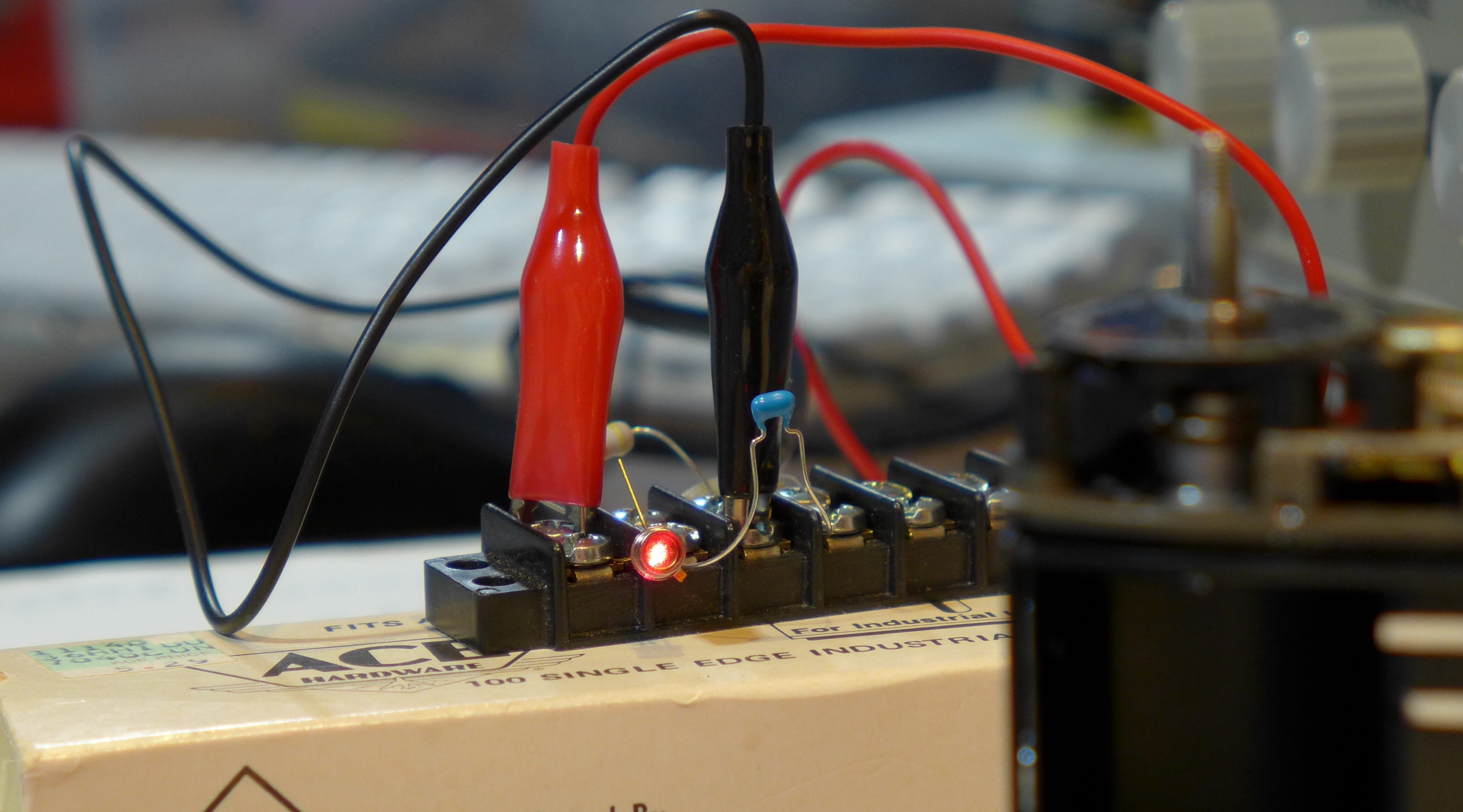

A side remark, I made a simple light sensor from a phototransistor and a resistor (like the commercially available inexpensive "Photoplug"), to plug into my phone's audio input and measure shutter speeds, using the Shutterspeed app. This is just measuring a single open time and not curtain timings, because it only uses one sensor; a clever person could figure out a way to combine the signals from two such sensors into one audio input.
Anyway, I was shining a bright LED bike light into the camera, and I found that the LED, phototransistor, and audio input are fast enough to pick up the high frequency oscillation of the pulse-width power modulation of the LED, which the light uses to enable multiple brightness settings. The modulation frequency was about 4000 Hz. 4000 Hz is of course not noticeable as flicker to the human eye due to persistence of vision.
So just a remark that in order to time very fast shutter speeds, one also needs to understand the time constants of the light source and detector/measurement apparatus.
What is the manufacturer and model-number of that phototransistor? What resistance did you use?
I ask because I made a fool of myself yesterday by inadvertently using a very slow phototransistor when attempting to capture PWM at only 256 Hz.
It is just a super-cheap phototransistor from Tayda Electronics, Taiwan Oasis part no TOPS-050TB2. https://www.taydaelectronics.com/tops-050-photo-transistor-900nm-5mm-radial-tops-050tb2.html This is a 5mm package, they also have a 3mm. However, they only have black plastic encapsulated IR-sensitive phototransistors. A clear visible-sensitive one would be better for a shutter speed tester. I can get the IR transistors to respond by shining a bright light at it, or using sunlight (an IR LED would also work, I assume).
I used at 4.7K resistor across the emitter and collector of the phototransistor, wired to the ground and "mic" connections of a 4-connector 3.5mm audio plug as shown here: http://www.artdecocameras.com/resources/shutterspeed/ The exact value of the resistor should not be very critical.
The PT datasheet gives a rise/fall time of 5 microsec. I'm kind of surprised that you had a phototransistor that couldn't respond at 256 Hz! Perhaps it's the light sensitive element, as I can't imagine anything in silicon that is that slow.

I only assembled this tester to test three Rolleiflex SL35 cameras I was working on. Of note, almost all my cameras have modern vertical shutters. I don't have any old Nikons or old Leicas. So these three Rolleiflex cameras were the first cloth shutters I had to repair. I was actually fascinated with the workings of the cloth focal plane shutter, part of the reason to get the cameras.
I tested three different sensors and found this the be the best of them: Vishay BPW76

USA
Even though the sensor is tiny (1mm) it still turns on too soon and stays on too long. However, mathematically it can be accounted for because the effective slit width is the actual slit width (2.25mm) plus the sensor width (1mm).
