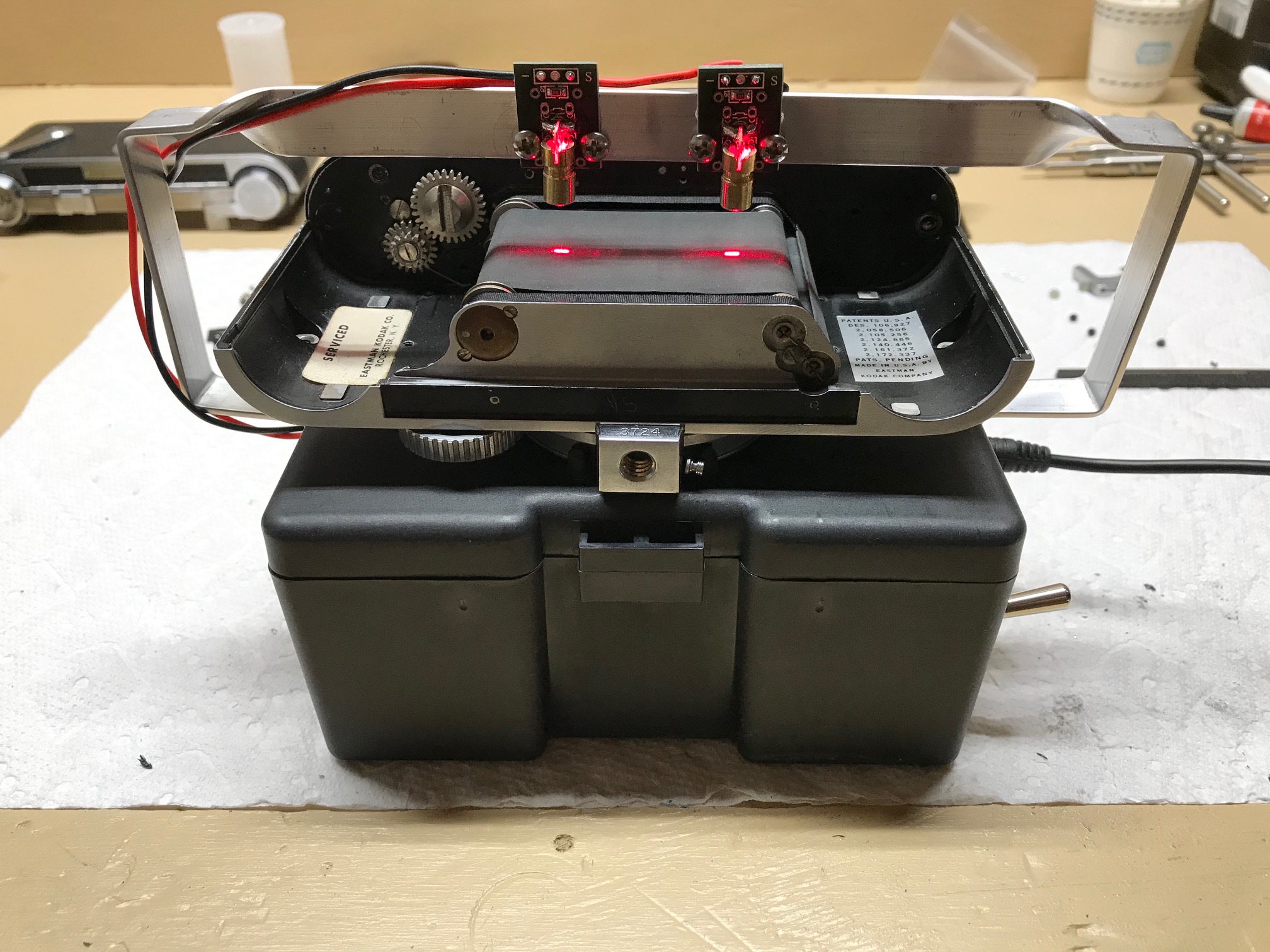

I built this shutter tester for working on Ektra bodies. Lasers are used for as close to a point light source as possible and positioned near each side of the curtain aperture.
Phototransistors with short switching times are used for sensors, they are installed inside the black box to shield them from light and small apertures were poked in the plastic housing using a hot needle, allowing a small effective aperture of approximately 0.010" which reduces the effective sensor size, as does positioning the sensor further from the aperture.
Correction factor at 1/1000 is about 1.3, and I consider within 1/3 stop to be good enough for my older mechanical cameras, so this was acceptable to me. Trying smaller diameter apertures did not reliably trigger the phototransistors.
Slight difficulty was encountered, as for the Ektra in particular correction factor needs to be calculated differently for each sensor, since the curtain gap does not remain constant across the film plane. At the start of 1/1000, it's about 1.3, but by the end it is closer to 1.08.
This type of tester is best connected to a 2 channel oscilloscope for measurement.
