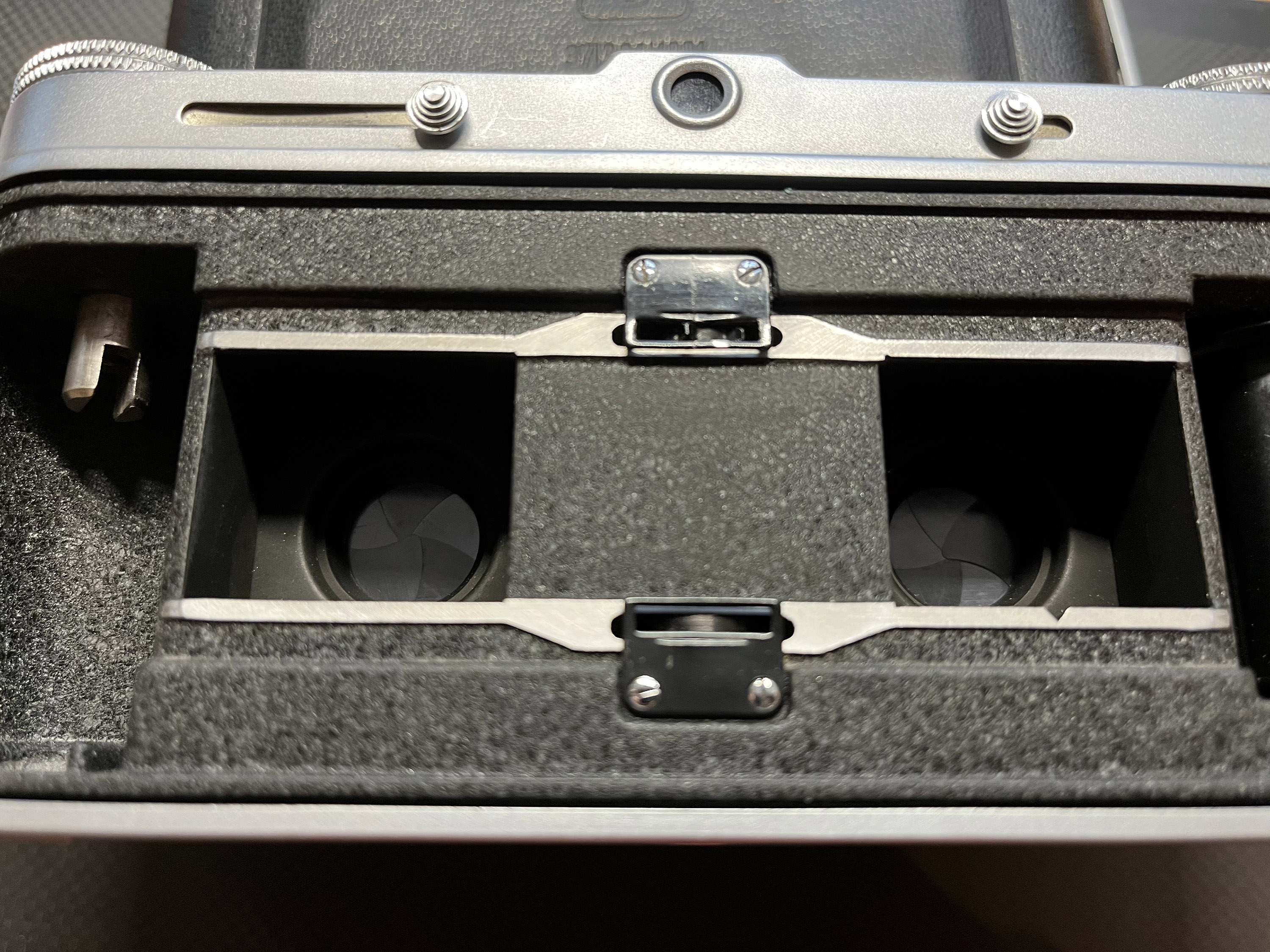

Hi everyone,
I recently bought a Belplasca camera from eastern Germany from around 1955. Everything works fine except for one problem:
The shutter releases principally as it is supposed to, but no matter where I set the shutter speed, I will always end up with a really fast speed (I guess the fastest) except for when I set it on B. If set on B, it does what it should.
I really love this camera and would like to get it back to work properly, especially because all the rest is in perfect condition.
Does anyone have any idea what could be the problem?
Has anybody else had this problem on a belplasca or any other camera from that time?
A guy called 3DJack has supplied some very good repair info on other problems with the Belplasca. I hope he is gonna read my post and has any idea. Unfortunately I myself cant write him directly right now due to restrictions in this forum and me being new here.
Thank you so much!

With leaf shutters, what you describe usually means that the escapement is gummed up and so will not move to the various positions that make for different speeds. You'll need to clean the escapement(s?). As to how to go about this, I don't know. Maybe post a few photos of the camera lenses and shutters?
In the meantime, go ahead and reply to this post. And do that a few more times. Eventually you'll hit the magic number to be able to send a message to someone- five is typical? So post away!

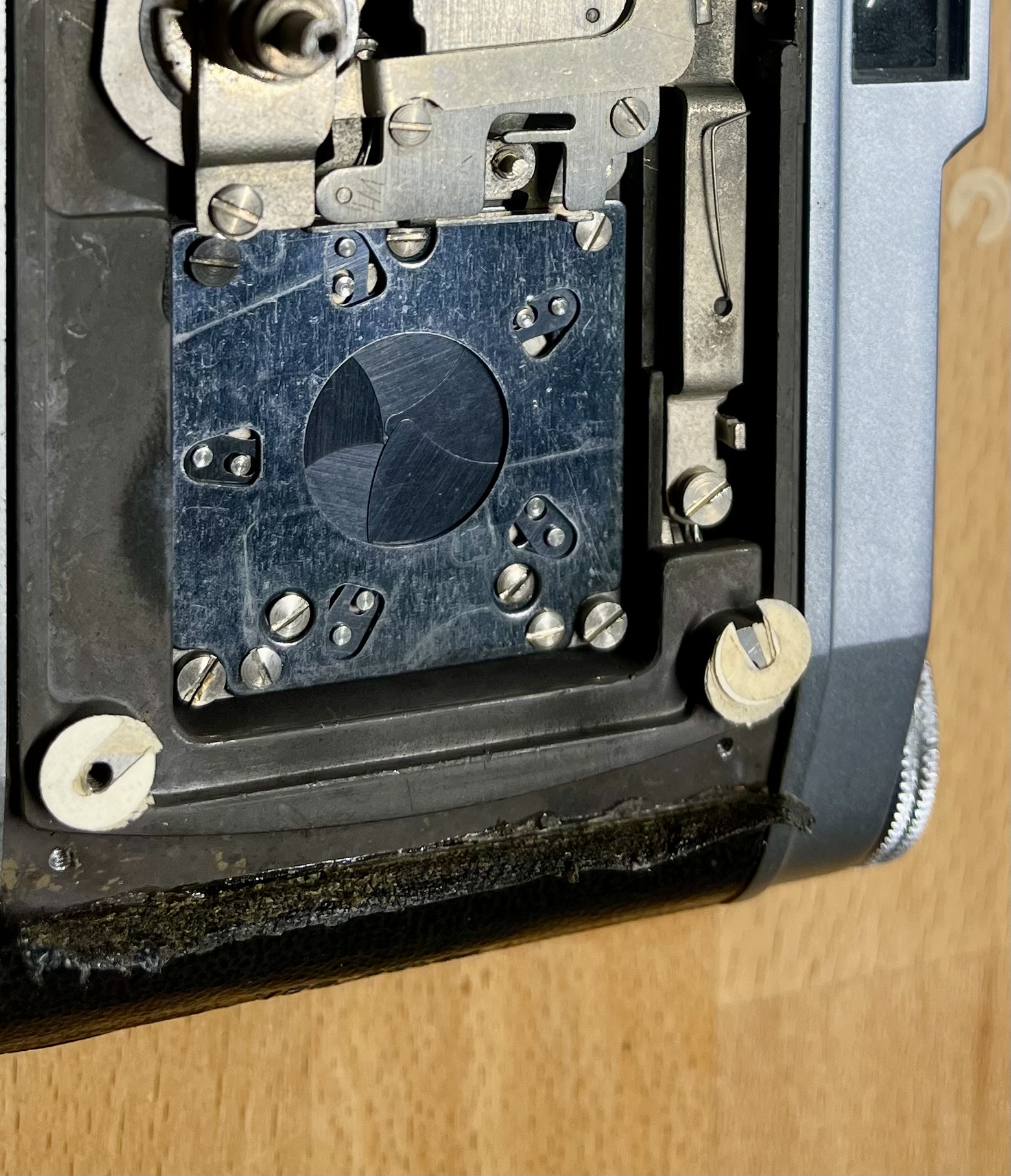

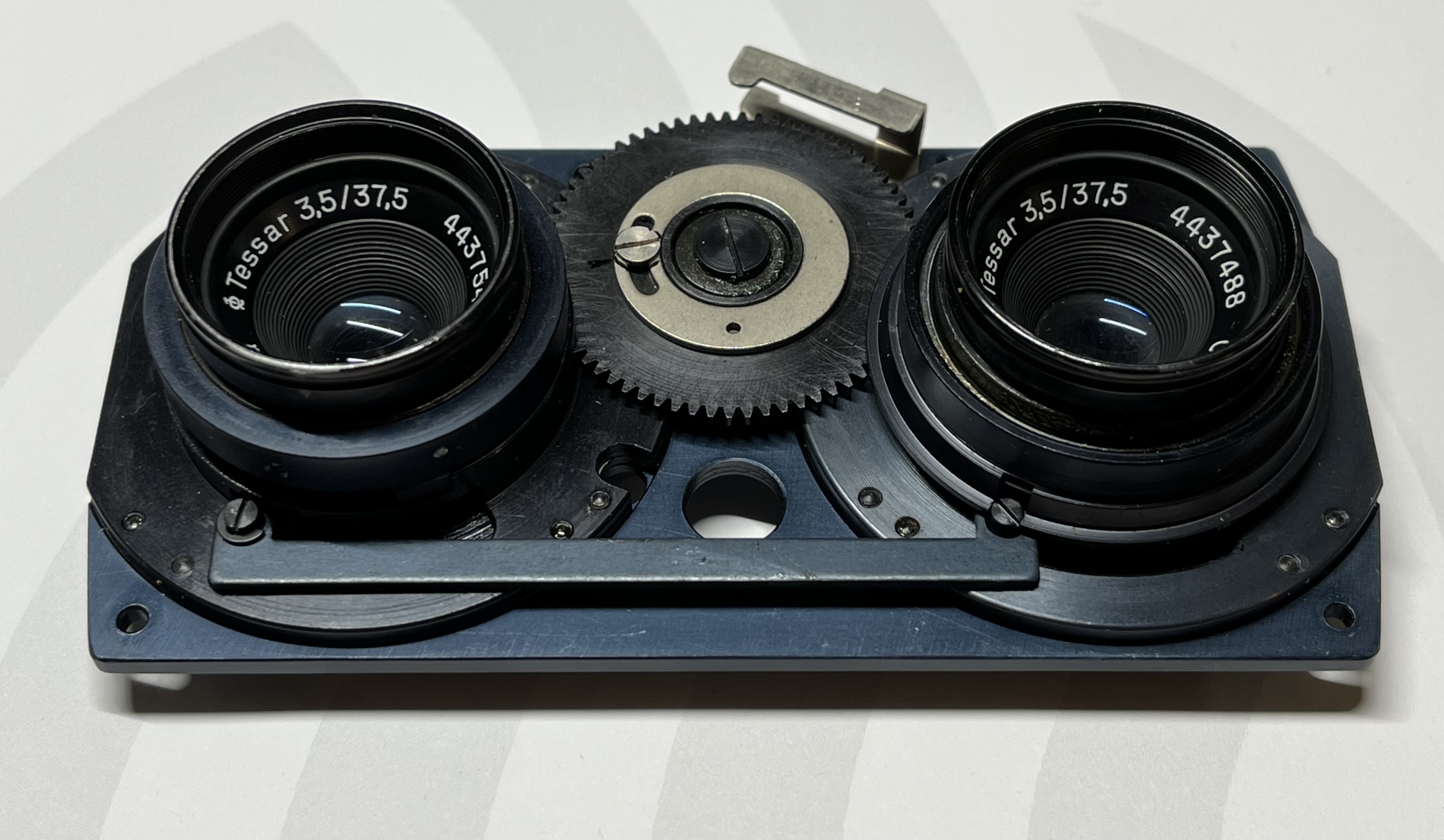

I opened the Belplasca today and apart from the leatherette (removing it I guess always sucks) it was a pleasure to work on it. Everyting is perfectly self-contained! There was not a single part jumping out or anything like that and as far as I can see right now nothing got out of adjustment.
The lens unit with all the sync for the two lenses is one solid construct you can remove as a whole.
Theres one thing to be cautious of!!
! The lens unit is adjusted for beeing parallel to the film in a weird way. It was achieved by stacking varying numbers of paper discs below. They easily fall of and you have to note the exact number and store them for each screw separately in order to get everything parallel in the end again!
It seems like nobody takes notice or care of them so I cant say how important they are. Dont ask me how the heck the Belca staff originally adjusted it and why with paperšŸ˜‘

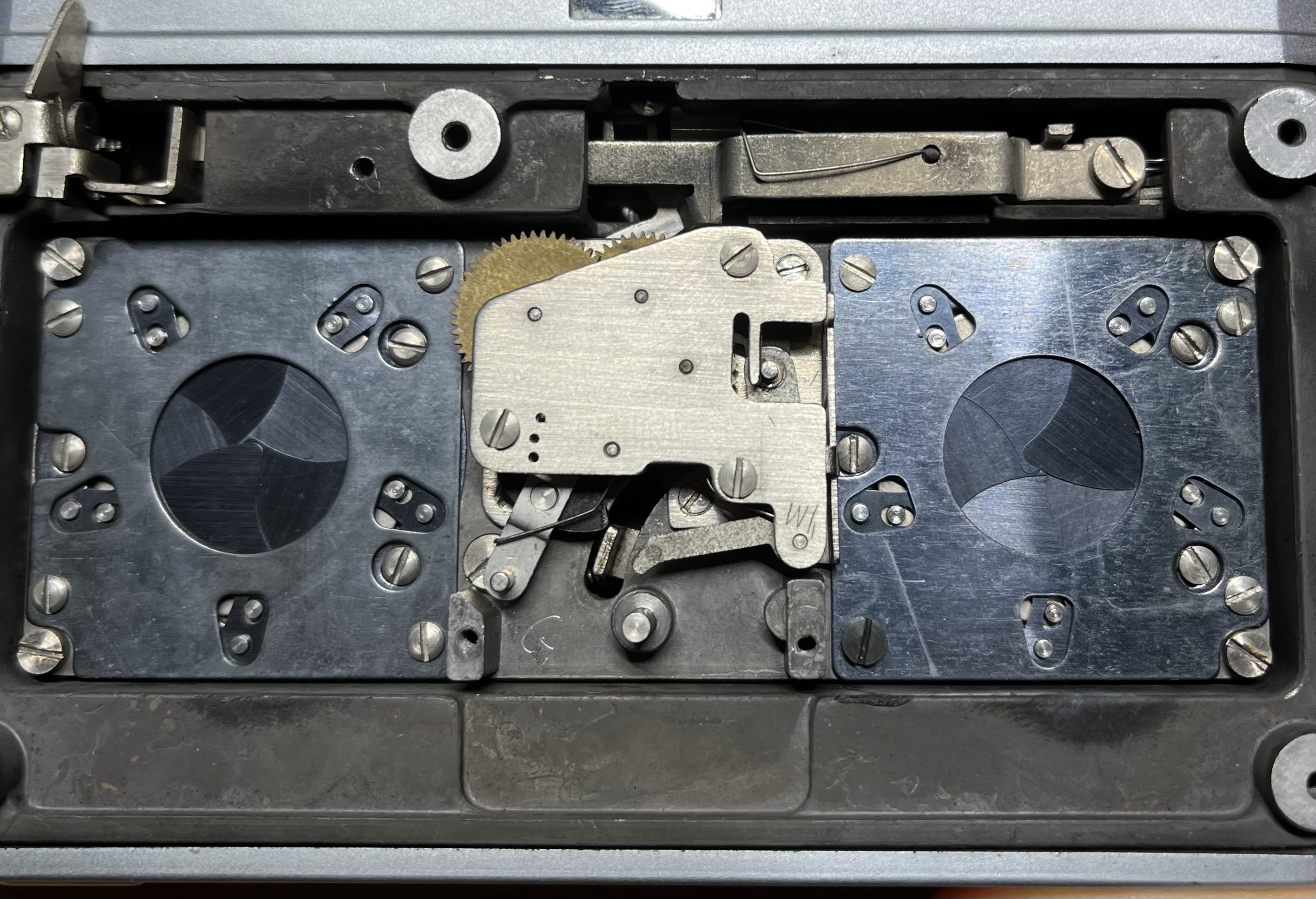

Anyways I had a look at the shutter and what should I say it seems to function properly after moving the parts carefully a bit. Now it does 1s almost perfectly!!
Guys I think your theory was perfectly right! It seems like everything was a bit sticking together in a way that the escapement didnt came to action.
It still seems to stick somewhat. So my plan is to put the shutter mechanism into cleaners benzine, if I an able to separate it from the leaf shutters. The leaf shutters are working perfectly and are clean so I would like to keep them as they are.
I plan to oil the bearings with oil for small watches (oil 1-3 Dr. Tillwich).
The lens unit with the sync for focus, aperture and with the mechanism for parallax correction in the viewfinder

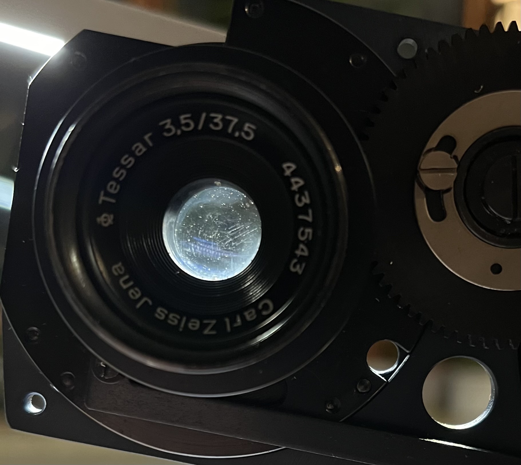

This is nasty! I found some scratches inside the lenses! For fucks sake who scratched them so much! Its between the front and rear lens but the objective doesnt seem to have been opened before. I guess it wont affect image quality too much but maybe thats wishful thinking😬
Really nice that the slow speed escapement is not encapsulated and you can treat it easily!
Don't worry too much about the scratches; the flashlight test for most lenses makes you want to curl up in the fetal position, but I'll bet the impact will be little to none.

Nice to hear that. But I still have absolutely no idea how somebody scratched this so badly
You should see a Rolleiflex 3.5f I found in a thrift store. The lens looks like it was literally rubbed with sand paper. It's a shelf queen; strictly for display.
The escapement is in benzine now and everything seems to work perfectly.
I cleaned the viewfinder today which was very hazy and the rear lenses of the objectives.
I am unable to open the front of the objectives so far, in order to clean the front lens elements from the inside where there is some fungus and haze.
If somebody has tips for that i would be really happy. Tried it hard today!
