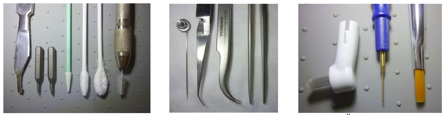

So far I have repaired Minox A, Mamiya super 16 and Edixa 16 cameras. That's why I use these tools:View attachment 358873
The tool on the far left is a homemade tool made from a scalpel.
Then of course I have consumables for cleaning and lubricating.
- Mineral spirits for cleaning the internal parts and removing resin from the escapement
- Isopropanol for cleaning glass surfaces
- Acetone for degreasing the shutter blades
- NYOIL sealing oil for the bearing points of the gears and levers.
- GunCer weapon grease (Ballistol) for slow-running sliding pairs with emergency running properties, e.g. B. Lever and housing parts. Because of its very good adhesion, even at high temperatures, it is also suitable for use near lenses and shutters, as the risk of migration into grease-free zones is low.

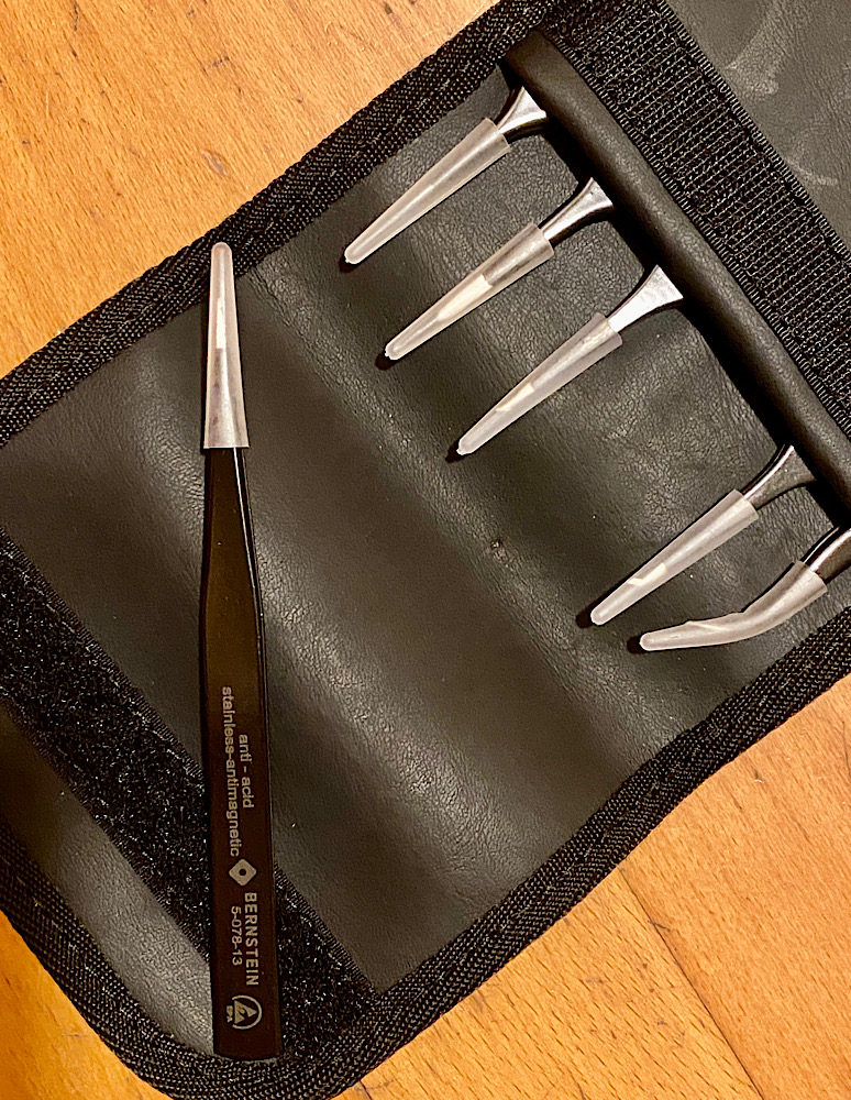

Came in the mail today - the most expensive pair of tweezers of my life.

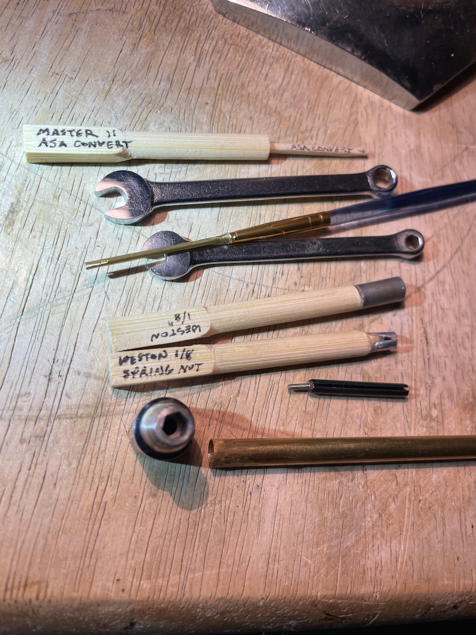

For the Weston meters.
ASA convert: guides me to cut (with an X-Acto knife) a small piece of pie the width of 1/3 stop from the exposure index window. I slide the wedge over and epoxy to a thin brass shim underneath. That makes the 1/3 stop difference between 80 and 100.
Typical wrenches.
Spring balance adjusting tube. Game changer. The balance is so easy with the tool. Start by zeroing with meter horizontal. Then hold meter vertical and if the needle is below zero, loosen the right-hand balance (to make it heavier). Then hold horizontal and balance by adjusting the left-hand balance. It’s so intuitive. With a little back and forth you can make it zero on three axes.
The weston V needs a flush socket so I just ground one down. They often glue those nuts so a drop of acetone helps.
Typical wrenches.
Not used for the first time as can be seen 👍

I just got a pair of cheap ones and the first thing I encountered was a magnet.
Tell me more about that pair.
I hate it when the tiny part that I've pushed into place with the tweezers gets stuck to the tweezers when I open it and pull it away. So my tweezers have to be antimagnetic.
But I love it when my screwdrivers are magnetic. Then I insert the tiny screws into the hole using the screwdriver.

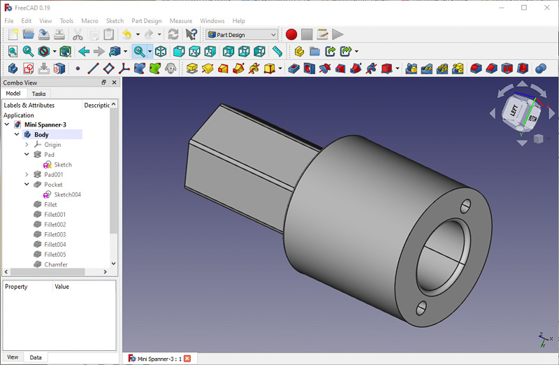

How's about a virtual mini spanner? Designed to fit a ratcheting screwdriver. I resize the working end as needed, print with ordinary PLA fiber, and for the pins, I use piano wire. Because the part is so small, an entry-level 3D printer works fine, and print times are short.
