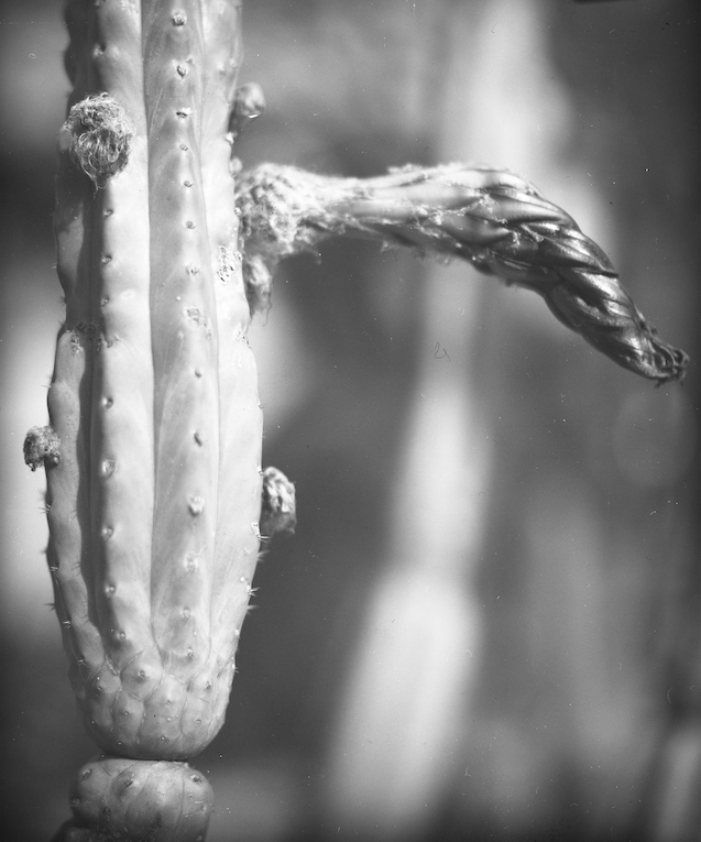

Here's some 4x5 Tri-X 320 that expired in 1982-ish (oh no!), rated at 40 or so, and developed in Caffenol (not that!) Delta formulation. When I have time I'll do a little dust removal; there's no processing at all on the 2400dpi negative scan this lo-res (420K!) copy is taken from. It's not perfect but the expired film doesn't hold it back-- probably the Caffenol does :smile: . Now that my kids are older I could probably use more toxic developers, but since I develop in the kitchen it's still probably a bad idea...
