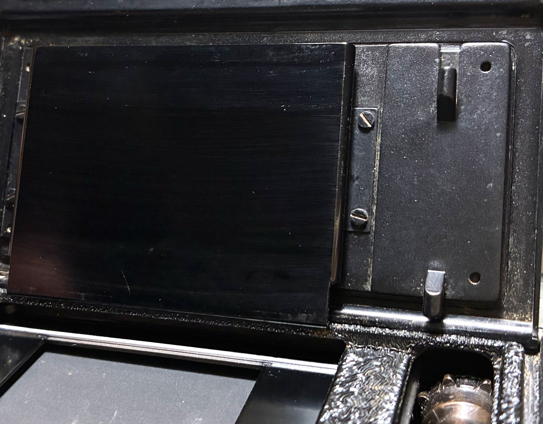

Last night I was changing rolls and I noticed my pressure plate is developing a slight impression of a film negative. I am not sure how long it has been there. It was not always there. That much is certain.
I assume that wouldn’t ever get deep enough to make a noticeable impact on film flatness, right?

I just checked and it is not dirt. It is hard to show on camera, though.
I believe the baseplate is going to end up with the same wear pattern Don showed in his link. The black is wearing down where the sprocket holes travel and the baseplate has matching scratches lengthwise (that cannot be felt).
Since you all say it will not harm my negatives I have no concerns. Thank you.
