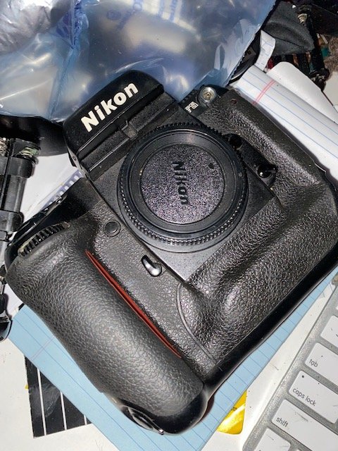

Should I buy an F5?

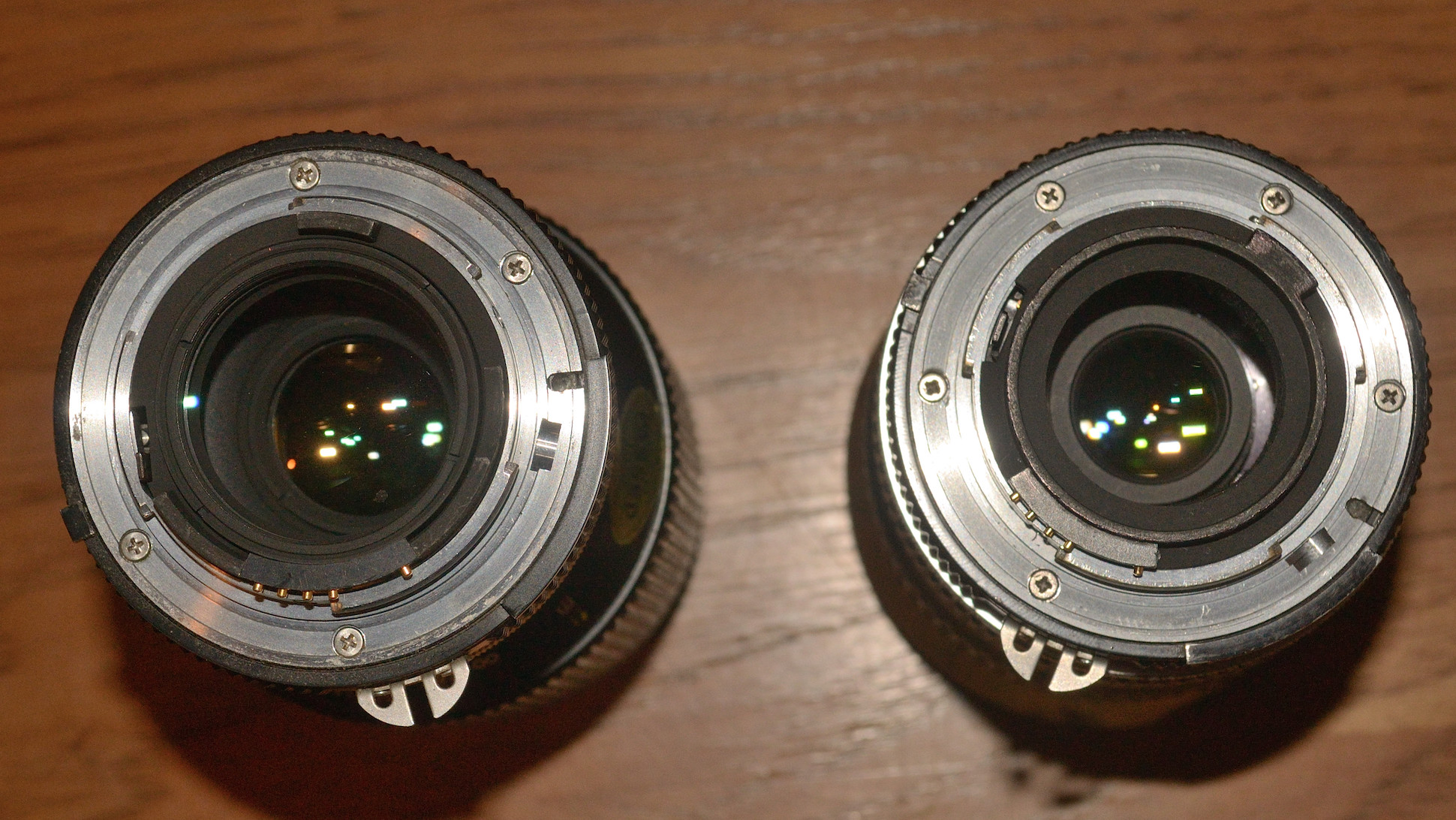

Easily fixed. My 50-135 f3.5 Ais and 25-50 f4 Ais. Both "chipped" for use with electronics.Still usable on my FM2n and F.
I wouldn't say that is an easy fix. You had to convert the mounts and spend money that most probably was more than the lenses are worth..
F6 works with anything, no conversion needed.
Nah. $30 and some of my time. And then there's the price difference between the F5 and F6. Even if I paid someone to do it that would pay for a few lenses at the least.
Would you post a tutorial?
Here is where I figured out how to do it. And here is where I get them.
Some lenses are difficult and require machine work. Others are just glue and program. I'm a machinist with a friend who owns a machine shop.
Programming (which I use a D90 for) took a few tries to figure out. A drawback is EXIF with zooms. The chip's program will only allow one number for EXIF data. So I choose an oddball number. Like my 50-135 f3/5 is a 110 for EXIF purposes. That only matters with digital cameras. So when I shoot digital the EXIF will tell me the frame was made with a 110 lens at 110 focal length.
