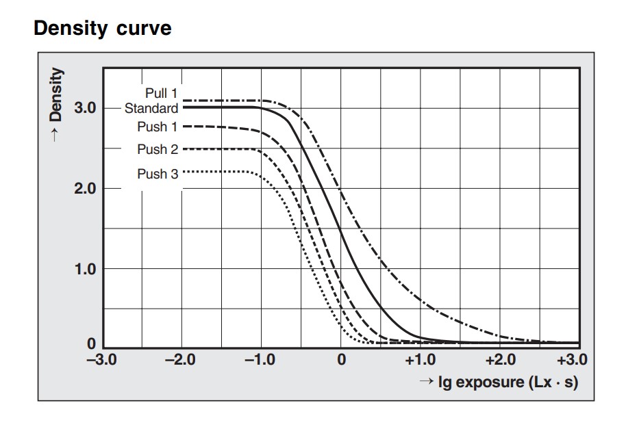

Kentmere 400 pushed 2 stops reversed to positives
As Ian said, there's your problem. If you look at the attached curve family for Scala 200x, you can see what happens to Dmax as you push further. The Scala process, as far as I can tell, uses a development accelerator to access the silver and has very low solvency in the FD.
What are you using for the first developer, reversal step and redevelopment step?
