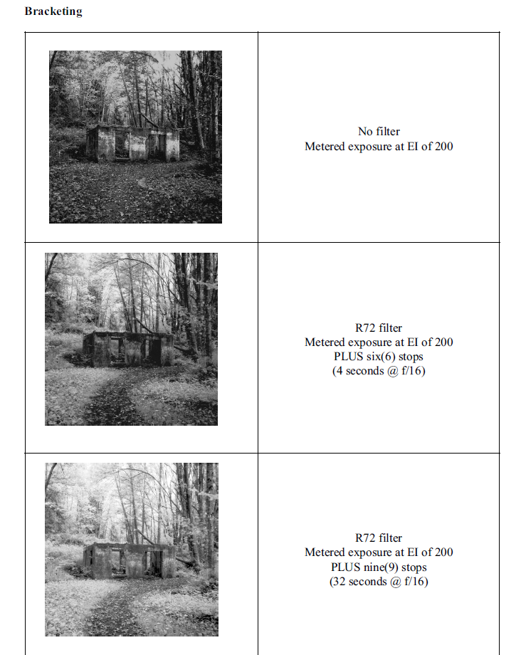

From a presentation I put together a few years ago, using Ilford SFX as an example:

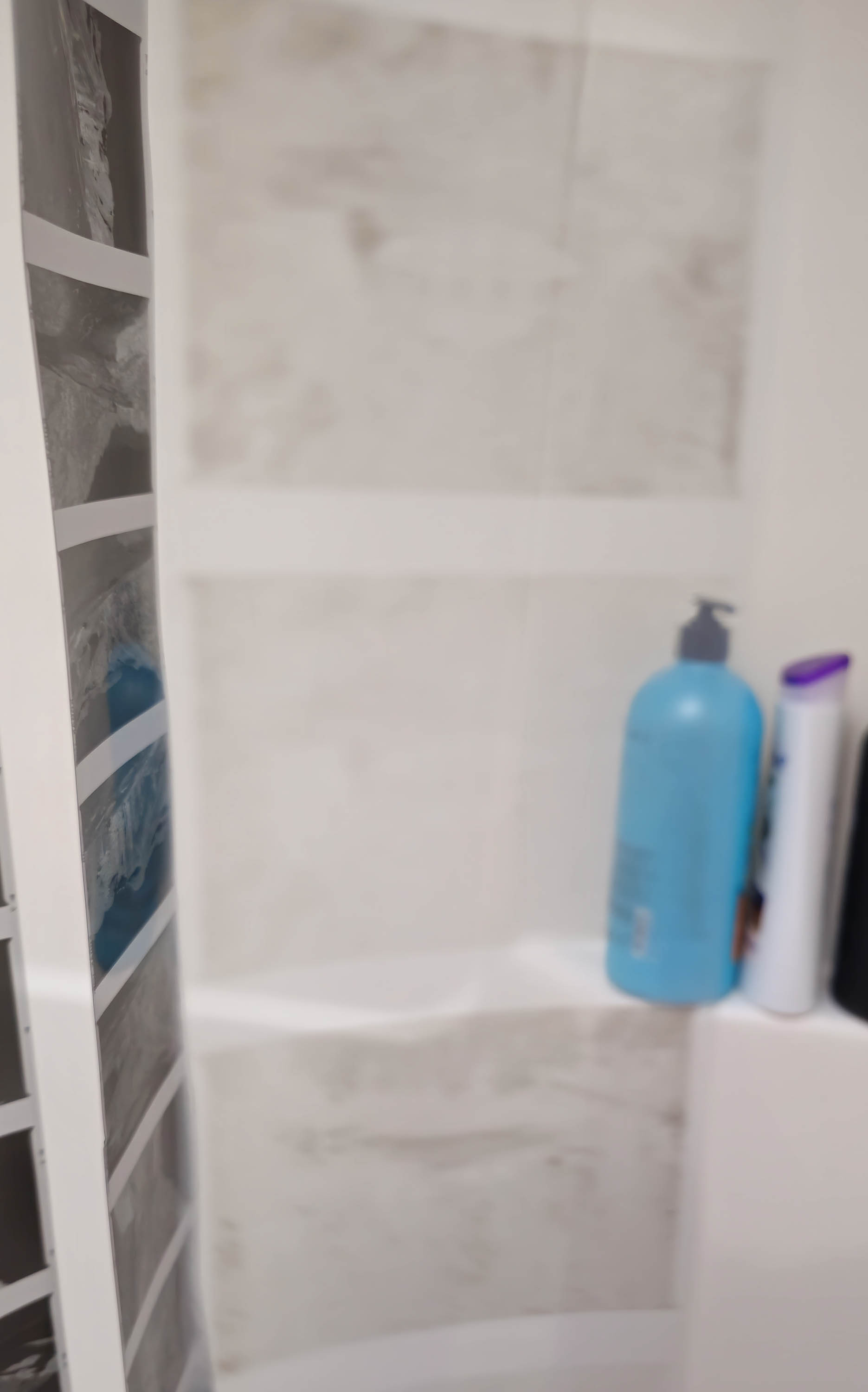

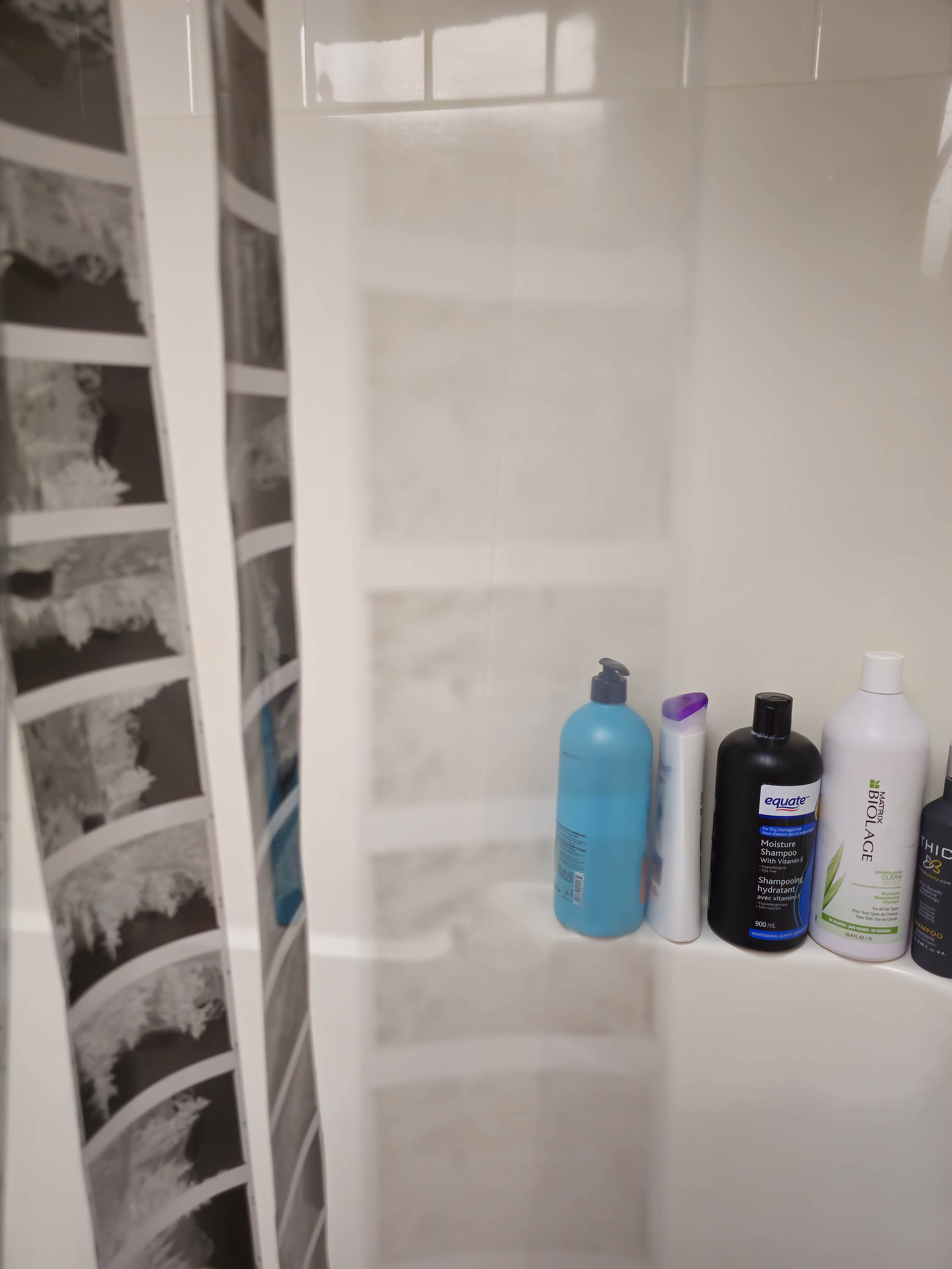

Its a total loss. Way under developed for some reason. I dont even think 17 minutes would be enough. Funny thing is I shot 1 or 2 shots without the filter, at 200 ISO normal settings, and it doesnt show up here anymore than the filter shots. So somehow its got to be be a developing problem. The rolls I did right before it are hanging next to it in the same shots. So its not the developer that is the issue. Other film was Plus X. Im wondering if my camera settings may have been at fault here. Trying to set the camera to manual mode. I think that might be why these are so off. But some shots were as long as 30 seconds (I think F11?), and I did bracket on this roll.

Its either a camera issue, metering issue, or a developing issue. When it dries, Im going to see what I can recover via the flatbed scanner. You can see some variations in how much each shot shows, so the bracketing was working there a little.
Oh, that's too bad. I don't see any edge markings either so that points to a developing problem. Maybe a mistake with the dilution? I had that some time ago with a similar result. I'll wait until tomorrow with my development to see if anyone else comments.
I agree on it being a developing problem, but that's just an educated guess from what I see in the negatives. I'm using an old Epson 3200 flatbed scanner for my 4X5's and I'm amazed at what that old thing can do with some really thin negatives. It pulls detail out of the shadows that I can't even see on the light table. Good luck.

Yeah I dont know how the developer bungled up on my roll. Chalk it up to a mistake.
Hey, shit happens! A couple of weeks ago I was developing two rolls of 120 with XT-3 replenished in my ss tank. Instead of putting the used developer back in my gallon jug I poured it down the drain. I don't know why I was thing "one shot". Like I said, it happens.

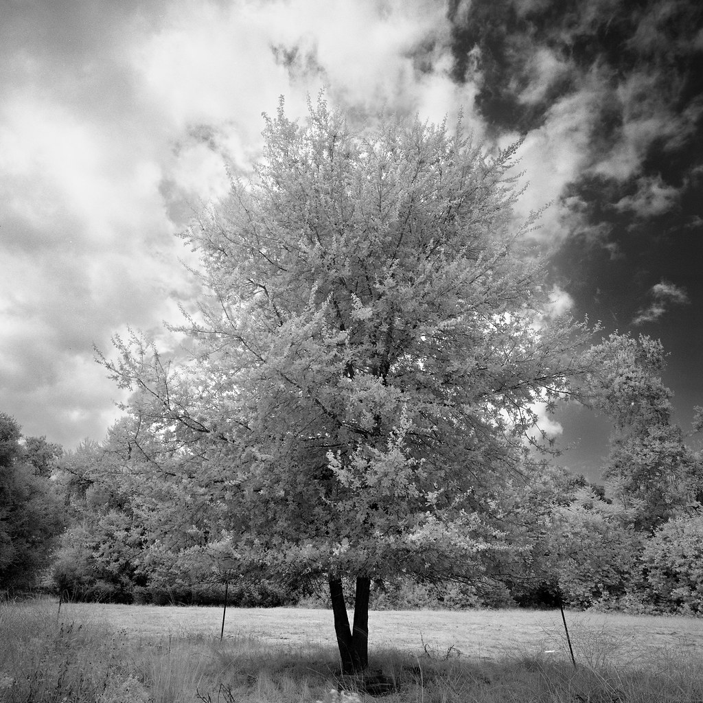

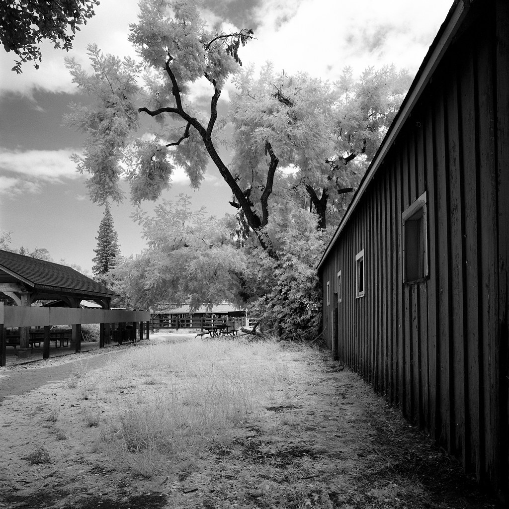

I tried Rollei IR 400 and Hoya 720nm filter for the first time yesterday, and the results matches with most of the suggestions here about effective ISO of 6-12. It was very cloudy day and the light shifts quickly between shots, and I have been metering the shadows. I developed the film in Paterson tank, using Clayton F76+ 1+9, 7 minutes at 70F. At least in medium format, the grain is not so obvious.
HassySWC_RolleiIR400B_003 by Zheng, on Flickr
HassySWC_RolleiIR400A_006 by Zheng, on Flickr
@braxus definitely something going on with the developer. At 14 minutes, you should have had decent densities.
It was exhausted developer. I was reusing the developer for several rolls, and it was Xtol 1:1 which made it worse. It just so happened that roll reached the end of the developers usefulness and life.
