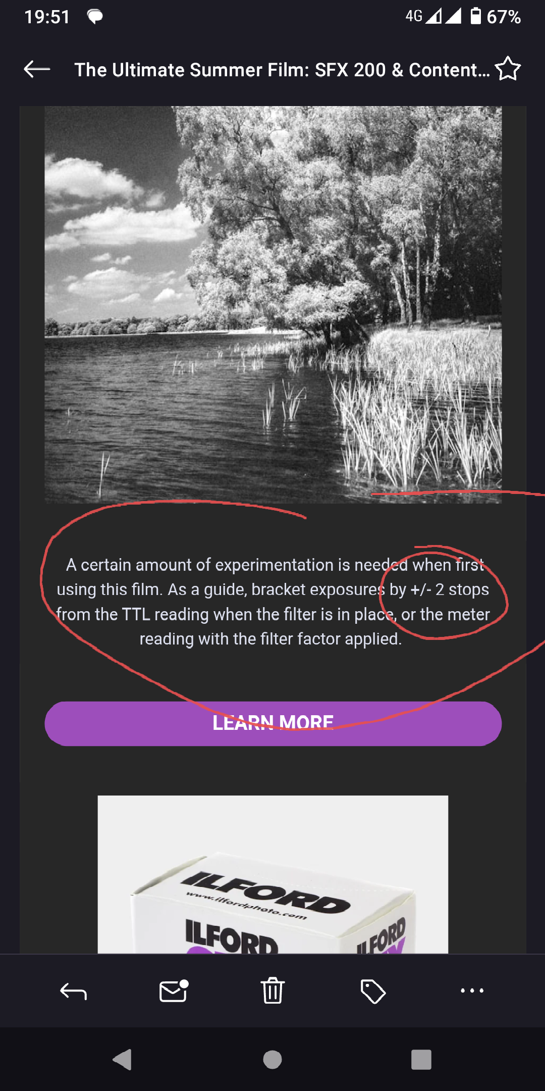

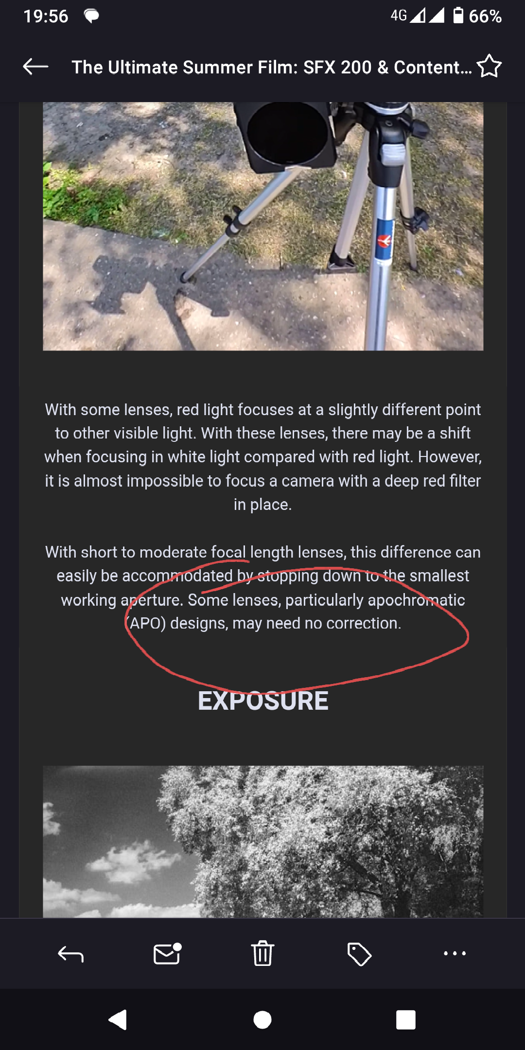

I feel validated - info from Ilford newsletter :smile:

That's a good way to drum up sales ! ... but honestly that seems excessive.
I couldn't justify using more than half a roll of 120 on one shot, that's more expensive than the typical two shots I've been doing on 4x5"
I find focusing not to be an issue at all and can give a closeup examples in 135
Hmmm. Don't know what to tell you then. I just dug out the affected roll in question and evaluated the frames again under a loupe.
On this roll I used the 50mm FLE Distagon at apertures between f11 and f13, and the 180 Sonnar at apertures between f8 and f13. Every single frame is back-focused to some degree from where I intended.
In contrast, every other instance when I performed IR focus adjustment on any of my Hasselblad or Pentax 6x7 lenses with an R72 I achieved critical focus exactly where I intended. The exception is my Superachromat, which by design requires no compensation even with "real" IR films.
I suppose it's possible on the bad roll in question some freak other factor caused the mis-focus on every frame, just on that roll, but I find that exceedingly unlikely.
Perhaps I'm just evaluating my results more critically than most.

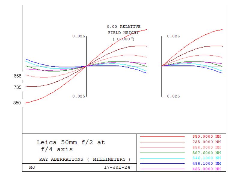

Not sure if this helps, but here are the transverse ray errors for the centre field bundle of a Leica 50 f/2 at f/4.
The amount of slope ( tilt ) of the coloured curves indicates how far out of focus they are. Horizontal = good.
