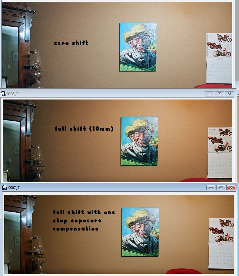

Well, here is the results of my makeshift test. Not a huge change with the shift. I'm just surprised at how little the exposure compensation changed things.

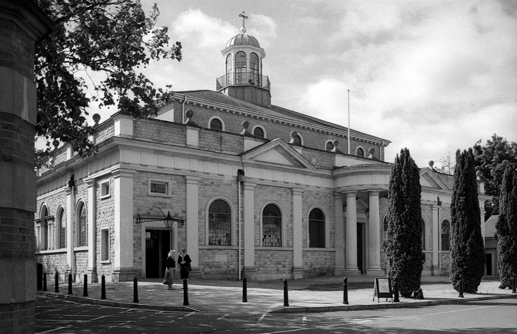

I have the loan of an OM-4Ti set which includes the Zuiko 35mm f2.8 'Shift' lens and i used 'Auto Exposure' with 'Spot' metering and photos came out perfectly -- here is one against the light with 'Spot'metering and Orange filter --

Yeah, I've come to the conclusion that even if there was a difference in light admittance with shift, it's not enough to worry about. Even when I used slide film on a Sylvestri (no internal meter), I don't ever remember altering shutter speed or aperture, and the results seemed fine.
