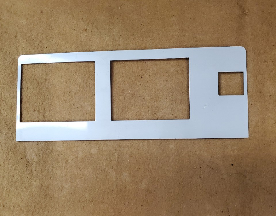

I remember studying about shellac a year or 2 ago, and learned that it has an expiration time, where in raw form or mixed. It goes bad and just doesn't mix or dry. I'm familiar with this camera and still don't know what the OP mean by the term "bezel'. Exactly what part is being called the bezel?
The bezel is the front metal piece above the name that act as a support for the focusing glass.
Ohhh.. I bet a wee dab of ordinary contact cement would be fine for that.

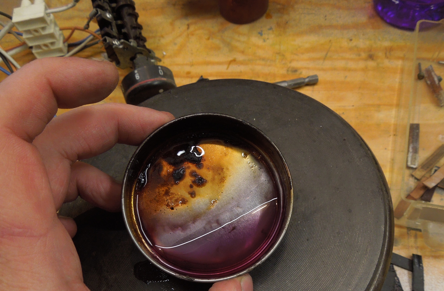

I tried repair an accordion years ago with shellac glue to attach leather flap valves to reed plates. If I remember right the method was to dissolve shellac flakes in denatured alcohol/ methylated spirits and then, in a small metal tray (I was using an airgun pellet lid I had more for the lead than than the projectiles), evaporate alcohol away while stirring till it got thicker.
Actually I just remembered I have some photos of that. I wasn't sure if I was burning the alcohol away or using a hotplate. The photo suggests using a hotplate (I had it out for another DIY shellac+rosin glue).
holy moly that exposed 240 volts back there
I think here i'd added more meths since the original batch of glue was drying out.
Burning it away would be alot safer though; guess I hadn't heard about moonshine still explosions 10 years ago. Occasionally out of the blue I still vividly recall the nauseating smell this produced - it's in that 'burning hair' genre.
