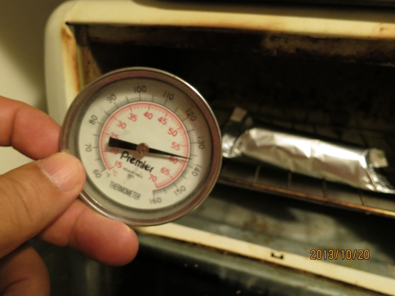

I did the oven test today to prove that "heat" is the backing issue of GP3 from -
https://www.flickr.com/photos/26863765@N07/15559515776/in/photostream/
Great work and thanks for doing it. Well, that solves the mystery then! Now, to figure out at which temperature the transfer takes place? If it's at, say 90 degrees, that's not good. 135 or 140 degrees I could live with no problem. I guess I'll just keep GP3 as cool as possible, which won't be hard to do in Michigan shortly. John W
Richard S. (rich815)
Jan 14, 2003
4,924
San Francisco
Heat was not the only issue with my GP3, its not 2016 version but I always kept most of it frozen or at worst room temperature. I live in a small city right on San Francisco bay where we rarely gets temps higher than low 70's and usually in mid 60's so our room temps are very mild, few around here even have aircons in their homes. Worked great with no numbers showing up until about a year or so ago. So I believe age has something to do with it too. And I tried removing a roll from the freezer, defrosting for a few hours at room temp, shooting it and developing it immediately. No change.. Numbers galore. :-(
JW PHOTO
May 15, 2006
1,148
Lake, Michig
Darn, I was hoping the issue of DOT/numbers transfer was resolved, but I guess it's a "gassing" problem dependent on both time and temperature. Higher temp - faster gassing! Lower temp - longer time to gas! I guess you have to buy smaller lots and use fast.:pouty: John W
