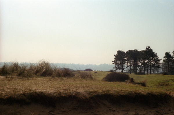

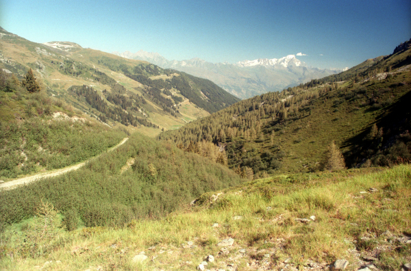

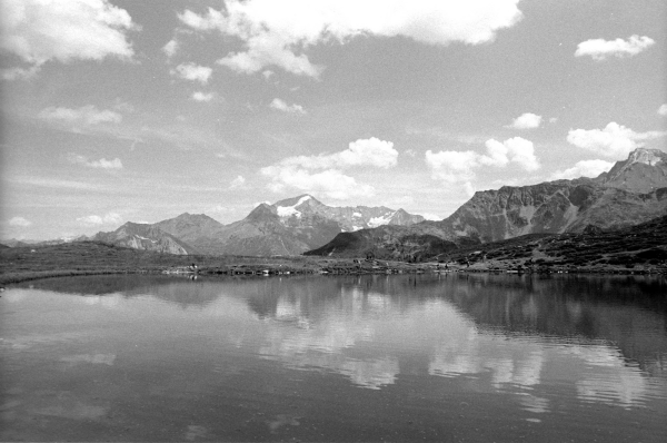

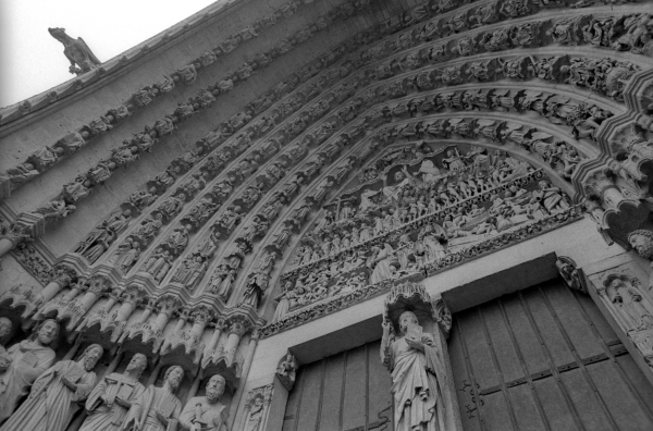

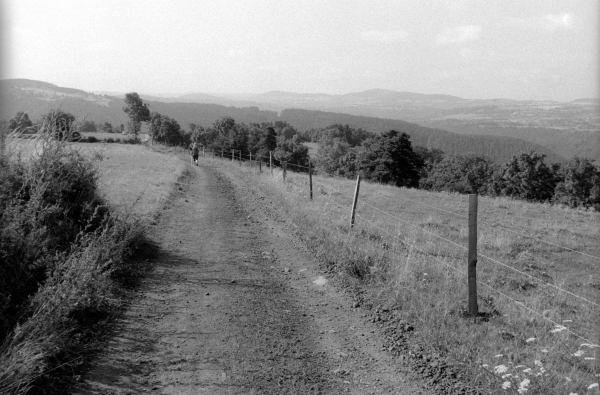

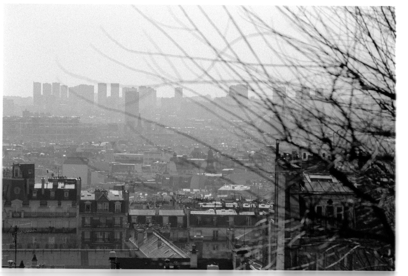

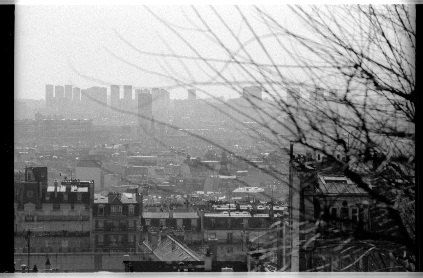

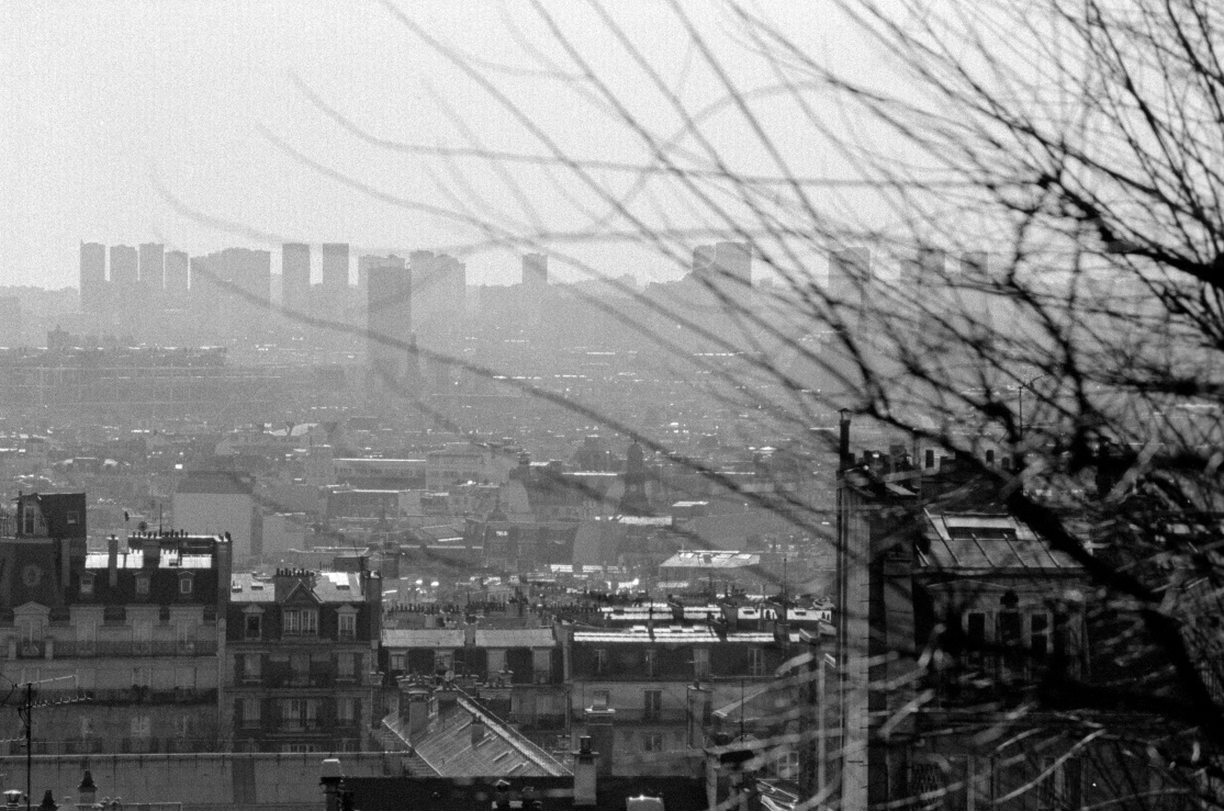

I scan 35mm films with my LS-40, and I get a "shading strip" on the left border on most of my pictures.
6WgNCXoxROBd0TbW.png 6YnwSXZqVopc8nz3.png R3udLO8EdCDG1Qbl.png 16d0QZmpSgjeOMVN.png USHHsLDioMdTsSZv.png
It more or less visible depending of the picture (it's exposure?). It happens with B&W and neg color films.
It's not on the film: the strip is not on the pictures I previously scanned with a LS-2000.
I use SA-21, with VueScan on Linux.
A dirty mirror? A light leakage?
Any idea is welcome!

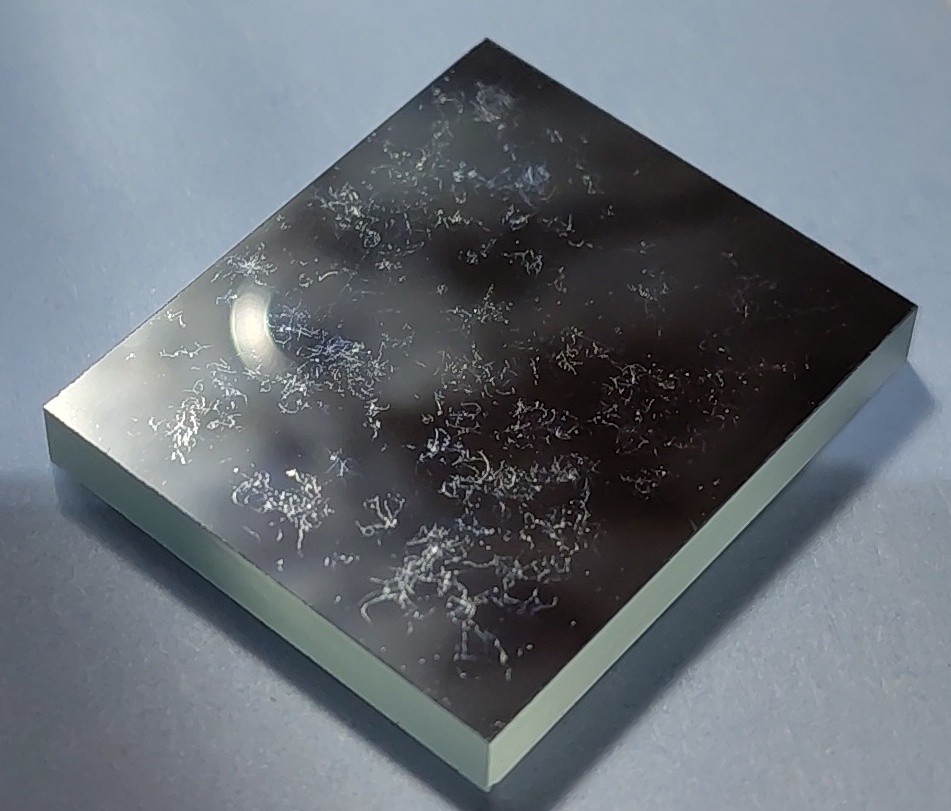

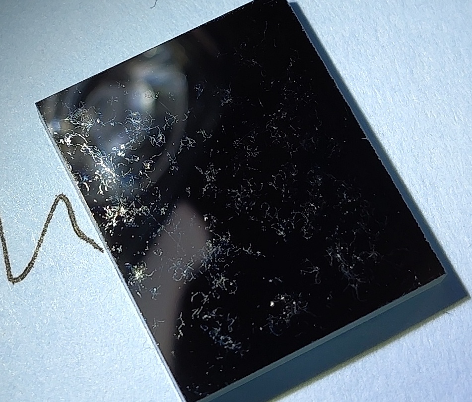

1st step: cleaning the mirror

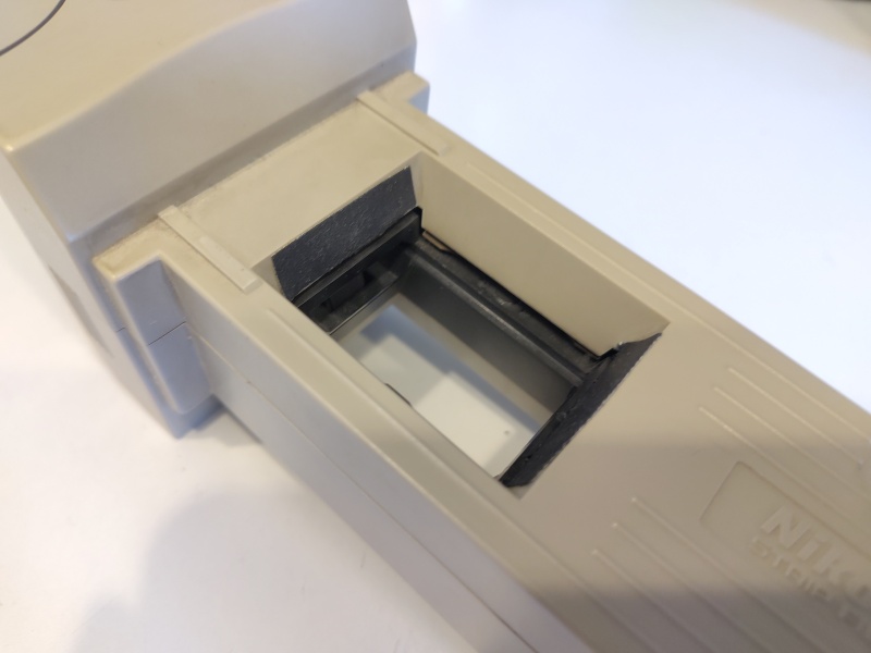

That's not that difficult. I put the scanner upside down, removed the clip, and and took gently the mirror off.

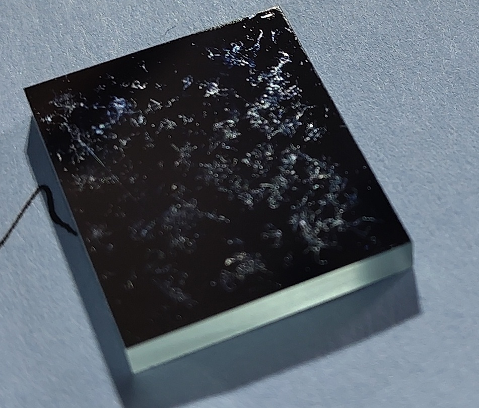

It was dirty. I used isopropyl alcohol and lens-cleaning Kodak sheets.
It's now cleaner, but, it cannot got it clean. It seems pitted (and has a scratch).
(Not easy to shoot a mirror! 😅)
I tried some scan:
Inverting the film direction:
The problem is roughly the same on the other side.

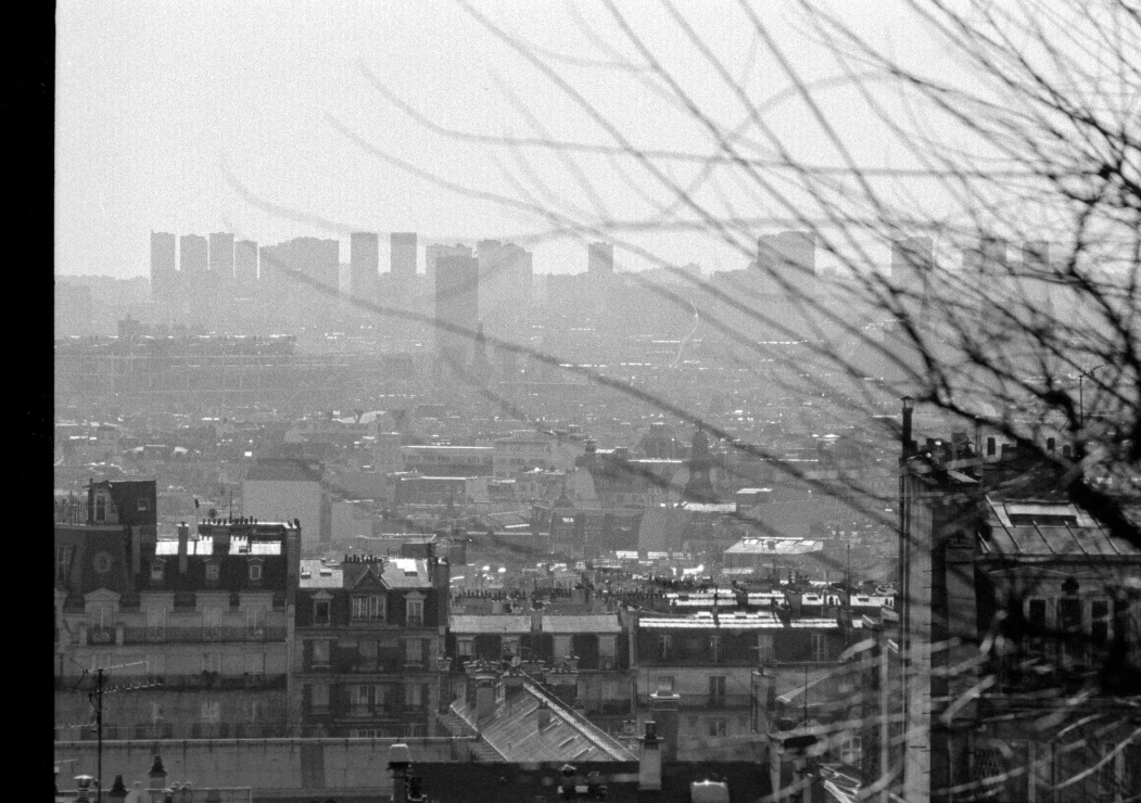

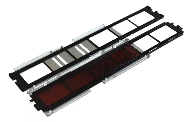

2nd step: trying another film holder
(FH-2)
Once the picture positioned in the holder, the picture border is completely masked by the holder plastic frames.
The picture has no strip.
My conclusion is the shading strip comes from using SA-21 with dirty/pitted mirror.
  • The SA-21 gate is larger than the exposed picture (feature to ease positioning with a simple cropping),
  • The dirty/pitted mirror spreads the light onto the picture border, which is visible especially when the border is bright (dark on film).
Seems I will try to buy some replacement for my mirror.

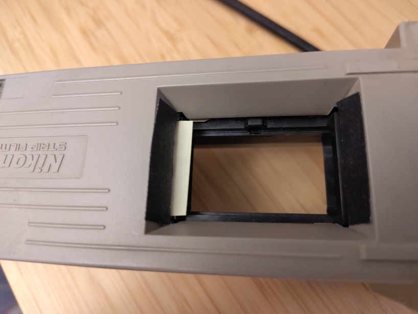

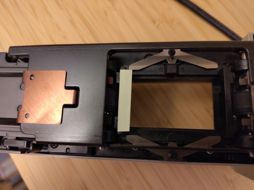

My main suspect is now the SA-21. It's seems to works correctly and I don't see any physical defect. I tried to add black gaffer on SA-21 border (upside, since the light comes from there), to prevent any possible light diffusion. No change.
Of course I could use FH-2, but it's much much slower for scanning rolls. Am I alone with this issue?
Other ideas?

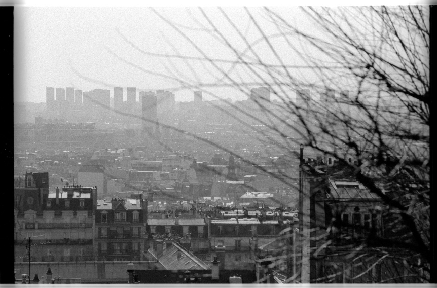

Other test: masking borders.
On the scanned picture, there is no more shading strip. But one can seen some blurred light strip.
So, no solution in this way. I don't see any hope to align frames and replacing shadow by light is not good either.
