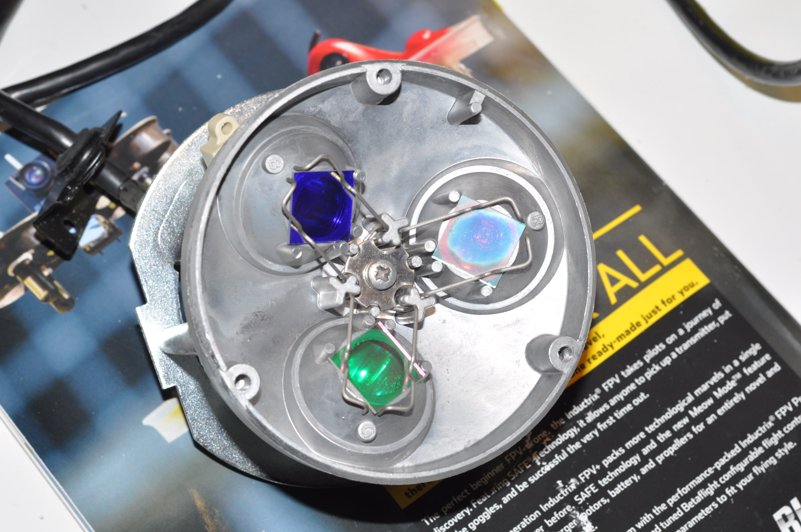

The three filters for the RGB light unit. Green, blue and red.
The red filter; not needed for B&W printing.

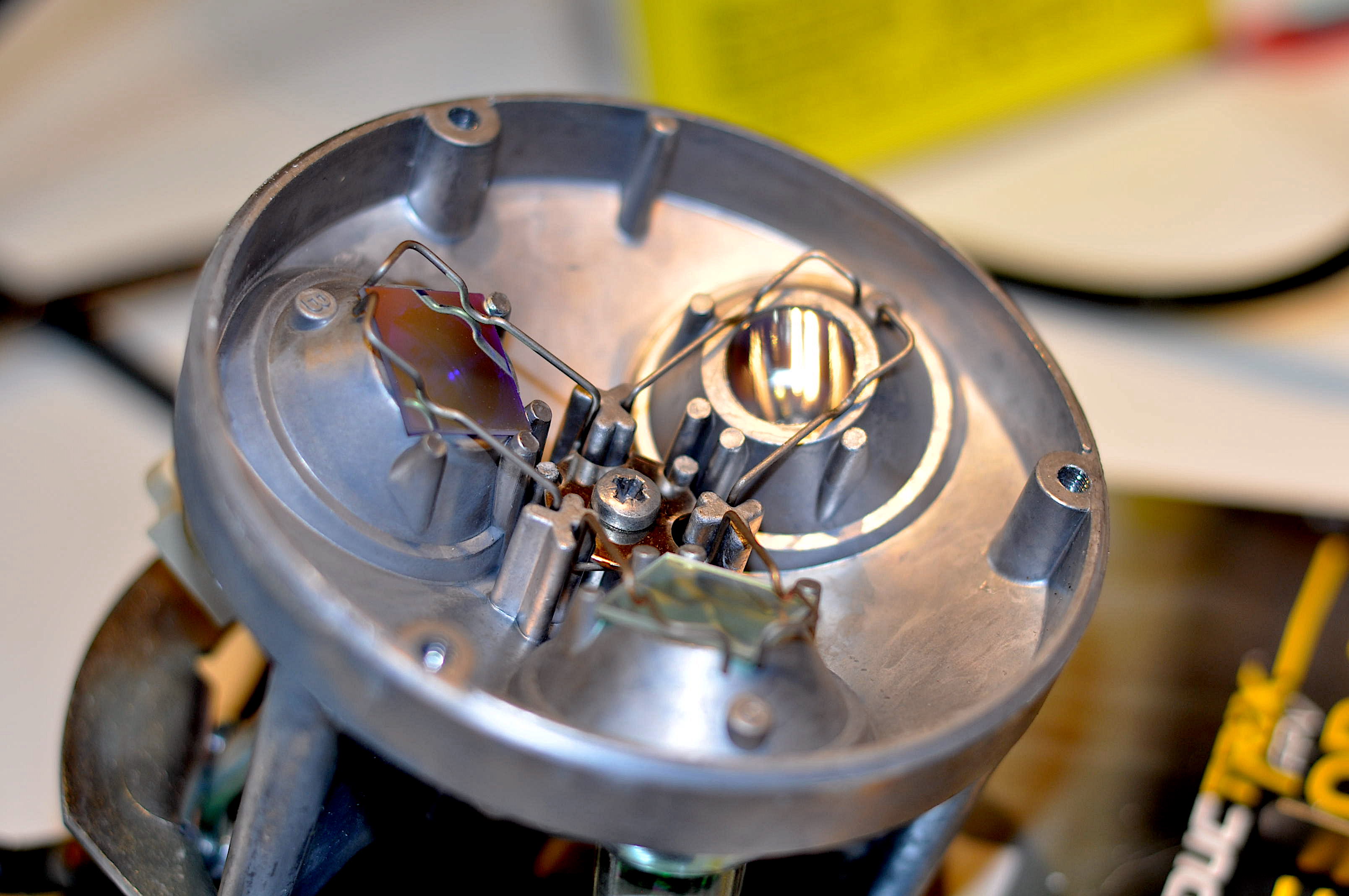

Red filter removed. Nothing modified here, the filter can easily be put back if needed.

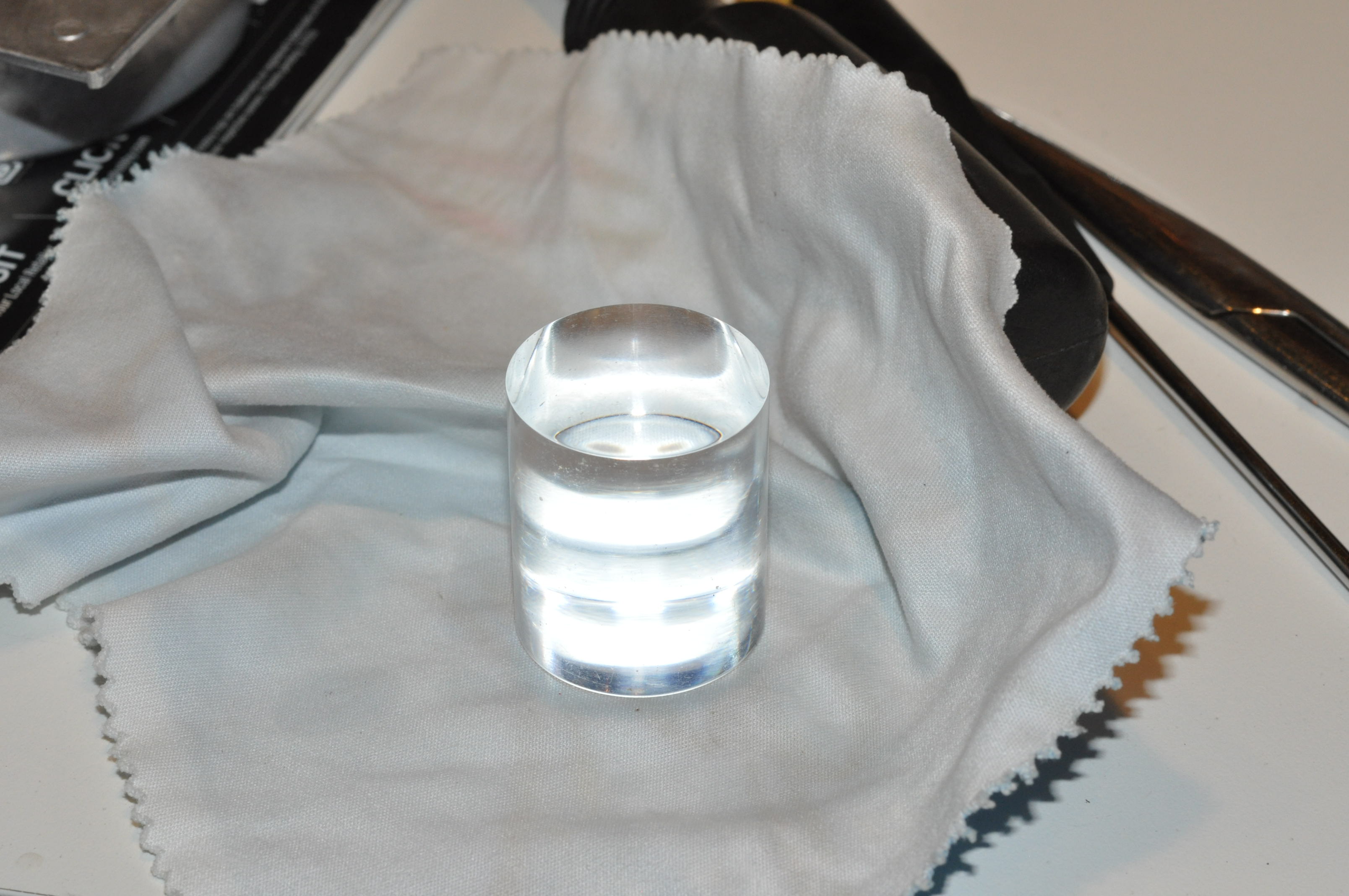

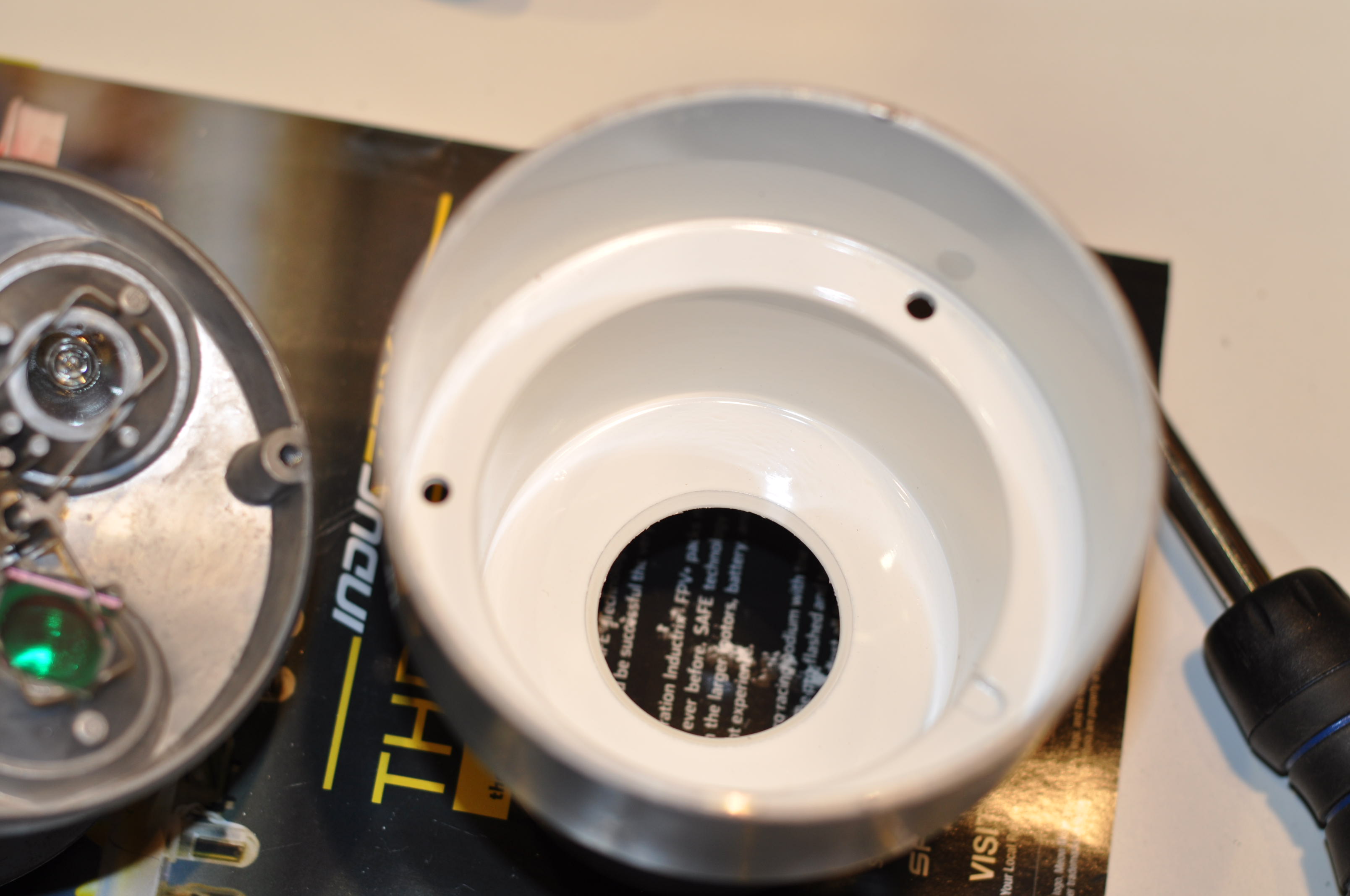

Light integration (mixing of the colors) achieved with this cylindrical white mixing chamber and a light pipe.

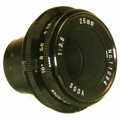

A lot of short focal length enlarging lenses have a recessed design, so a recessed lens board is not required. The Voss 25mm and Minolta 30mm come to mind. Here is the Voss:
