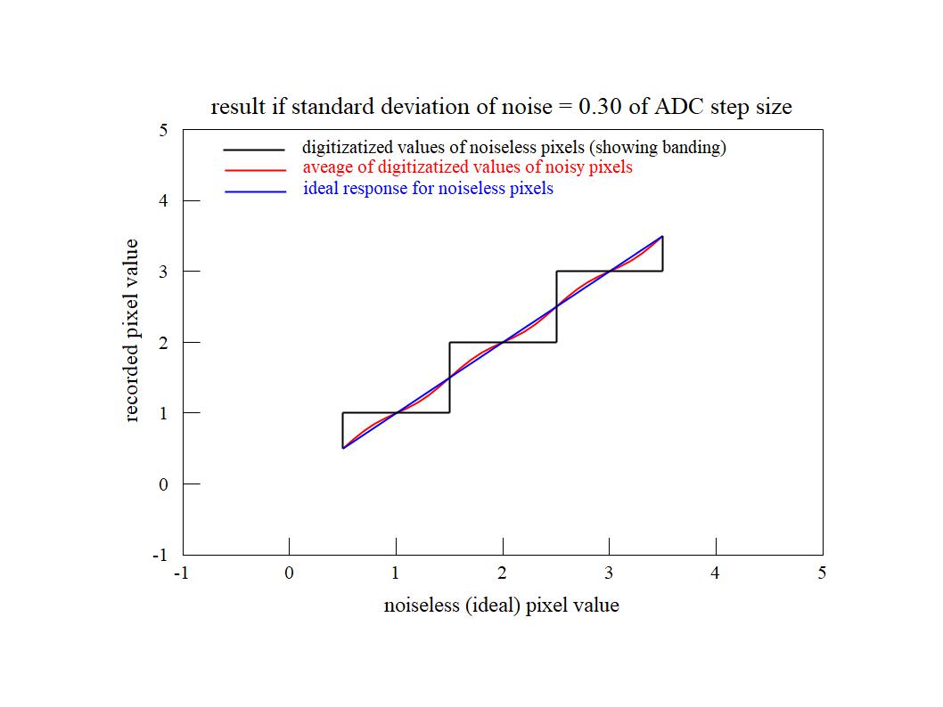

I have done some simulations of how noise (including grain) affects the possibility of banding. Here are a couple of plots of the results. They take a little explaining. One of the figures shows the result if the noise (as measured by the standard deviation of the signal) is 0.4 of the digitization step size. the other shows the result if the noise is 0.3 of the digitization step size.
This was a Monte Carlo simulation using a random number generator. There are eleven points on each curve. Each point is the average result for one hundred thousand random samples.
If the noise (including grain, sensor noise, etc.) is 0.4 of the digitization step size the result (red curve) is almost indistinguishable from the ideal case (blue line) if there is no noise and an infinitely small analog to digital step size. This means that there will be no possibility of visibly evident banding. The black curve is the result of digitization of a noiseless image. It is of a stairstep form and because of this there is a possibility of visible banding.
Even for the 0.3 case the red curve is quite close to the blue curve. This means that visible banding is unlikely. Because the red and blue curves do not perfectly coincide there is the possibility of a small amount of hue modulation in a gradient if the rgb channels are out of synch with each other. (I won't try to give an extended explanation of this unless someone asks.)
Anyway, as long as the noise (including grain, sensor noise, etc.) is about a third of the ADC step size or greater, then banding will not be evident in an image.

I will start by saying that I break the problem into two parts. One is the effect of how the use of a limited number of bits to express a visual value affects the ability to represent a smooth gradient. The other is how this fits into the issue of non-linear encoding, roughly speaking gamma encoding.
The graphs I posted on October 9 only directly addresses the first of these issues, and it applies to the final representation of the visual values, regardless of whether the data were preceded by some king of non-linear transformation.
Let me explain this a little more fully. It deals with the noise level after any non-linear transformation has taken place but before the final conversion a limited-bit length word, such as 8 bits. Let me give an example. Suppose I sampled a broad swath of an image at 8 different points, further supposing that the brightness of the image is uniform, aside noise. Suppose that the 8 points had brightness values as follows.
