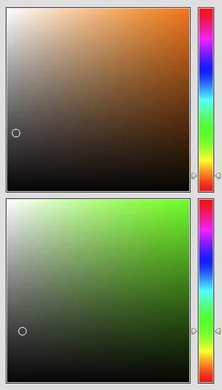

I blurred both to even out the light and dark and checked the colour cast with the pipette:

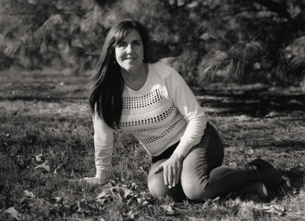

Just wondering which one is preferred by other viewers and perhaps why. Top image toned in Selenium 1+7 for 10 minutes; bottom image untoned. Thanks
EDIT: I realize that it could be dependent on subject matter.
Also the one seen in the gallery is toned but inadvertently scanned using gray scale, so it's not picked up.
View attachment 326944View attachment 326945
Top looks great to me.

For me, the top one looks very slightly magenta/blue, and the bottom one looks fairly neutral :smile:

FWIW I far prefer the toned print, I love the impact of Selenium on the shadows and your print shows this. Great job!
I always pull my prints before they start going purple. I'd love to try gold toning after selenium but haven't stumped up for the gold toner so far, one of these days.
There's some weird stuff going on if you sample specific points across the image. I did this because I thought I saw something odd, and sure enough it's there if you measure it out.
Measuring on the toned print, using the a and b coordinates of Lab:
The grass on the right side just above the shoe m have slight positive a & b values (e.g. 1.1, 2.3). So they tend towards red and yellow.
The grass at the same height on the left side of the image measures near-zero or slightly negative on a, and also a little less positive (but still above 0) on b (e.g. -0.2, 0.7). So this area is slightly yellow to slightly lime. The lit cheek measures roughly the same (-0.2, 1.3).
Interestingly the sunlit patches on the sweater tend slightly towards red (0.5,1.5).
I can't tell if this is uneven toning or a problem with the scanner & post processing. The difference is subtle, of course, but it was clear enough for me to spot - I did the measurements above only to verify my hunch.
Overall I prefer the toned version; like @Andrew O'Neill I really don't care for the particular hue of green that untoned silver gel prints give.
This is also how I see it as well. Many have stated it appears "warmer" whereas I see it as a bit cooler with the untoned image being neutral.
I agree that the toned image looks cooler, but I can see a light green hue in the untoned one. I suppose a lot depends on the monitor where they're being viewed.
FWIW, I'm not a fan of the pink - purple of the selenium toner. I'd cut dilution and/or time to simply remove the green tint.
I prefer the top image because it seems to have more contrast.
