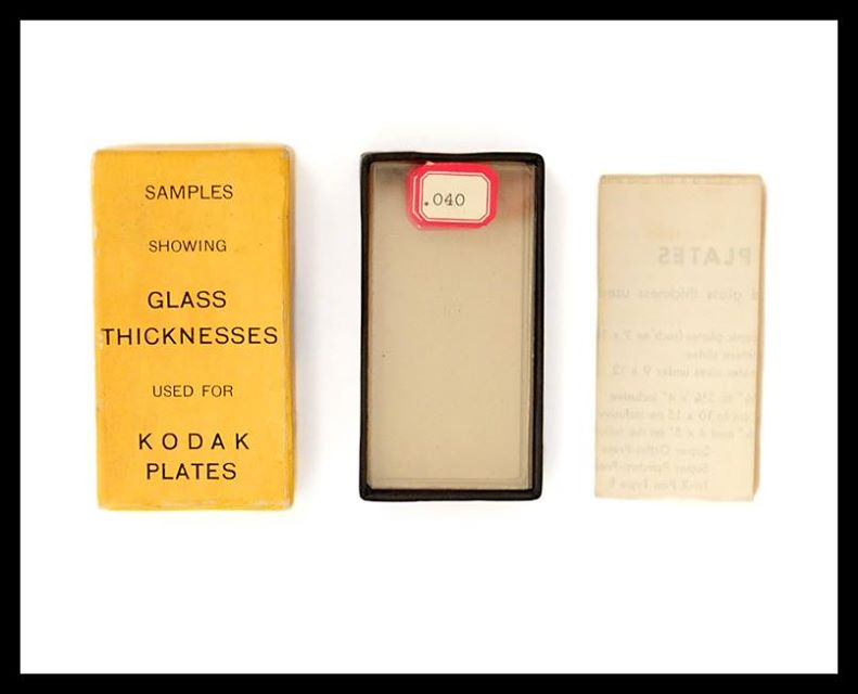

I would really recommend getting a sample box like this. It has a data sheet for the different sizes made and a sample of the glass thinkness that was optimum for each size along with other info about the types of glass for the size of the plates.
