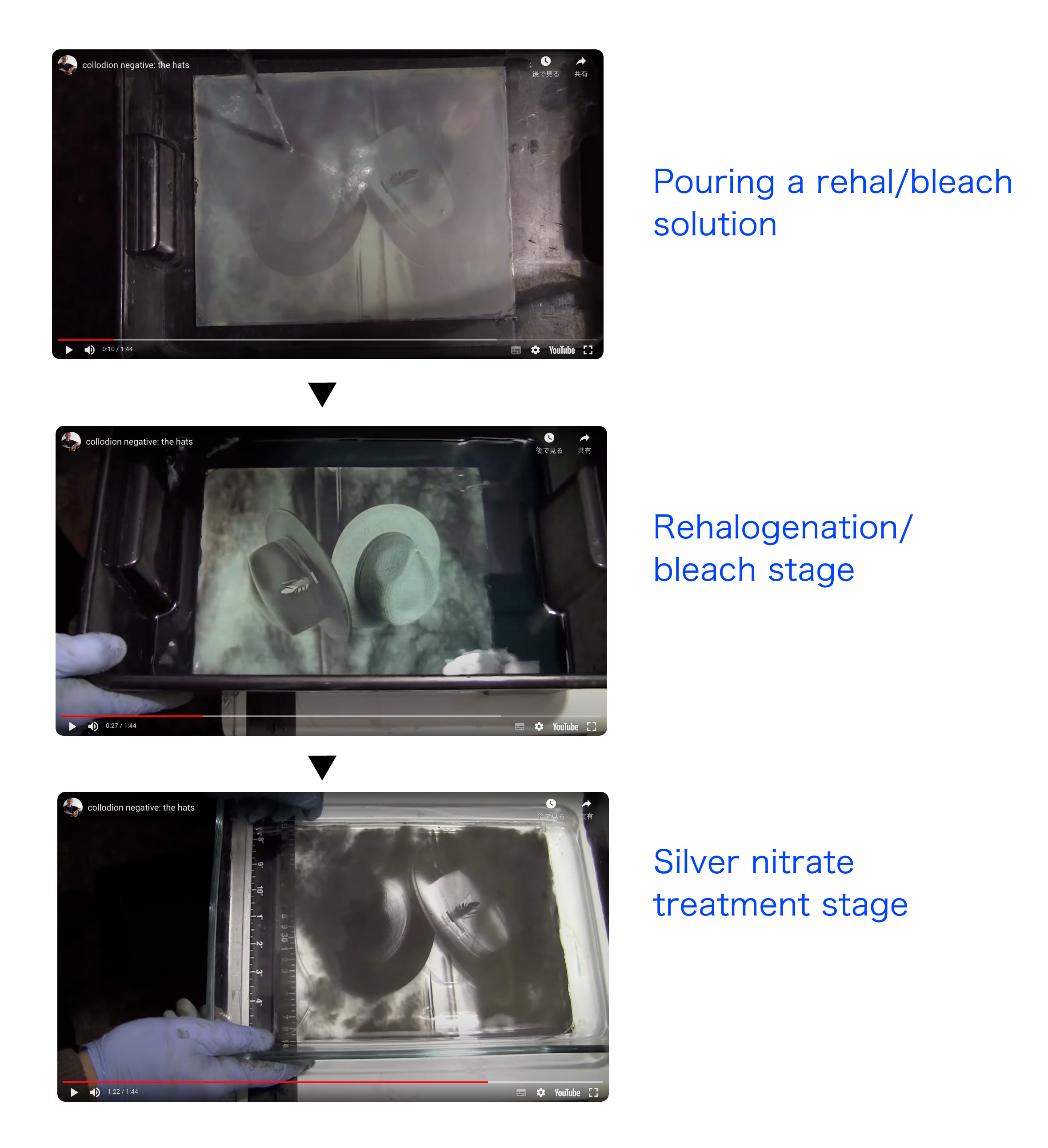

In my last intensification experiment, I used Potassium Ferricyanide instead of Copper Sulfate, but is my understanding correct that essentially the same thing (bleaching) is happening?
>The job of copper sulfate is to make silver (+ve) ions out of silver metal (bleaching) which then are grabbed by the halide (-ve) ions from the halide salt added to the mixture forming silver halide again (re-halogenation.)
This halide salt refers to Potassium Bromide, right?
Which of these chemicals is making the image whiter? In my previous experiment, the image did not become as white as the second photo (Rehalogenation/bleach stage) attached (this is not my work but I captured it from the video about Copper intensification just for reference).
In any case, the areas that were originally darker in the first photo (before rehalogenation/bleach) and turned whiter(during rehalogenation/bleach stage), those were formed purely by silver halide, is that correct?
Is this whitening effect caused by bleaching or rehalogenation? Or is it a result of both chemicals working together to become silver halide? (Meaning that both chemicals together create the whitening effect.)
If I fix this silver halide image (without performing silver nitrate treatment), will the image disappear? Or will parts of the silver atoms that haven't converted to silver halide remain?
koraks
Nov 29, 2018
27,462
Europe
Yes, that's the halide (the bromide, at least). The silver halide will then be silver bromide. This is indeed the compound that is formed from the silver image as you bleach it.
The silver halide itself is mostly white - but how it looks, depends a bit. In your ferricyanide bleach, it will be a bit yellow, at least during bleaching, because of the yellow ferricyanide. Moerover, if you expose the bleached silver bromide image to strong (especially UV) light, it will at least partially 'print out' into a silver image. This tends to produce more pink and brownish hues. This fits with what you noted about exposing a bleached plate to sunlight.
Correct.
It's not an either/or question, really. 'bleaching' is the chemical term we use in this context for converting metallic silver (Ag) to a positively charged silver ion (Ag+). Well, physically, what really happens is that we 'steal' an electron from each silver molecule, leaving it one electron short, and that constitutes a positive charge. Such an ion tends to interact with other materials nearby, because (simply put) the silver ions will try to get their electron back, and they're prepared to associate with other ions with an excess electron if need be - entering a kind of nano-level time-sharing arrangement. In the instance of a rehalogenating bleach, the silver ions pair with negative charged halide (bromide, chloride, iodide) ions. These ions have an excess electron that they're willing to share with the silver ions. The arrangement only works if they (the silver and halide ions) remain close to each other - they're essentially holding hands by means of a shared electron.
As noted before, the white appearance is just the color of the silver bromide image. From the explanation above, you might glean that the whitening is the result of not bleaching or rehalogenation, but it's really the result of both happening at the same time.
In case you're wondering if you can also knock an electron off of a silver atom (making it into a positively charged ion) without the silver ion consequently entering a marriage with a halide ion: yes. That's what happens in a non-rehalogenating bleach. In this case, electrons are knocked off of silver atoms, turning them into silver ions, but in order to 'regain the use of their lost electron' (put in laymen's terms), the silver ions leave the plate and start dancing around in the bleach solution, where they (sort of) dance in pairs with dissolved negatively charged ions. As you can tell, it's a very similar process, but the net result for us, photographers is very different. With the non-rehalogenating bleach, the silver ions leave the plate (or film) and will wash away along with the used bleach.
Additionally, the negative that underwent rehalogenation/bleach followed by silver nitrate treatment also became slightly darker (to a level that is not easily noticeable). This might be because I diluted the silver nitrate concentration considerably (2%), so there might still be some remaining silver halide. Higher silver nitrate concentration speeds up the conversion to silver atoms, right?
As to the remark on speeding up: yes.
As to the phenomenon of the intensified plate also becoming darker: what you're seeing is indeed blackening of remaining silver halide. In my experience, intensification acts on the surface of the image. On images with a lot of silver on them (high optical density), it becomes very difficult or even impossible for the silver nitrate to break through the layer of silver that forms at the surface of the image during the first stages of intensification. If you look at such a plate through the backside (if it's coated on clear glass), you can see the pink/liver color of silver halide that's not entirely converted back to metallic silver. In practice it's usually not a problem with printing from such plates. The pink/brown/liver color tends to darken quite a bit on exposure to UV light, as you've noted. Even if some remains, it's usually still OK. What it does mean, is that there's usually a practical limit to the process of intensification. However, that limit occurs at such high optical densities that it's virtually never a practical limitation.
Copper Intensification (after silver nitrate treatment) leads to fixation
I never noticed this. I've intensified plates with copper sulfate (+ potassium bromide) followed with silver nitrate several times, also treating the same plate more than once, and there was always a dramatic density gain. I have to say I only did this on plates that were already fixed after development and thoroughly washed. Massive fog will probably obliterate the image if you do this process on unfixed plates.
But perhaps I misunderstood your remark and you intended to say that fixing after intensification is not necessary? In that case, I agree. There's no need for it.
PS: that image sequence matches my experience perfectly.

Also, I discovered another puzzling thing about the same plate above.
When comparing a negative without Intensification (the left column in the image) that was exposed with the exact same exposure of the aforementioned intensified negative (the left column), surprisingly the Intensified negative appears slightly less dense (on the lightbox). Also, I also made contact prints (gelatin silver in darkroom) and placed them on top of the corresponding negatives. The exposure time and filter (0) were the same during printing. However, when placed them on black velvet, the Intensified negative noticeably appears brighter. I can't understand how the Intensified negative looks brighter despite its density being reduced due to Intensification. Could it be that the silver bromide's brightness is causing this effect (eye trick)? Although this effect is more convenient for me it led to another mystery. Also, I wonder if I can maintain this brightness or not.
The 'intensified' plate really looks like a pure silver bromide image to me that has not actually been intensified - just bleached. This is more evidence that the intensification is probably not happening. The plate would look very different - and it wouldn't work as an ambrotype anymore.
Can you tell a bit more about the 2% silver nitrate solution you've used for these experiments. Is it just silver nitrate in distilled water? Have you added any nitric acid etc? In my case, I used to use a very weak silver nitrate solution (probably less than 1%), but I had added a little nitric acid to it. I don't know if that makes a difference, but it worked that way for me.

Thanks for your comments!
Yes, I watched some YouTube videos and thought that the silver bromide image would change to black, but it didn't. Here are four negatives shot at the same exposure, with different post-processing (prior to the UV exposure test).
For the top row, I put a small strip of newspaper between the negatives and the white paper just to the right of my face (to see the density difference).
You can see that the silver nitrate-treated negative on the very left has a slightly higher density than the other three negatives.
However, intensification with silver nitrate may have little effect as you say, as is evident from the ambrotype-like appearance.
The silver solution that I prepared was:
2g Silver nitrate
150ml distilled water
Note:
The solution was not exactly the 2% as you can see above (1.3%).
I prepared it right before the treatment (no nitric acid was used).
For the treatment, I didn’t pour it on the negative but filled it in a small black tray.
As to 345 (the image on the very left), after the rehal.bleach treatment, I put the negative in the silver solution and waited to change in density. The dense area (background) slowly became brighter gradually (I used a black tray).
Do you get any clues from the process not working properly?
Thank you!
