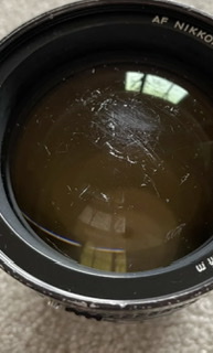

Scratched lens: Usable/salvageable?

yes, totally usable...especially with an appropriate lens hood. Stuff on the front element really has little effect.
Try it, you may be pleasantly surprised.

Just about anything "AF Nikkor" should be available on the used market with better looking optics. If you already own it, why not let us know how it functions!

You might get acceptable results if you avoid pointing it towards bright sources of light and use larger apertures, but I wouldn't buy it.

That photo could be either flattering or unflattering. If flattering, then the scratches are worse than what you see. It looks like scuffing across the centre, with lots of smaller scratches around it - like something smashed a filter that was on it and then ground it into it. That will lower contrast. Anything shining in the image will look furry (picture a furry shiny car in the sun).

Don't own it (yet) but I may make an offer.
If you had it, use it. If you don’t own it, why on earth would you consider this? there are a bazillion Nikon/Nikon mount lenses out there for pennies on the dollar.
So what if it is cheap? Treat yourself to something decent, you are worth it.

I'm always amazed that people manage to get scratches. Let alone "scraped it along the sidewalk" scratches like that.
With a filter, that any sane person has on, and shade and cap on, no one should ever get scratches.
Cleaning marks shouldn't be possible either, because of course you blow first, then brush gently and then wipe very gently with a piece of soft cloth that has been stored in a clean location, lightly moistened with alcohol (or for older glass demineralised water).
But this sure as hell isn't cleaning marks.
Don't buy unless it's really, really cheap (like $20). You'll always be wondering how much better it could look, and you can't be sure how an owner who allowed this to happen has otherwise treated this lens.

$20 is about $20 too much. Put that $20 into getting a better lens.

I too always put a UV or Skylight filter on all my lenses as a safety precaution.
