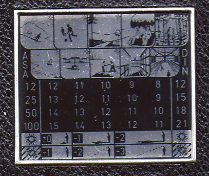

This is the graphic I first learn to photograph with -- on the back of my Rolleiflex at the time (second half of the 70s).
