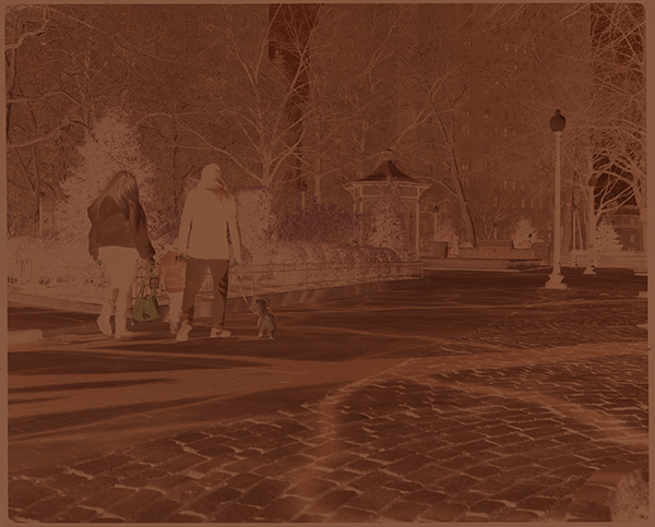

Just to be sure, this is the setting I use for this purpose on my old 4990:
Yeah me too, looks like this:

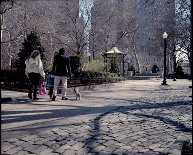

And the resulting scans look like:
btw I forgot to include the image below earlier but if I just let Epson scan do all the thinking in auto mode the results are much closer to what I see on the iPhone image, and also closer to my memory of the scene:

Yes, that works well especially on an image that overall balances out to pretty much middle gray. It doesn't work well if there's a strong/dominant color in a large part of the frame; that's what went wrong in the Prayer House shot. And this illustrates that the scanner/software will come up with a different balance for each shot, which can be rather annoying when working on a series photographed under similar conditions.

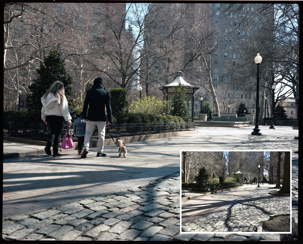

Btw, this is what I get if I take your negative and run it through my 'process' (i.e. manual inversion + adjustment of the R, G and B curves):
From here, I would usually fine tune it a bit to taste with a final adjustment curve. This curve I would then also apply to the other images of the same series to maintain consistency.
For instance, in this case, I would opt to make the midtones a little less green, the shadows a little less cyan and add a little blue to the highlights to approximate how I would subjectively experience a scene like this:

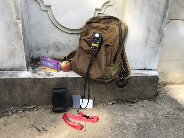

This result is better than I was getting before and is approaching a quality that I can use. I'm still experimenting with my approach, which is relying on a combination of the white/grey cards, using both Lab and RGB color space, and having a cell phone pic of the scene handy to check spot colors for obvious problems that my eyes might not catch. In this case I checked the four spots listed just to see how close I was to what the phone saw (which I know is a processed image but still). (Choosing what to sample is a challenge.) All four are fairly close but I'm sure you'll spot the differences. Without the combo of the white card and cell pic I'd be lost for sure.
I'm learning that the phone over-saturates skin tones when I use the Lab guidelines that @Mr Bill discussed earlier in this thread so de-saturating the phone pics a bit before relying on them for a disaster check tool is needed. Lab color is really helpful if like me you don't see color well.
I did an experiment this week where I took several pics of my bag in differing lighting conditions and tried to make it read correctly in full sun, full shade, etc. That was a good exercise. Thanks to @Mr Bill, @bernard_L and everyone else for the assistance. I appreciate it!
Overall, image saturation is a challenge that will need more experimentation. I'm getting images that are on a spectrum between dull and candy colored and it's hard to get it right. I'll keep at it and will appreciate any feedback you might have.

Here's what the phone saw:
Looks good; you've got some blue/yellow crossover in the film shot (well, a lot actually), but I personally don't find it bothersome. You can spot measure the hue on the black leather case just below the number "4"; notice how it's close to neutral (probably very slightly yellow/tan) on the phone shot, but very blue on the film shot. The same goes for the black straps on the backpack etc. The film shot is balanced more towards blue on average on the whole, but it's more pronounced in the shadows.
There's also a little magenta/green crossover with green shadows in the film shot. It's visible in the vertical concrete face where you placed the number "4". Again, ask yourself if it's a problem, per se.

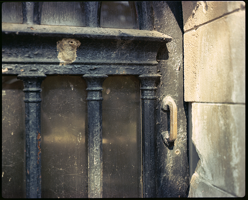

Ok, one more update because I'm still practicing and you're still reading this. 😉
I'm on the lookout for color crossover in the shadows and I think I'm spotting it better now. I'm aiming for a repeatable process and I'm getting close, at least I think so. My image editing time is going down and the quality is going up. But please let me know if anything looks weird to you. One side effect of this process is that I'm dreading color a little less. So that's something. 😆
btw, the other images in this thread were made with expired but always frozen Portra 160. I wanted to use some of my old stuff while I worked on a scan/process technique. These two are made with Portra that I purchased a few weeks ago. Apparently B&H are selling short dated Portra for some reason as this stuff will hit its "best used by" date in 2024.
