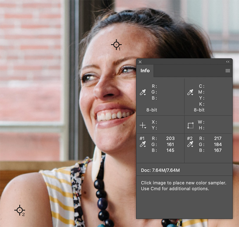

The skin tones will be significant so I hope to get a hand up with a color checker. And I agree, color calibrating my monitor is less interesting to me and I’m leaning toward the color checker alone, and perhaps using a cell phone image as an auxiliary guide too. It would be interesting to have a phone image side by side with a Portra image to check the numbers on the skin tones.
I'm not sure the ColorChecker will help you that much. What I would suggest, given that you seem to be a committed photographer, is to bite the bullet and learn how to work "by the numbers," at least to some extent. To me, the way to do this is to learn how to deal with CIELAB numbers. (Forget about RGB numbers; they mean different things depending on the color space/ICC profile in use.) In CIELAB (aka L*a*b*, or on the internet typically just LAB) the numbers will always keep the same meaning. (They are based on a D50 light source, as i recall, which is loosely the same as daylight with a color temperature of about 5000 K.) Plus they vary mostly in agreement with human perception.
CIELAB is probably not easy for a color photographer to jump to. You were probably brought up on the idea of red, green, and blue being mixed. In CIELAB you have to deal with two sets of "opposing" colors. All of the color info is in the a* and b* values. a* is essentially red vs green, and b* is yellow vs blue, with zero value being neutral. The L* value is loosely brightness - zero is black, and 100 (usually) is equivalent to a perfect white reflector.
When you deal with daylight flesh tones they're gonna fall in a fairly narrow range of a*, b* values. Typically about 18 to 20 with equal values (these are roughly what the ColorChecker flesh patches will come in at). Higher numbers are a more saturated color, lower numbers are less saturated. If someone has a ruddy complexion the a* value will be slightly higher with respect to b*. Or if a yellowish complexion then the b* value will be slightly lower with respect to a*.
You mentioned the possibility of greenish skin. This will be the result of a* being low with respect to b*. For example, say you have typical forehead flesh values of L*, a*, b* = 75, 18, 18. If you wanna turn the skin slightly greenish (seen more as a lack of red) change the numbers to roughly 75, 12, 18. For even more try perhaps 75, 6, 18; this ought to give a good sickly green skin appearance (although green is not actually present, only a lack of red). For real actual green the a* value must go negative, for example L*, a*, b* = 75, -6, 18. (This is actual green mixed in with a good amount of yellow.)
If you are willing to spend the time to learn how these numbers work you shouldn't have any more trouble recognizing bad skin tones. In case you don't know how to get CIELAB numbers... you mentioned that you use Photoshop. As I recall, in the window that shows pixel values you have two readouts. I would typically leave one in RGB, then set the other to LAB. (I presume that normal Photoshop still does this.)
One disclaimer: CIELAB is based on a more or less normal lighting situation (as I said I think a D50 illuminant). If you are trying to do something different, perhaps to give a yellowish tone to suggest a sunset or colored lights at a concert then these aim values don't apply.
FWIW I've spent years and years dealing with color problems in photo labs, and have made hundreds of ICC profiles for digital cameras. Hundreds and hundreds of printer profiles. (In those days i/we used the more expensive Macbeth SG target, something like 140 color patches, as well as its predecessor.) So I'm speaking from some experience when I suggest taking up CIELAB; it's what I would do. But... it's a considerable learning curve so it's not for everybody. It's just a matter of what it's worth for a specific person. Most serious photographers (without a lab guy) would probably profile their monitors (using a hardware puck/software) and work visually. So they don't need to learn numbers. But if your color vision is an issue... well it might be worthwhile. I dunno.

I'll do some investigating there as I've never paid attention to LAB. Here's a random image from the internet that I sampled in PS with LAB and RGB:

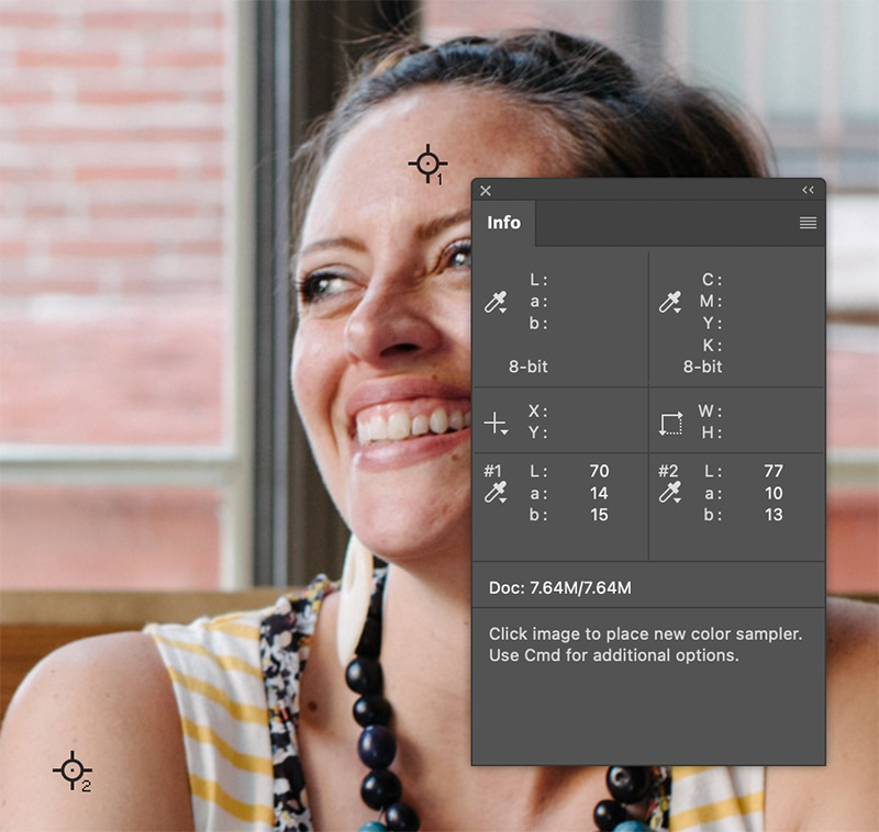

Hi, yes, on the forehead (sample 1) the Lab values have a* = 14, b* = 15. The two being similar suggests it's a typical (good) sort of skin tone. But...it's a bit lower than my suggested 18,18 to 20,20, meaning that the color saturation is a bit weak. There are two obvious ways to boost that skin tone color saturation. First is to simply increase saturation in Photoshop. Second is to raise midtone contrast a little; perhaps put a slight s-curve using curves tool. But... since that image already has a wide brightness range in the skin tones an overall contrast boost is probably not the best method.
If you look at the second point, on the arm, it has LAB = 77, 10, 13. Again the a* and b* values are fairly close together, meaning that the hue is not too bad (although the slightly lower a* means a slight lack of red). But... since both numbers are on the low side this means that the color saturation is even lower. Now another issue shows up; the RGB values are higher (red = 217). Since the max possible value is 255 there is not as much headroom to work with (and the lighter skin tones will have even less saturation.). So this is something else to keep in mind when you make adjustments - if you make things too light you won't be able to keep the color saturation up.
Anyway good first exposure to LAB color. Best of luck with it.

I'll try rescanning a color negative next week and see if LAB gets me closer than RGB.
The main advantage of Lab is that the ab* remains constant even if L changes. In RGB, all three dimensions vary with luminosity. So a+b captures hue, L captures luminosity. This can help match hues even if their darker or lighter. Not that this is fail-safe, since hues in many cases do shift in reality as they change in luminosity (e.g. cool colors in shadows, warmer in highlights etc.)

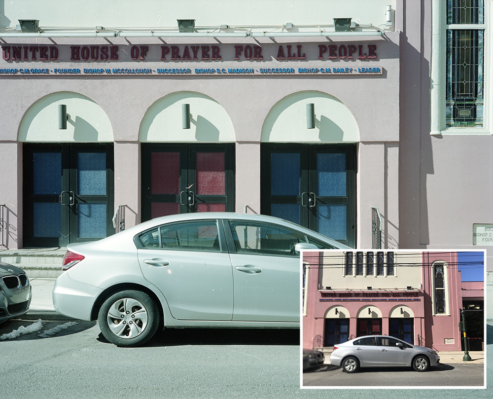

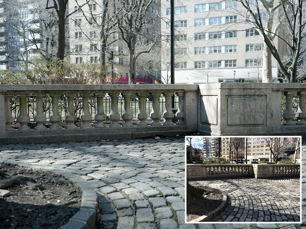

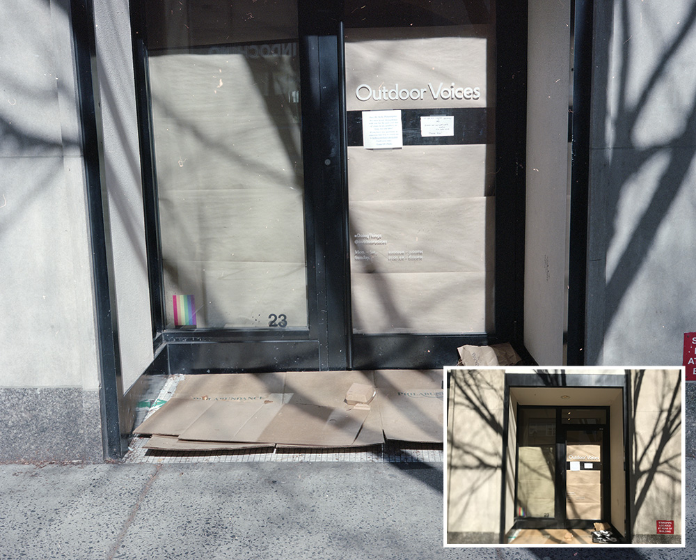

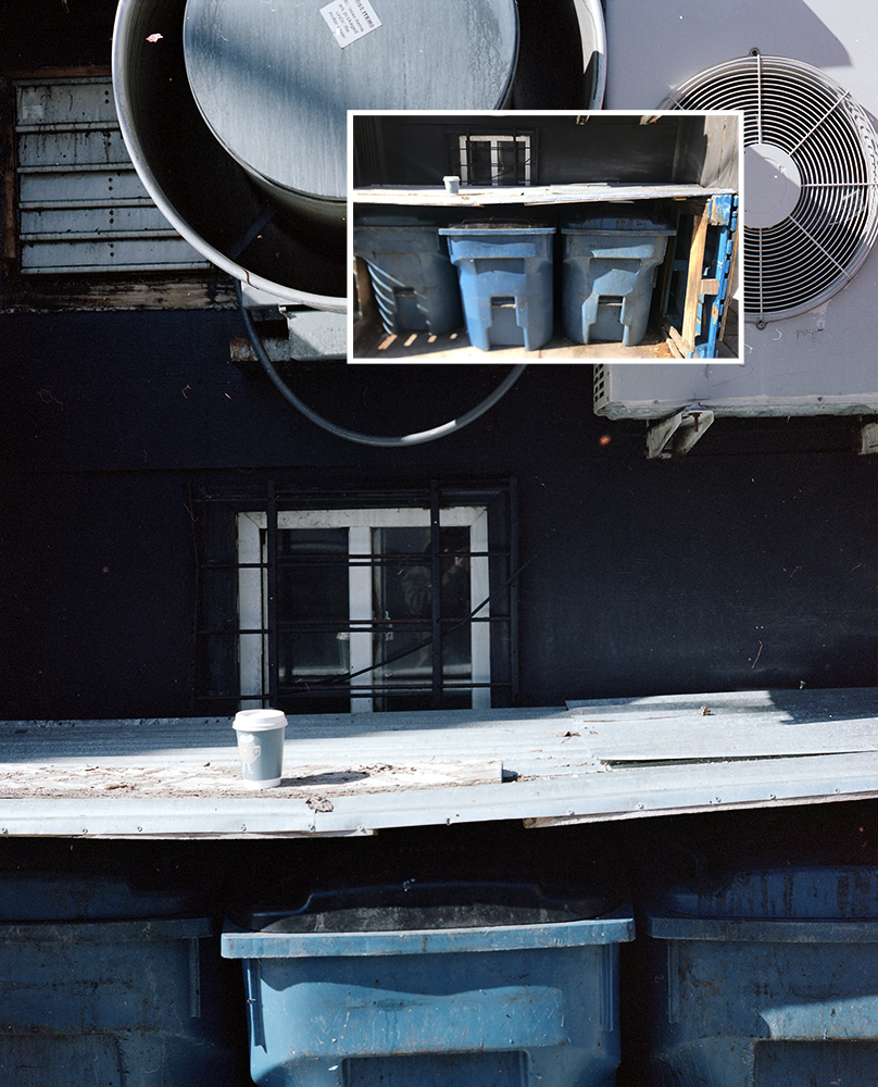

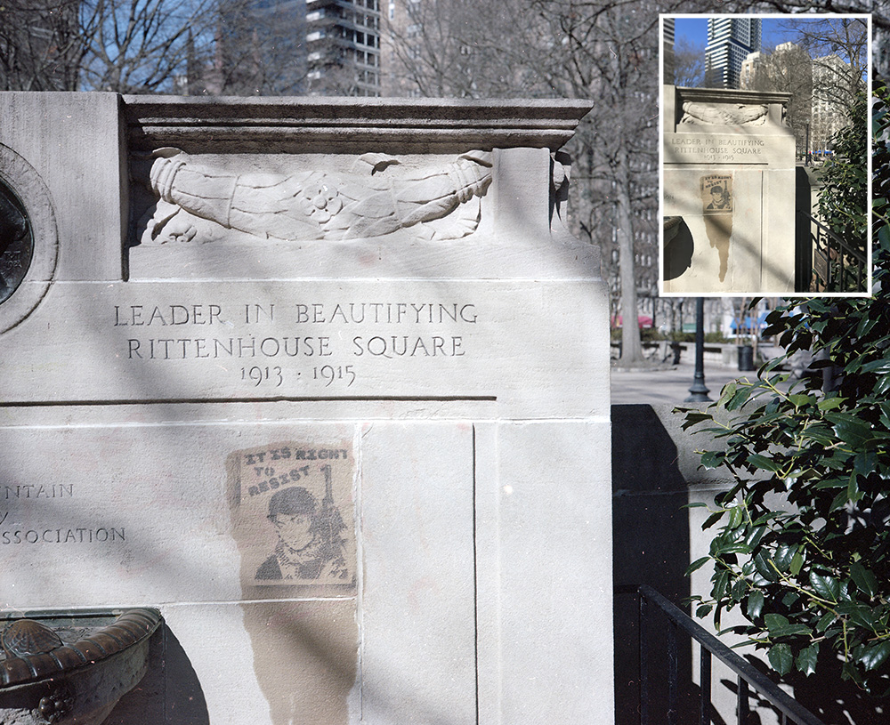

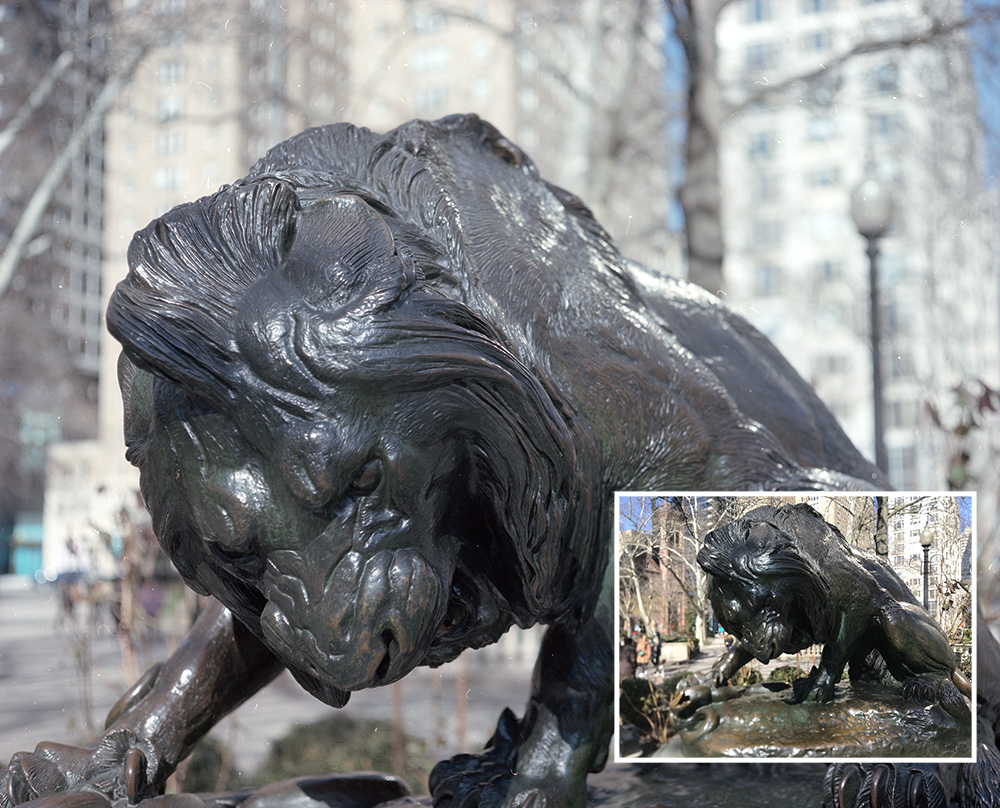

Update:
The color checker thing was a bust. The software and documentation that makes it work are woefully out of date (which means non-functional out of the box) so I sent it back. Ah well.
I did an experiment though that I'll share here. I exposed a roll of Portra160 and had it professionally developed. After each shot I also made an image using my iPhone. I scanned the film using Epson Scan/V700, 48 bit color positive with no color correction. Using Photoshop I inverted the image, and found the white, black and grey points. The images looked close to what I remembered the colors to be, but I then superimposed my iPhone pics of the same images. The inset images are from the phone.
(I'm not sure what happened with the House of Prayer image above, but the film image is way off.

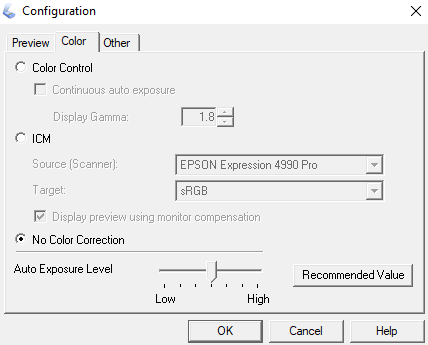

@warden that clearly didn't pan out very well. I'd start by applying the same scan settings and curve adjustment to all frames. You've now attempted to color match on a frame by frame basis and thus, you end up with severe color casts depending on subject matter (the House of Prayer, e.g.) It's best to scan all frames in one go using the 'film area guide' setting - which I hope is still available on the V700 series.
Just to be sure, this is the setting I use for this purpose on my old 4990:
Note that by default, the option is set to "Color Control".

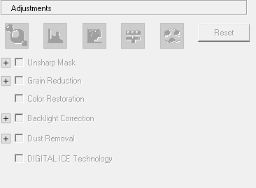

The adjustment controls in the main dialog window should be all disabled like so:
If these options are still enabled/accessible, the scanner will still apply automatic color correction to an extent.
My workflow is to take the settings as shown above, scan all frames using the 'film area guide' setting - I usually need to do this in two scans to get the entire roll scanned, but since the color controls are disabled, the output will still be consistent. This is vital!
I then color balance one or two representative frames by whatever means I've decided should work for the purpose. Usually I do something like this: https://tinker.koraks.nl/photography/flipped-doing-color-negative-inversions-manually/
Once I'm happy with the curve adjustment, I apply the exact same curve adjustment to all frames. This will get me close or right on the money, cloror-wise, for the entire roll. Final adjustments can be made to taste on individual frames, but at least this gives me a solid basis.
Note how your iPhone shots have a whole slew of digital manipulation applied to them, including brightness-dependent contrast adjustments, artificial warming of colors especially in low-brightness areas etc. This is the reason why they look so nice, but "nice" and "natural" aren't the same thing. I assume that in your CN scanning exercise you first want to establish a baseline that's as close to the real thing as possible. An iPhone is a poor benchmark for this; I'd sooner rely on a dSLR in RAW mode - even that will skew the results, but it'll be a lot closer to an accurate representation of reality.
