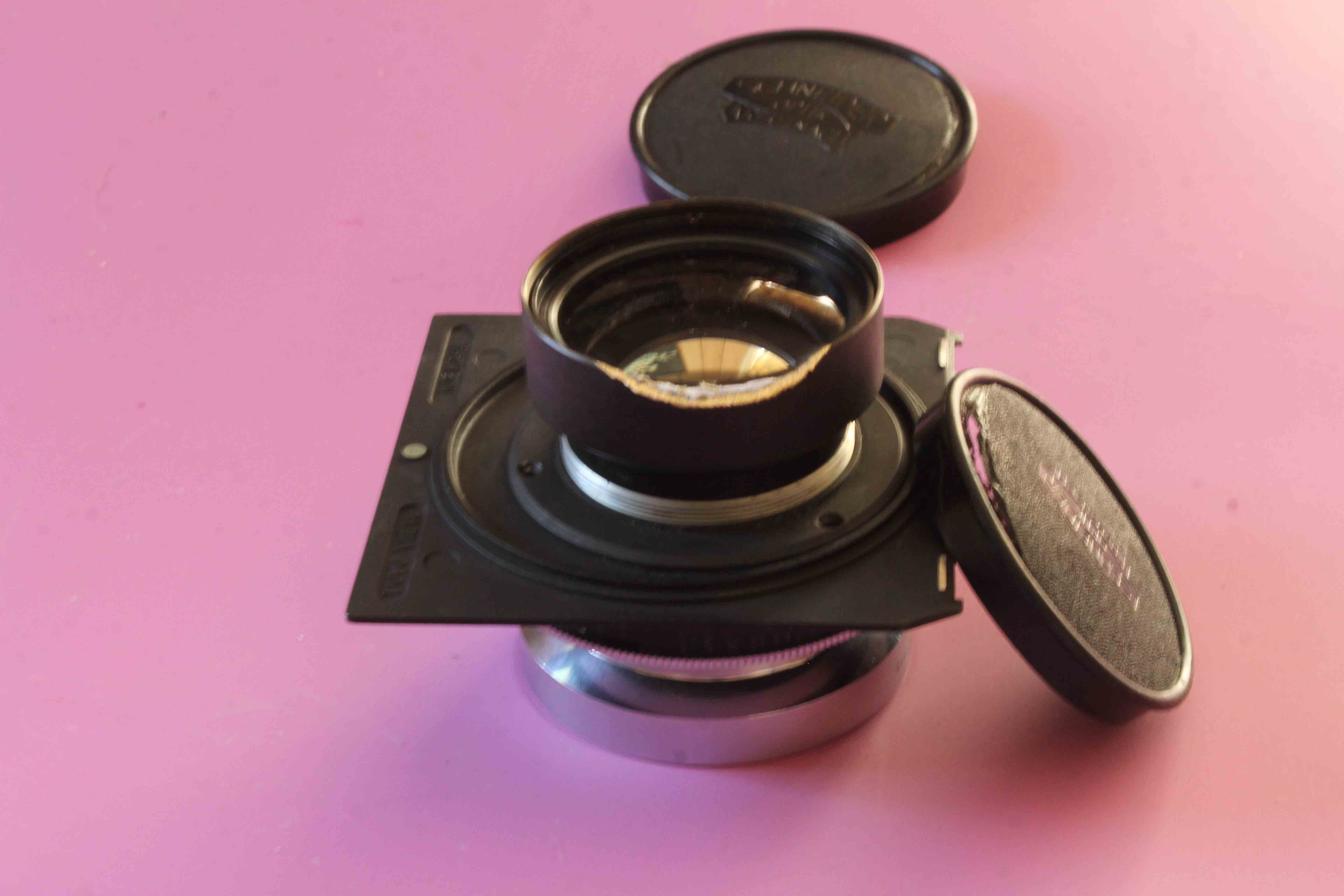

After all this time waiting for the lens to arrive, the original package was damaged so it was reboxed and sent to me, only to be shipped back to the carrier and then shipped to me. Prior to arrival I received an email saying the lens had been damage in transport. When it finally arrived today the rear element had been badly damaged and the Shutter refused to work as it is stuck in a half open position. I am now awaiting for a refund. This really sucks. I hope this part of the process is somewhat quicker so I can track down another lens. I have just made and fitted a new bellows. It seems like I will never get to test it out.
Just a bit of an update, I got my money back and I have had a closer look at the lens. I filed the damage part away and the lens element looks ok. Now for the bit that is not so easy, the non functioning shutter. It needs to be stripped down and the whole mechinsim cleaned and the excapement removed and lubricated. I looked on youtube and I can do this but time is against me at the moment.
