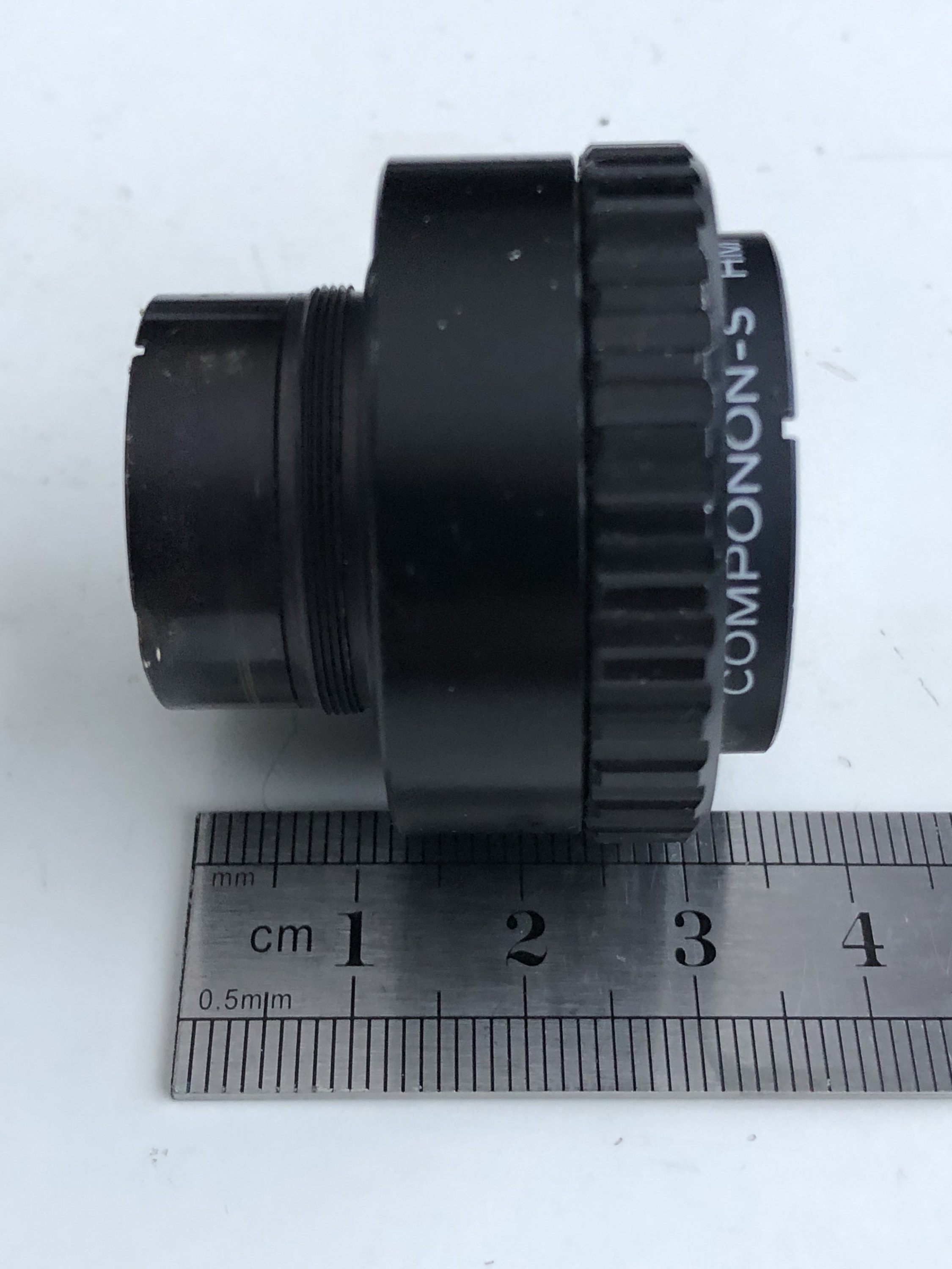

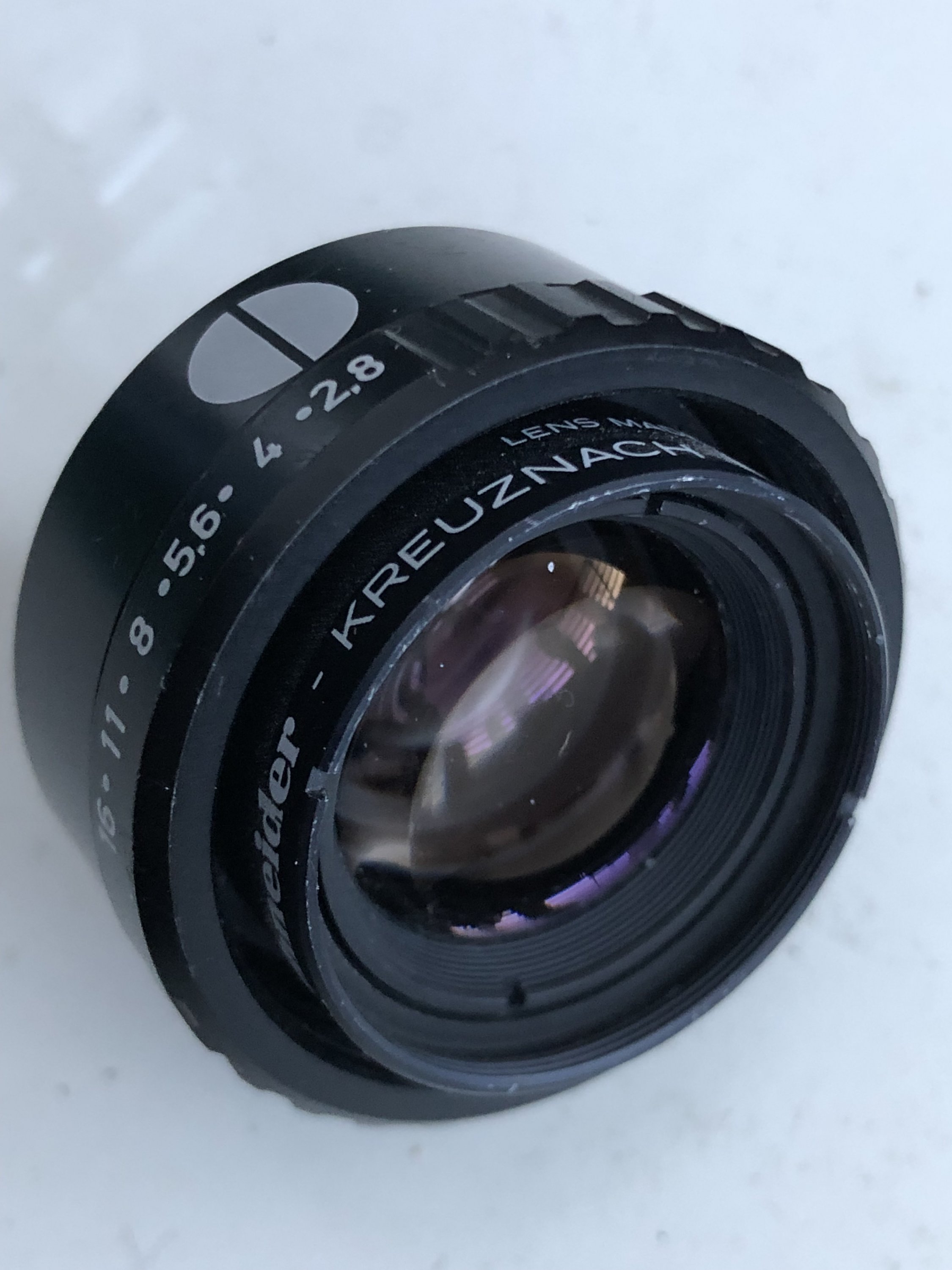

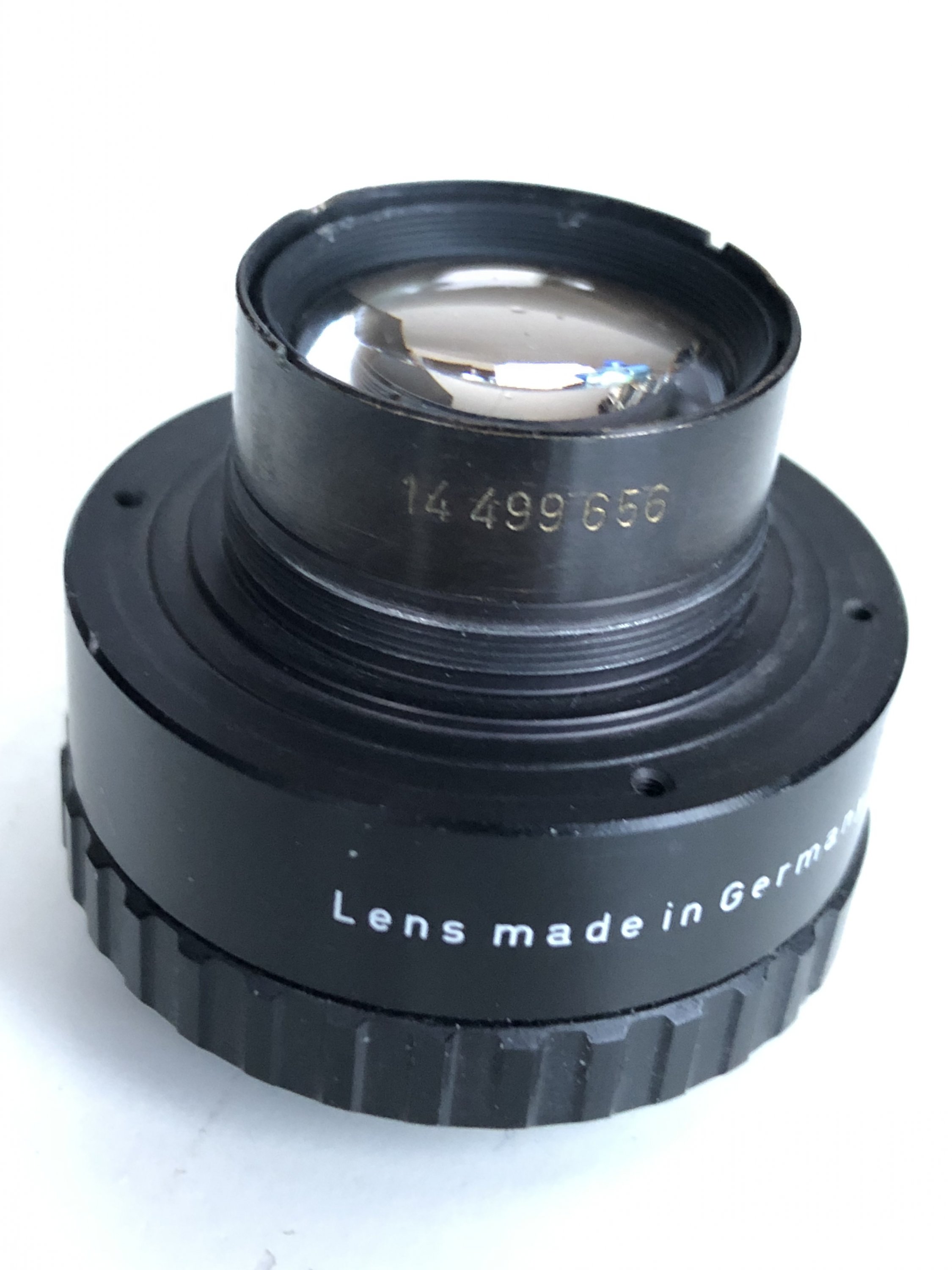

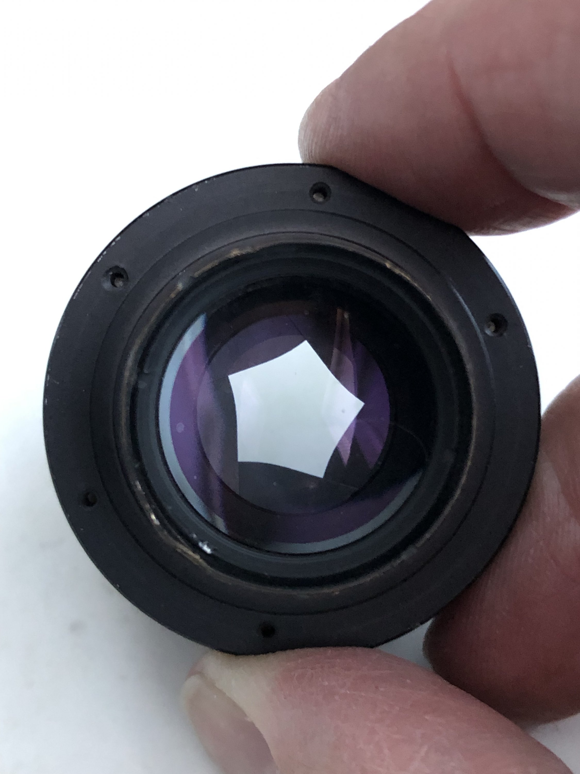

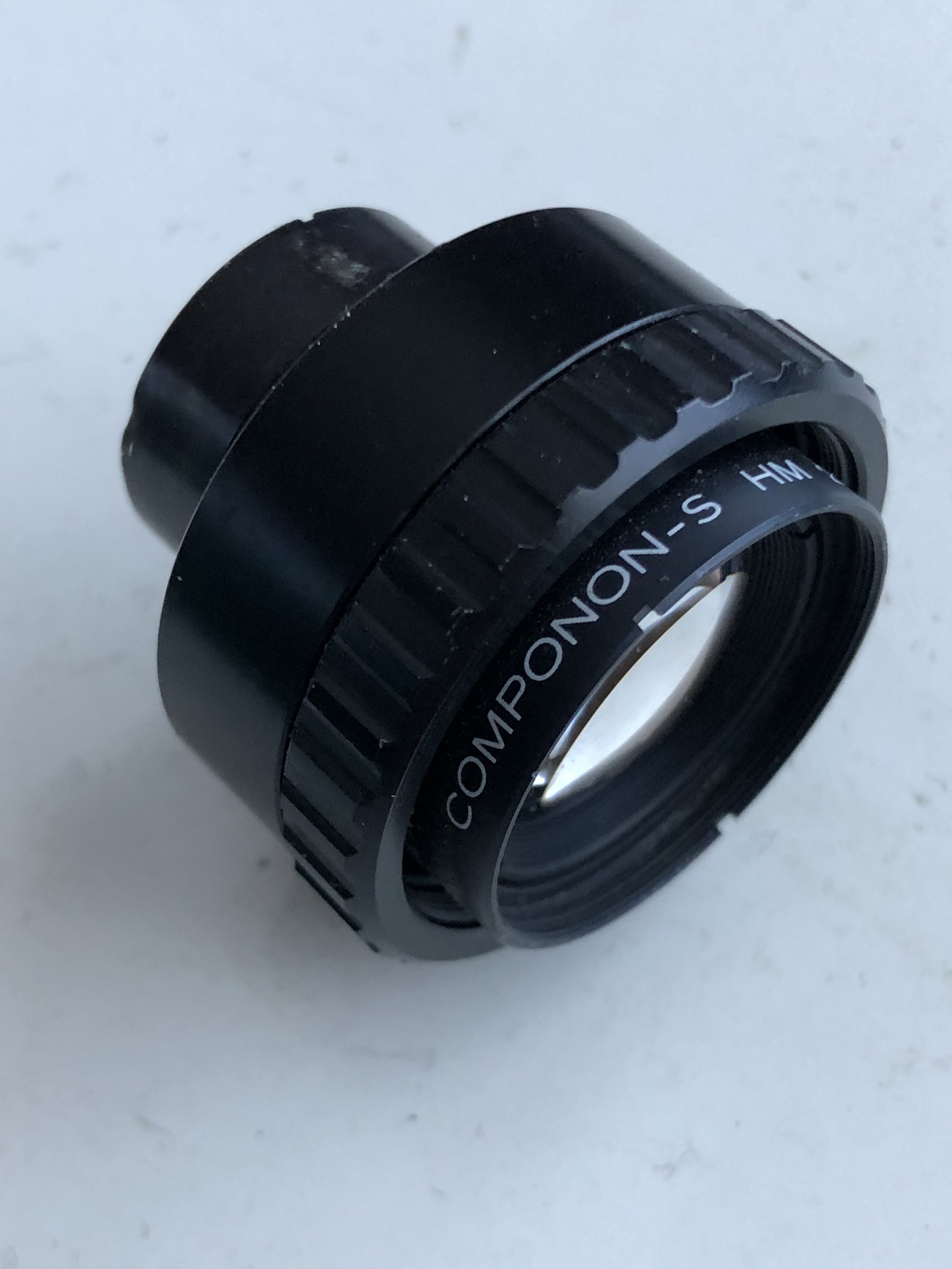

Good news: my Componon-S HM 50mm 2.8 just arrived. Photos attached. I have only had a very brief look at images projected at about 10x and 20x magnifications onto the baseboard through my Peak Focus Magnifier and it looks tremendous: grain sharp wide open right to the corners of the image with what looks like terrific contrast. Obviously this is no substitute for actual prints but I'll get onto that next week when I return from a trip. It's very small and has the old small 25mm mount for which fortunately I have an LTM adapter.

What a little beauty! I just finished testing the 5-element V2 vs 6-element V3 - would be great to compare them with the HM sometime.
