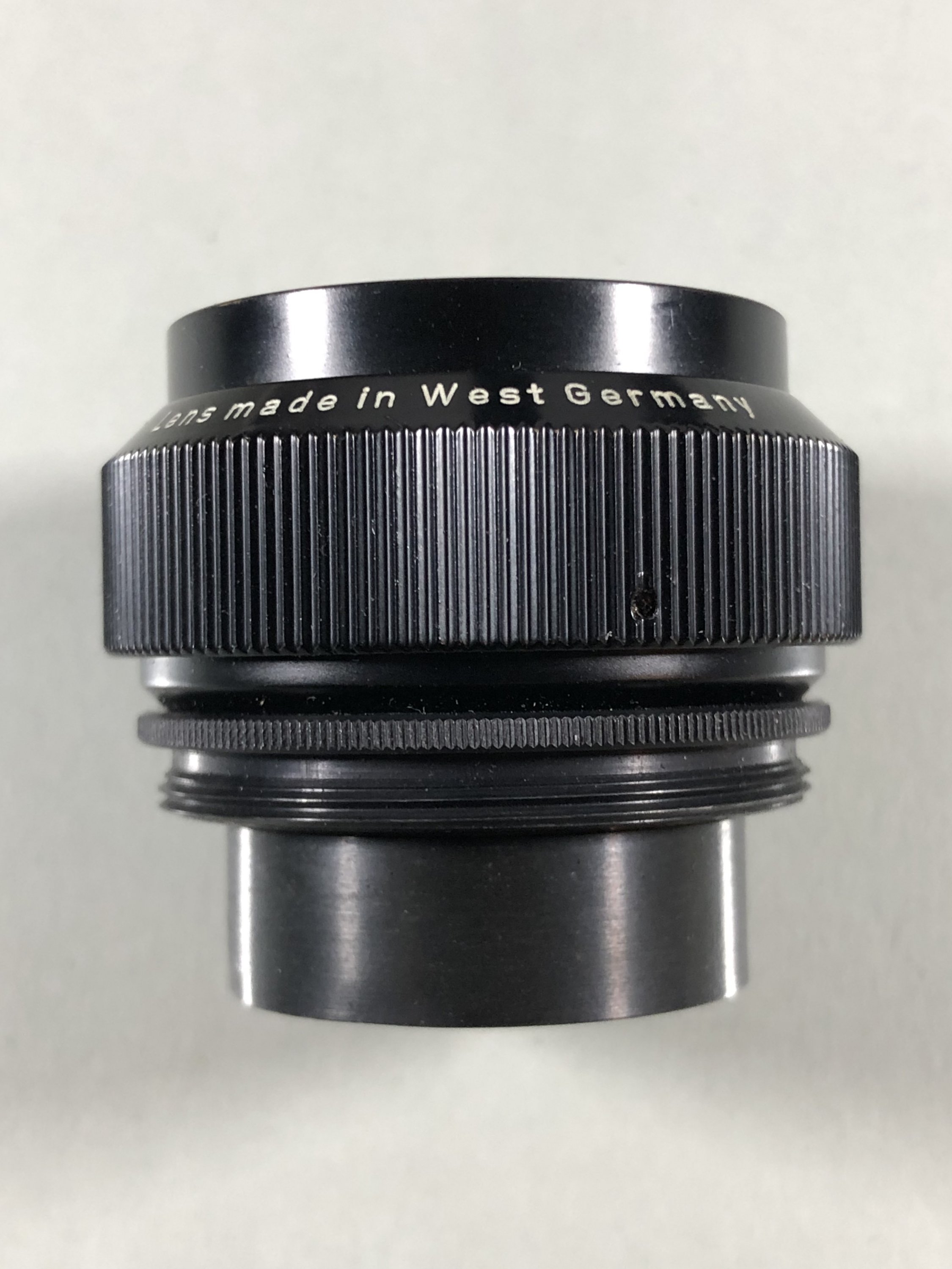

Compared to the example apbphoto posted, the barrel extends noticeably further above the serial number in the 6/4 more recent lenses. Your lens pre-dates both my example of a 5/4 and apbphoto's 5/4, so I'm not sure what's going on there...
I'll measure both lenses tomorrow & give more exact dimensions.
I had forgotten that apbphoto had included photos of his lens earlier in this thread. I just compared his lens to mine and they appear to be the same. So perhaps mine is a 5-element model as well.
If it looks near identical to apbphoto's then it's a 5-element, the one I have at home is a 5-element and looks identical, the ones I can check tomorrow are all six-element and have a quite noticeably deeper rear group barrel.

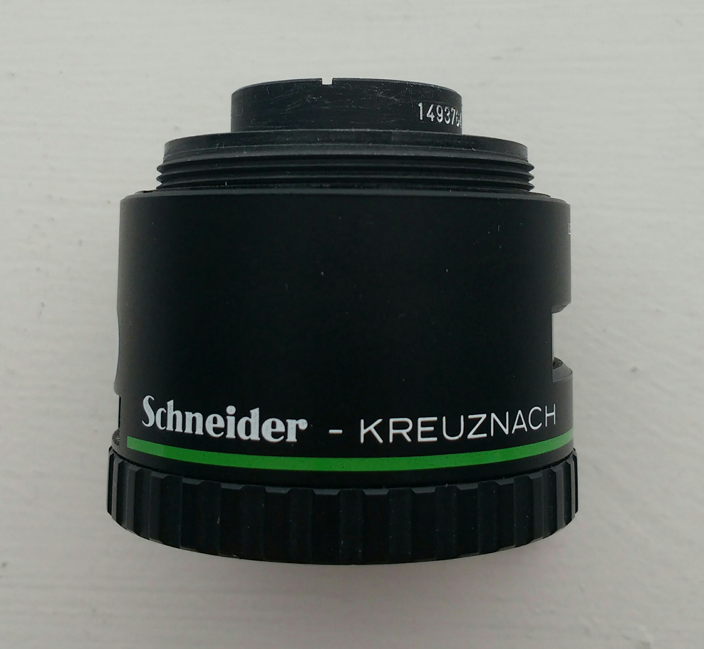

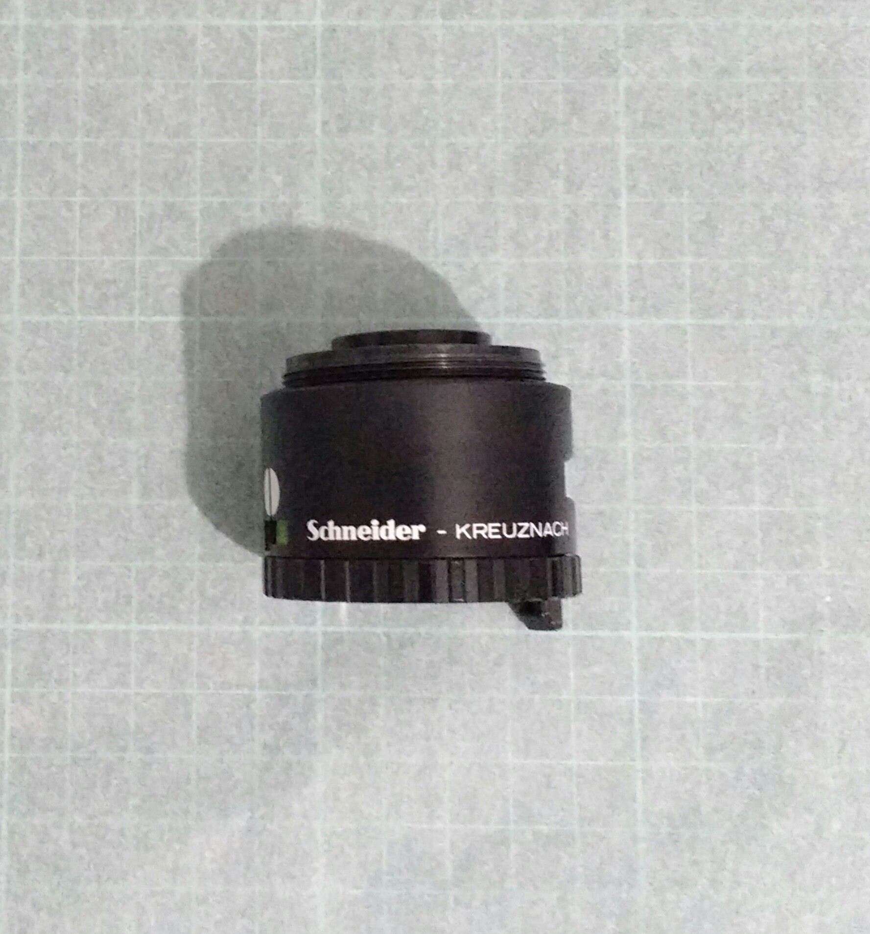

I've attached an image of a 6-element 50mm Componon-S.
EDIT: have added a 5-element from approx same perspective. Should show the differences.

There are two optical versions of the Componon-S 2.8/50, a 5 element in 4 group version and a 6 element in 4 group version.
The 5/4 versions are the No.10146 and the No.14849 (see http://photocornucopia.com/archive/81/cpn_s.pdf), same optics, different bodies.
The 6/4 version is the No.16828 (see http://photocornucopia.com/archive/75/vergroesserung_e.pdf). The change took place in 1992 according to Schneider (from an email from the Schneider Product and Market Specialist in 2019).
I wasn't given a serial number to distinguish the new version. I think the serial number of the No.16828 is around 145xxxxx million and higher (possibly as low as 14.460.000), give or take a bit. See the table below from Schneider (from their web site c. 2013) showing serial numbers and years manufactured:

Note that the body length on the No.14849 (similar body to the No.16828) is 38.0mm (h1 in the spec sheet linked above) and the body length on the No.16828 is 40.8mm (h1 in the spec sheet linked above) This is a certain way to tell the difference in those cases where the serial number does not.
The latest version normally (but not always) has a green band all the way around the body of the lens but I think there are versions of the No.16828 without the green band (based on what I've seen on ebay).
Example of No.16828 https://www.ebay.com.au/itm/Schneid...239952?hash=item26413c7b10:g:cIEAAOSwoQ9fGWkV
I think this is a No.16828 but not certain https://www.ebay.com.au/itm/Schneid...543176?hash=item1f139561c8:g:LB0AAOSwR7JfGWs4

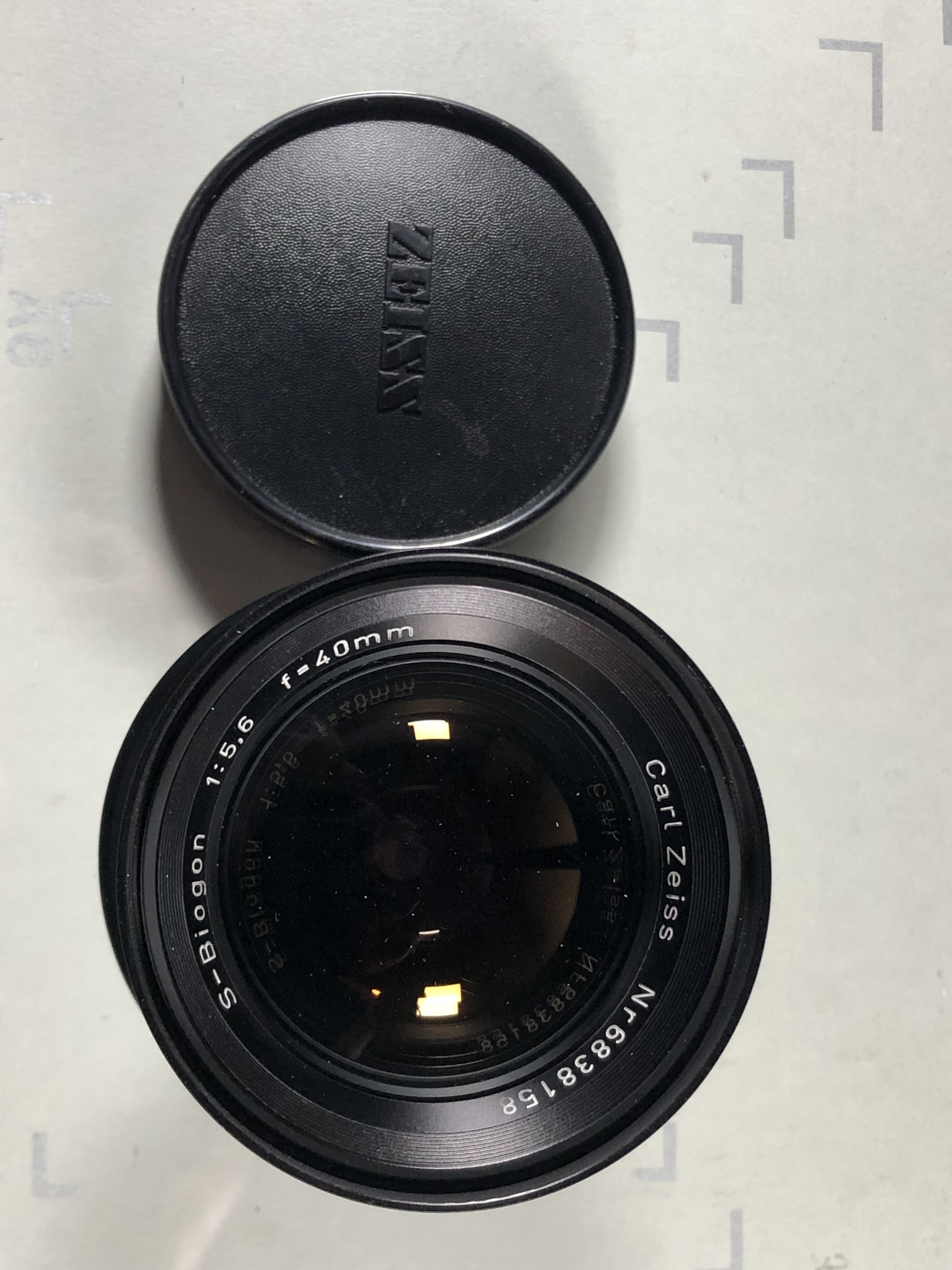

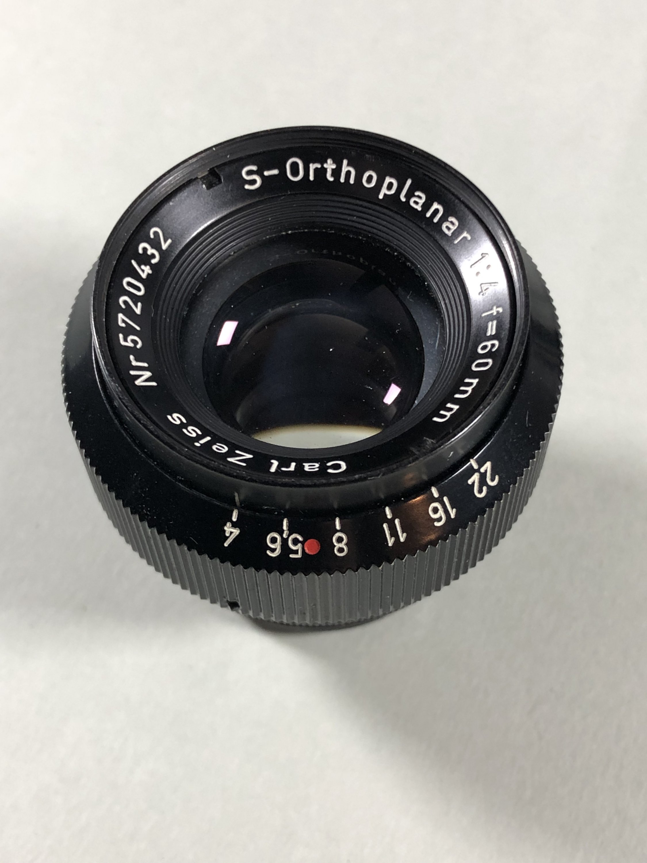

I should probably not have shared the photo as it was from the seller but am happy to show more when I have the item in hand. As for the S-Biogon (I have two!):
6838158, 6832111
The S-Orthoplanar (not the less glamorous Orthoplanar and not the possibly superior 50mm S-Orthoplanar either) is:
5720432
These are roughly identical in performance and only show their mettle in high mag ratios: they are designed for x8 - x30 range for the S-Biogon and x10 - x30 for the S-Orthoplanar. I suspect that for my uses they are aced by the Apo-Rodagon N 45mm which is optimised for x15 and a range of 5x - 30x. i.e. somewhat higher magnification than the 50mm's 2x-20x and 10x optimum. I understand that it is likely that only the lenses designed as enlarging lenses will have the correct wavelength weightings for optimum results on photo paper so whilst the fancy S-Biogons etc may have spectacular MTF and resolution they won't always better proper enlarging lenses. These microfilm-optimised lenses may favour a different part of the spectrum. Ctein and others have proposed that the near UV is problematic for enlarging even with lenses supposedly designed for this as it is enough to make for fuzzy images. I see that Schneider (and maybe Rodenstock) on their data sheets divulge the weighting for different parts of the visible and invisible spectrum of their lenses so it is a concern. I'm not sure if I have the brainpower or patience to jump down that particular rabbit hole!
5720432
The serial on my 60mm S-Orthoplanar is 160ish above yours. I have always been curious how the Biogon and Orthoplanar compare. Any thoughts? Just curious because I doubt I'd buy the Biogon. I never even use the Orthoplanar any more since I mostly enlarge 35mm with a Focomat 1c. I use a Nikkor on that usually because of the contrast, but I swap it out with the plethora of other lenses I have. I really need to just sell off most of them. No point in having all of them. I do want to pick up a 5 element Componon-S though. It was my first enlarging lens back in the day.

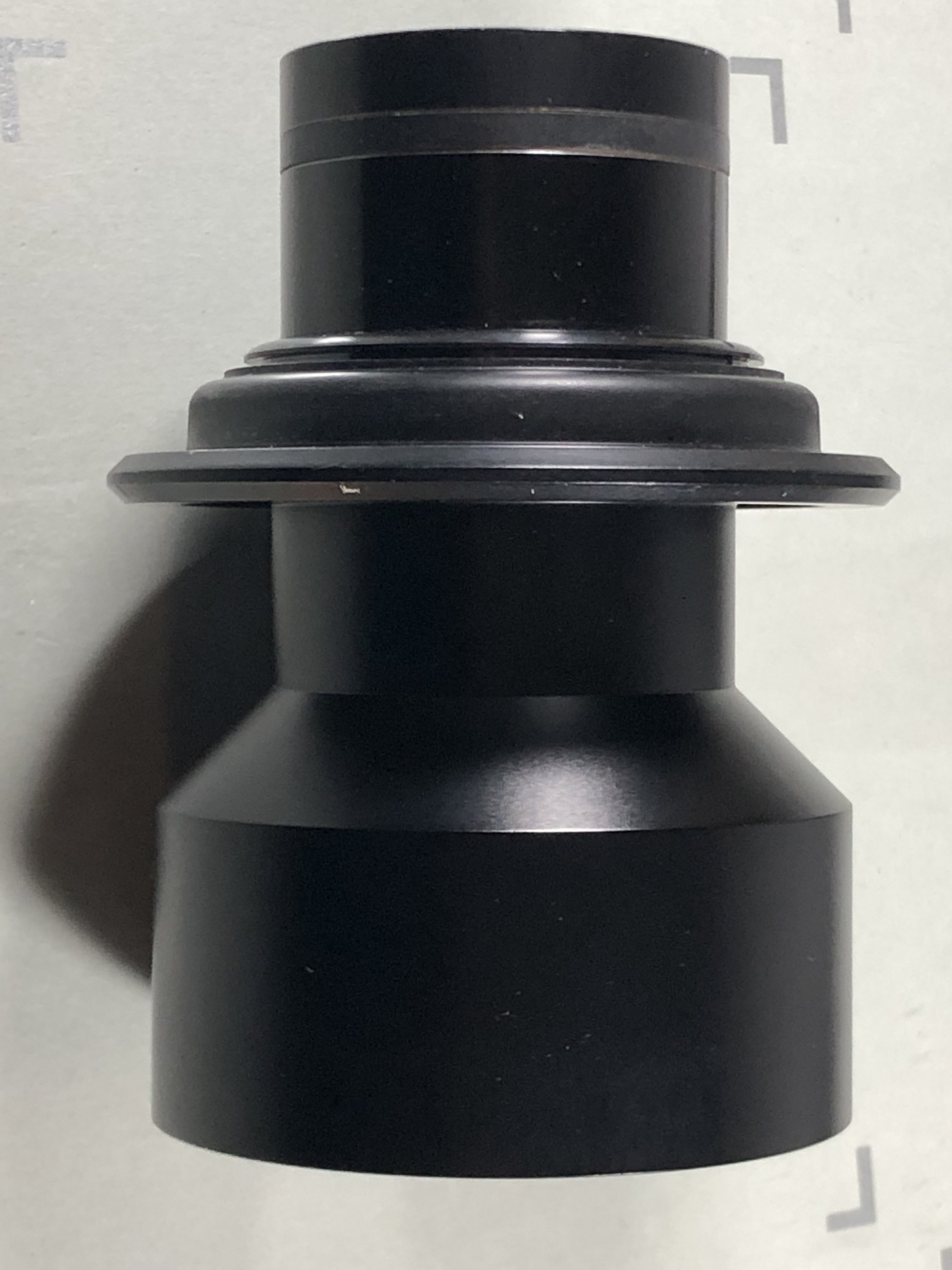

Some pix of the S-Biogon and S-Orthoplanar
