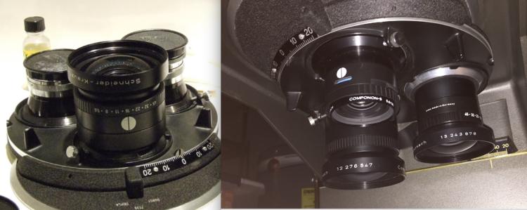

In 2020 I finally completed re-doing one of my turrets with clean lenses. Not something I'd want to do again. Took a few years to find all these lenses in pristine condition at a reasonable price. Can't say I have ever seen anything other than poor condition enlarging lenses in person at Photorama or any brick store either. Maybe it is a regional thing. Locating the lenses on the internet was just the beginning, then I had to track down the Durst mounting plates specific for the lenses.
150mm silver Componon (some scratches , some haze) -> Like new 135mm Componon-S
210mm silver Componon (some scratches, some haze) -> Like new 210mm Componon-S
240mm Componon-S (many scratches, otherwise clear) -> Like new 240mm Componon-S
