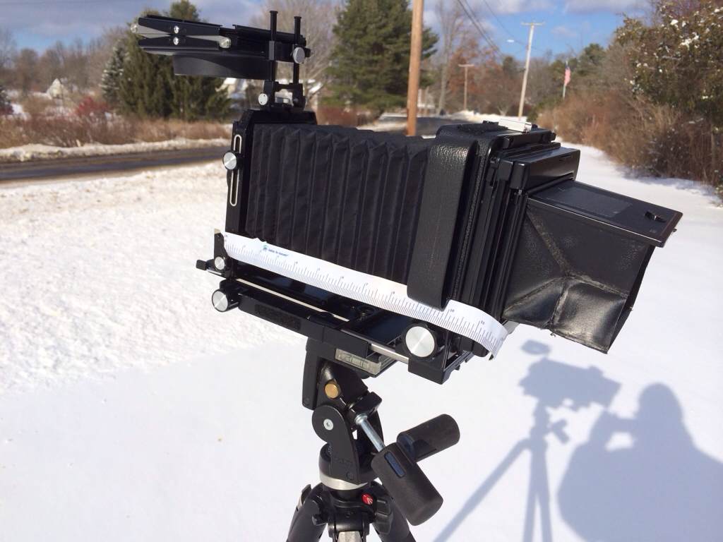

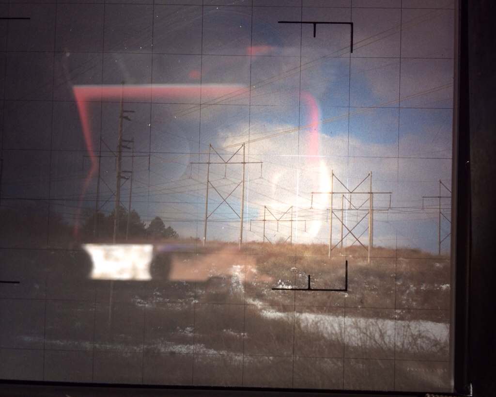

Here... Cause I actually back my shit up....

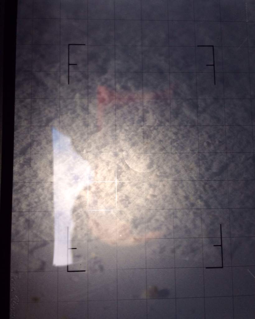

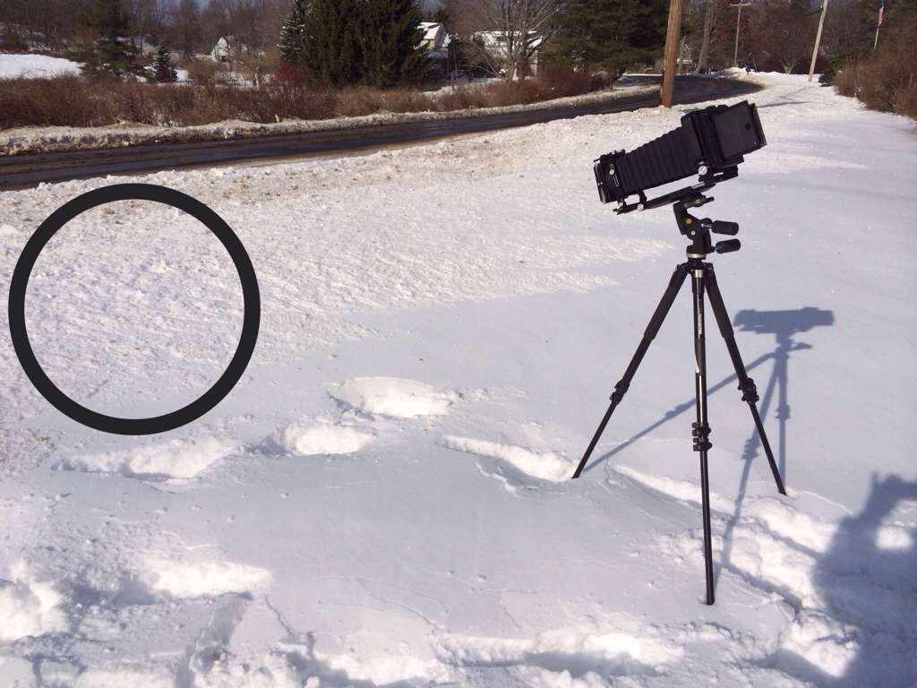

Closest I could focus... See image and circle of area in focus
Ground glass... Reversed for easy viewing...

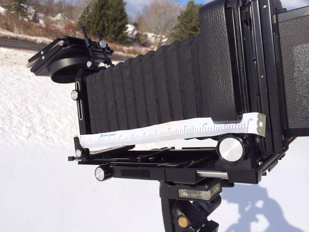

Ruler....
Close up...
That's damn close....

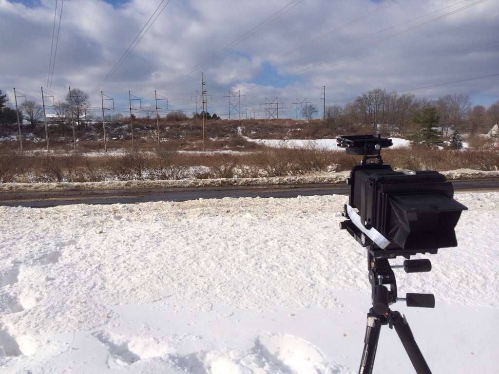

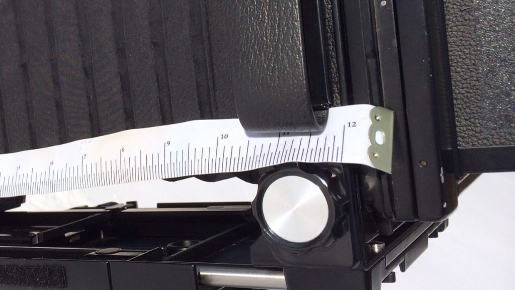

Second... At infinity...
GG (reversed for easy viewing)
Ruler...
Close up
Ok??
10 inches at infinity....exactly 254mm....
Give up, Stone. It's been explained to you several times by several people. Your measurement appears inaccurate, BTW. You should measure from the front of the lensboard -without the lens - to the inside surface of the GG. This measurement would giive you the flange focus, not the focal length. You need to look up and understand the difference between these two terms, you will then be less confused. Drew might refresh his memory as well...
