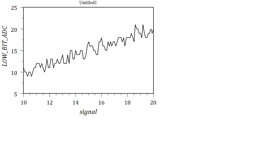

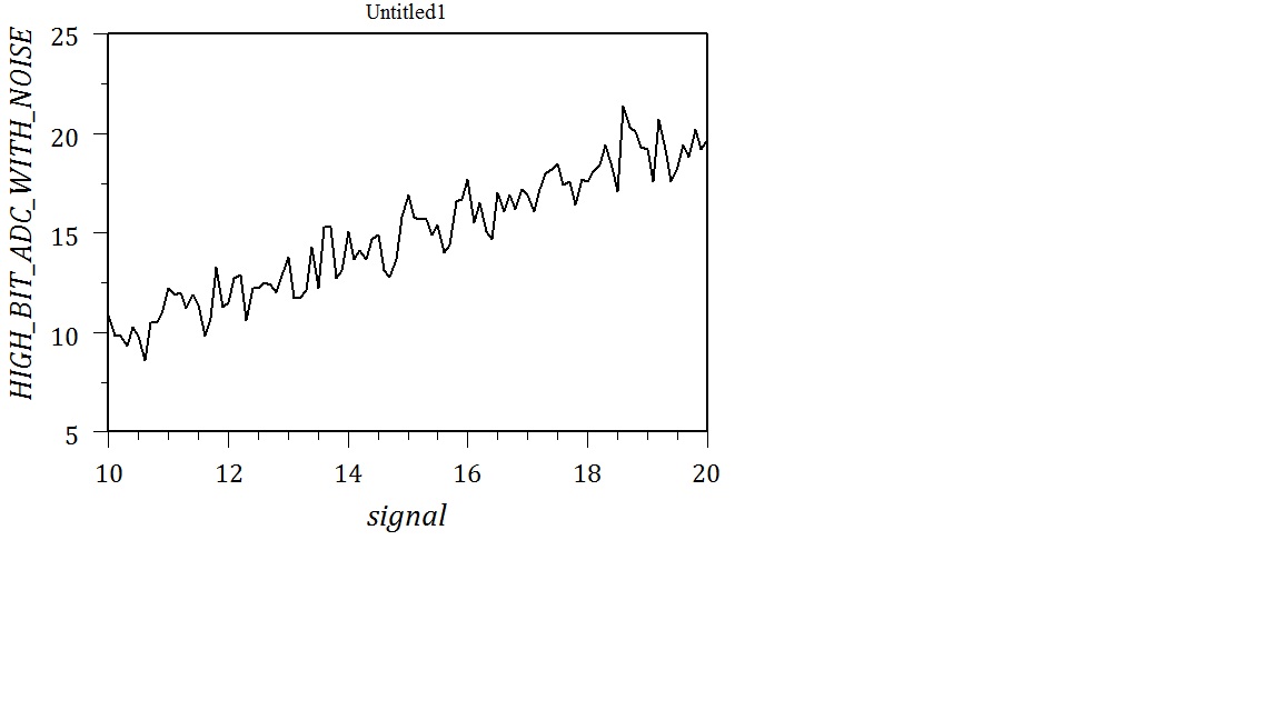

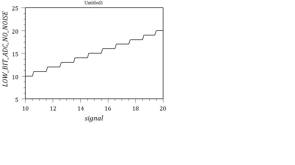

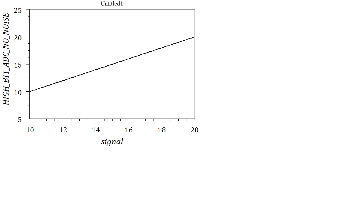

I have calculated numerical simulations of a one dimensional signal. There are four cases. The images show a portion of the signal (a linear ramp going from 0.1 to 100 with a step size of 0.1, a dynamic range of 1000). The first would be the result of an ADC with a step size of 0.1 signal units. The result is a smooth ramp. The second is the result of and ADC with a step size of 1 signal unit. The result is a staircase. In a two dimensional image this would be show up as banding. The third and fourth graphs are the result of adding a random signal (Gaussian distribution) with a standard deviation of 1 unit. The third graph is the result of an ADC with a step size of 0.1 unit. The result is a smooth ramp with a little bit of noise superimposed. The fourth graph is the result of and ADC with a step size of 1 unit. The result is a smooth ramp with a little bit of noise superimposed. The difference between graphs three and four is negligible. In an the case of an image neither would show banding. They would both show a smooth ramp, albeit with a little noise superimposed. The amount of noise between the two would not be visibly distinguishable. Going from a low resolution ADC to a high resolution ADC would add no useful additional information.
I can add the following point. As noted above, the noise had a standard deviation of 1 step size unit for the low resolution ADC. One can even go to somewhat lower noise than 1 step size unit of the low res ADC and get a nearly equivalent result. However, when the noise is a small fraction of one step size unit of the low res ADC then the simulation of the low res ADC result will start looking like a stair step and in a real image it would the begin to show banding.

As regards dithering, your figures are an illustration of what I said re. the relation between quantification step and noise. Two remarks here: (1) Film grain can be considered as noise like in the good old days, or as part of the image which is the current trend. In the 2nd case, only take into consideration the noise of the scanner itself in calculating the required bit depth, or the grain will quite probably look awful on the scanned image. (2) In practice one can expect a gain of a bit or maybe two through dithering, not to make a 8-bit image look like a decent 16-bit image, that would be too good. So, although mathematically correct, theoretically interesting and widely used for other things, dithering is not an answer to the 16 bits vs. 8 bits debate - not even to the 12 bits vs. 8 bits debate (12 bits being roughly the useful bit depth of a good little scanner).
Conclusion: reducing to 8 bits will probably make you lose data no matter what you do to conceal the difference, OTOH scanning to 16 bits B&W files will be safe - and save space with respect to 3x8 bits colour too. And I think this will be the end of this thread as far as I am concerned: I have passed on all the useful information I have, and I am not at all interested in a war of egos :smile:
