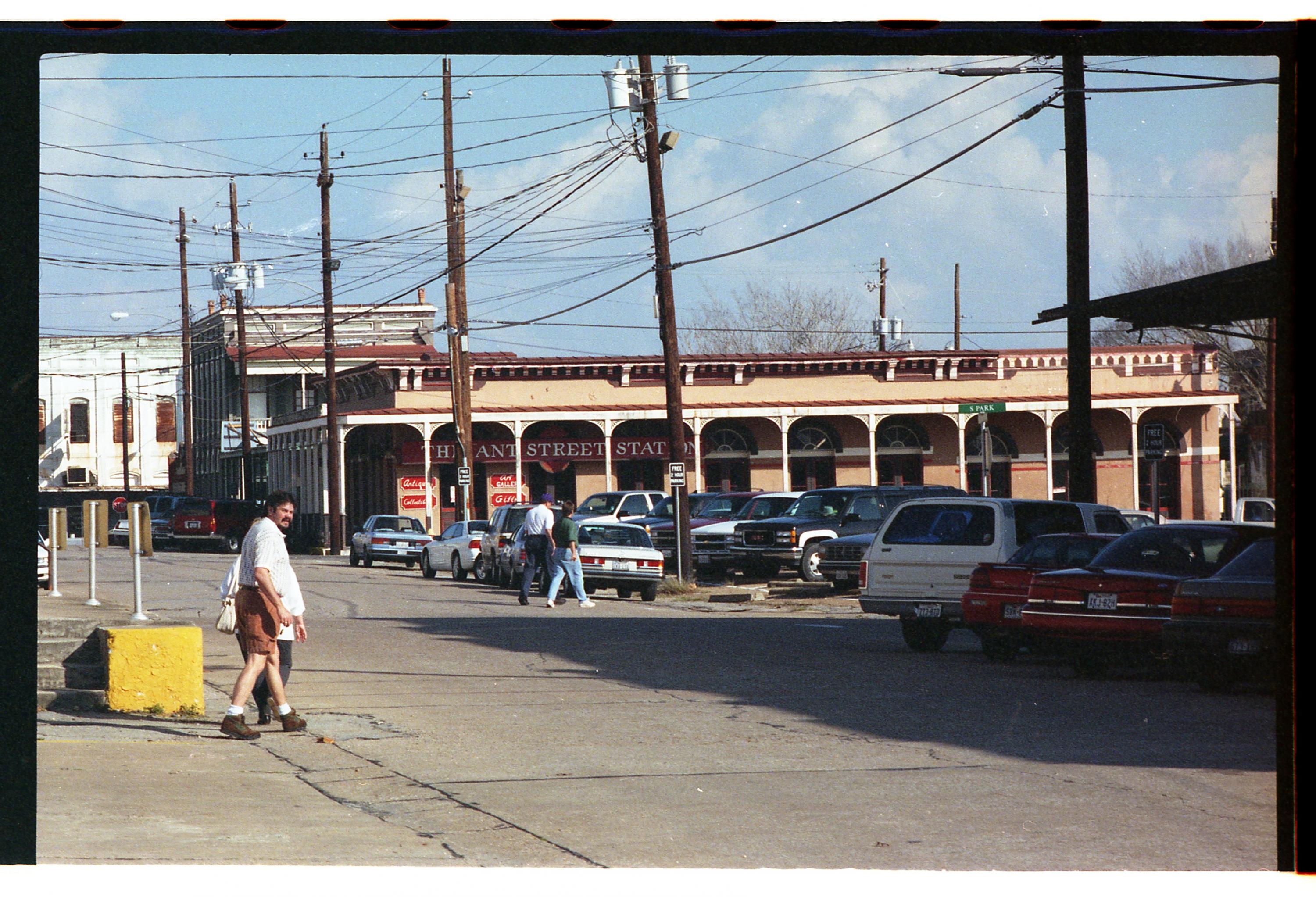

I have been using an Epson V 600 scanner for about a year and it just started doing this. Just wonder if anyone else has seen this or knows how to correct it. The scanned negatives have a black border around the 4 sides. Could it because the negatives have a side curl? I changed a few settings on the preview side a few days ago and wonder if somehow I did something to cause this. I will try to post an image that shows this problem. img--D040.jpg

Check the manual for pictures that go with the copied text below: You may be in thumbnail vs. Normal select mode. You may have to detect the area you want scanned using the marquee select tool.

If you are relying on auto cropping, have you experimented with the "thumnail cropping area" setting in the configuration dialog? That might help.

Thanks for the suggestion Doug. I've used the Thumbnail preview, but that means that every negative I scan has to be cropped in pp. I was hoping to avoid the extra editing.

Yep, in the end it is usually faster to do a batch scan of manual crops because the autocropping algorithm is just a guess that is often fooled. It takes a little more time up front to create a manual batch scan but you avoid the hassle of having to go back and compare to the originals to make sure you scanned the whole image and then doing the inevitable rescan or two or three.
