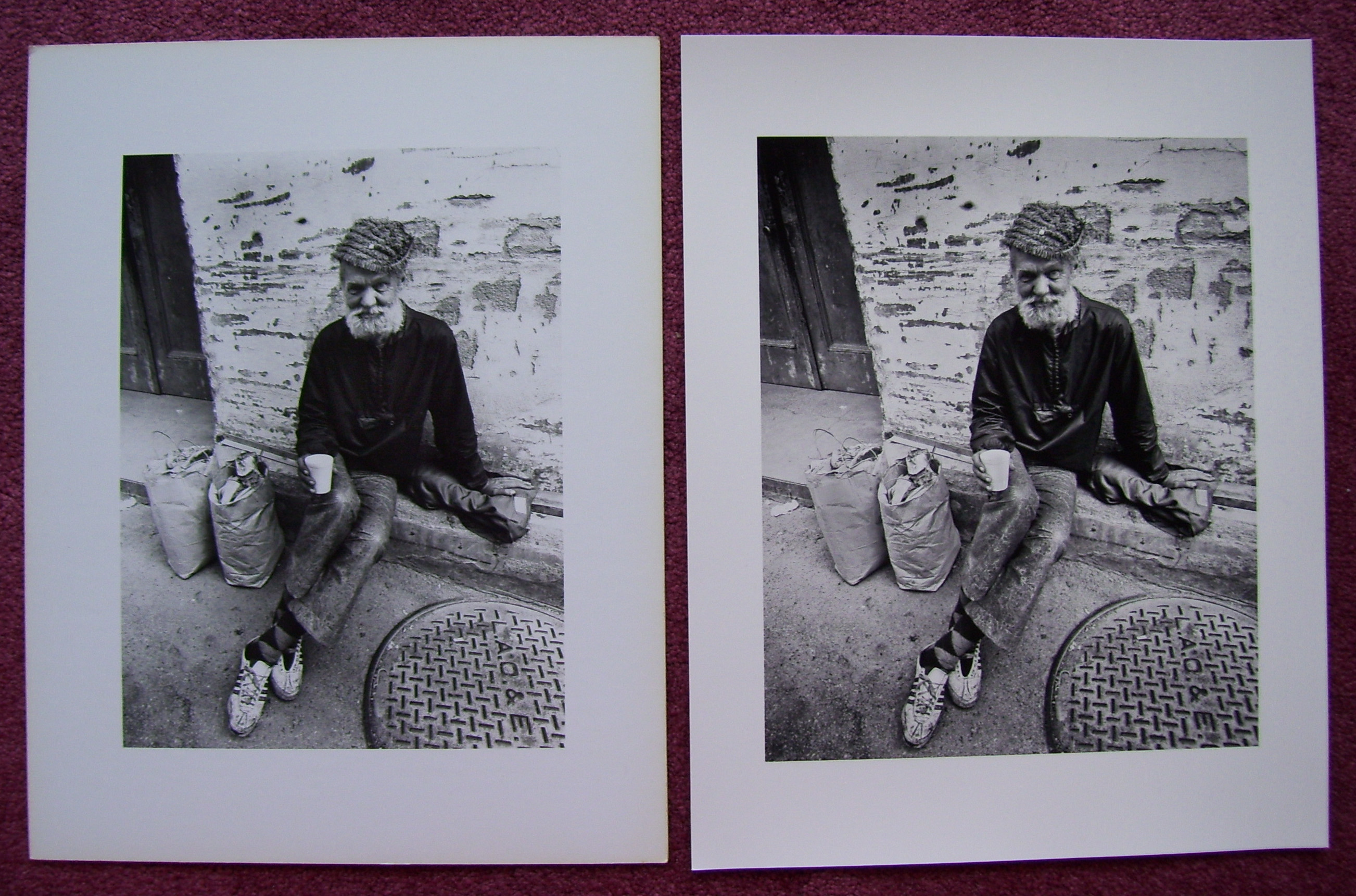

From the tests I have done, there is quite a difference between a scan and a print, although it doesn't really show up until you print larger. Scanners do not image the grain in spite of what everyone blathers on about on the interwebs. I chuckle when people say that their Epson scans the grain. Ain't even close.
Here is an image of a scan from a Nikon 4000 at 4000 dpi compared to a scan of a print matched for size. You can clearly see the difference. Of course this would be something like a 26 or so inch print, but you can clearly see how a darkroom print done right looks like. I think this is a 400 speed film IIRC, so something with less grain would be even more dramatic I think.
Again though, it just depends how big you are going to go whether or not you will actually see a difference. I can't really talk about color prints, although I've seen some extraordinary Cibachromes and I haven't seen a digital print that was the same. I couldn't qualify why though since I am not experienced with color printing in the darkroom and it has been a while. I suppose it would be similar to black and white. If you ever get the chance, look at a Christopher Burkett print.
Here is the comparison image. Neither side is sharpened or manipulated. If you download this image and shrink it in Photoshop you will see that at a certain point it won't matter-

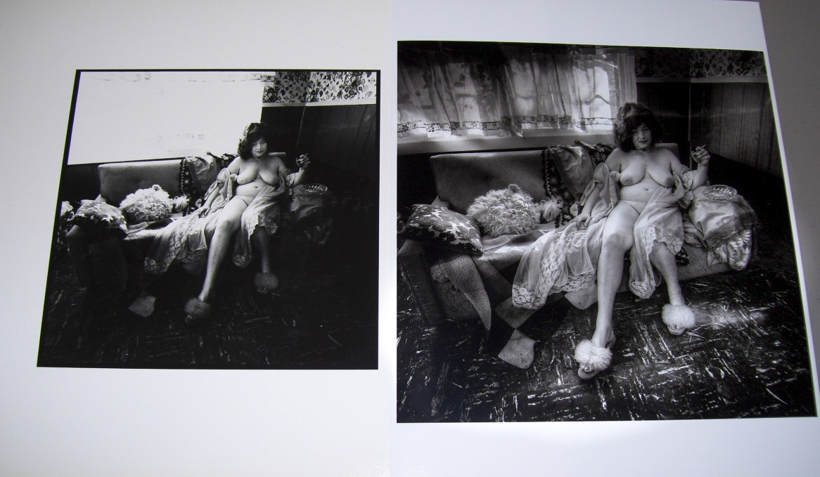

Here are 2 examples of wet vs digital. One with a terrible neg, one with a good neg.
Above: Vintage wet print left, digital print with 2.5 hours of L.R. right. Only light in the room was the window.​
I made the wet print when I was a teen in the 1970's. If I made it now I probably could do better, but I could do nothing close to the digital version. You can't translate 2.5 hours of L.R. to the 20 second exposure of the wet darkroom. Sure you can add masks, but it all degrades the image.

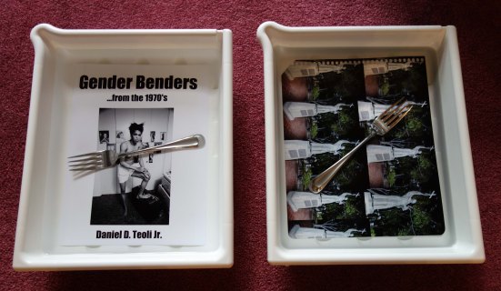

Inkjets have their downfall. They are susceptible to solvents ruining them. They have good water resistance when cured. They are not as good with water as silver prints, but are about 85% to 90% as good with water. (generally speaking when we are talking about just soaking inkjet prints in water.)
Above: Day 5 of water submersion tests of inkjet prints.
RC inkjet do better in water than fine art inkjet, but the fine art inkjet still does remarkably well once cured.

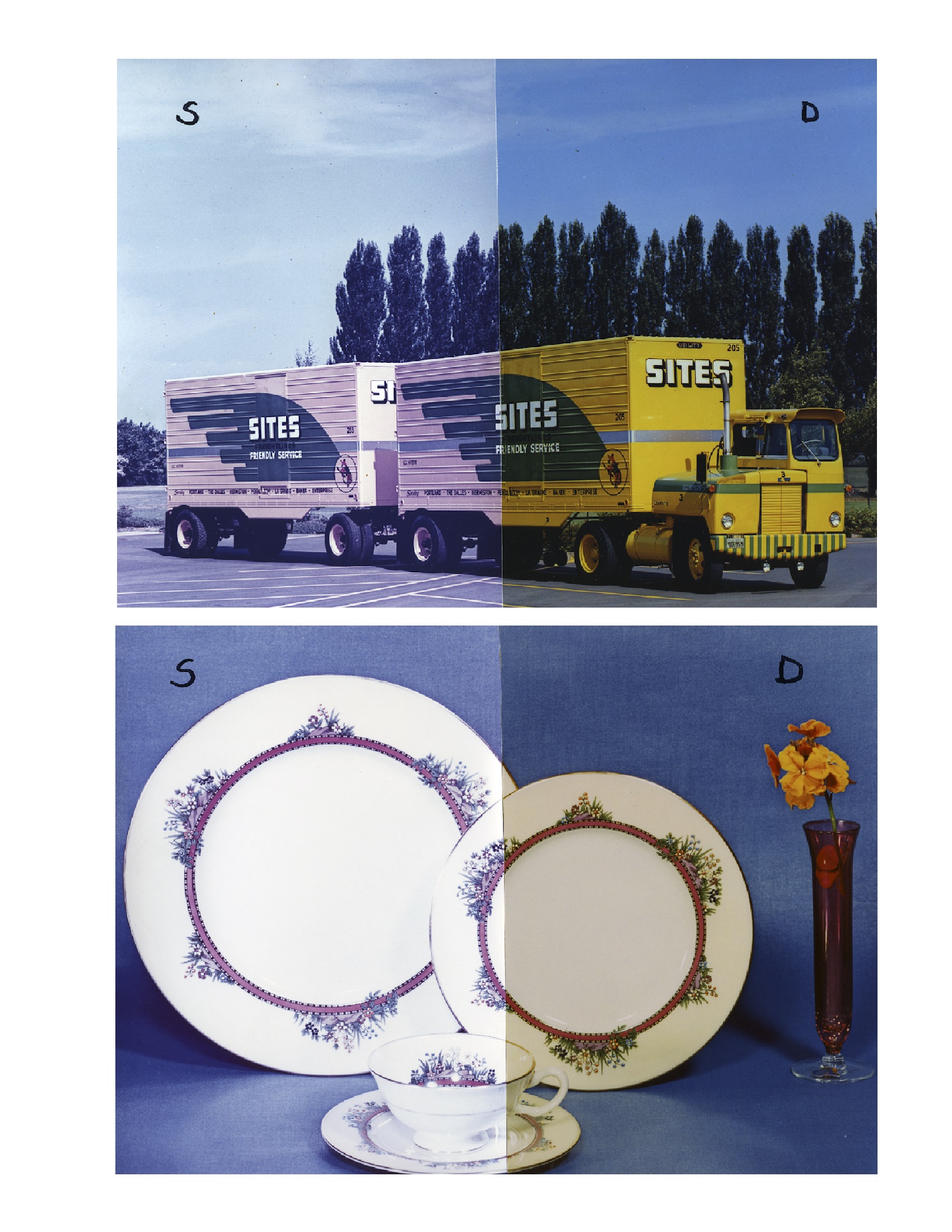

Eastman_Kodak_dye_transfer_fade_test_after_6_months_sun_exposure_Daniel_D._Teoli_Jr..jpg
Above: Eastman Kodak dye transfer fade test from 6 months of sun. 'S' = sun for 6 months 'D' = dark storage​
Fuji 'C' prints are not as good as pigment inkjet prints for fading, but are about 85% to 90% as good. Fuji 'C' can be considered as pretty archival as long as not displayed in light all the time and generally on par with lower level pigment inkjet prints. Metal prints are about 75% - 80% as good as inkjet for fading. The top Cibachrome material was excellent for fade resistance. A dye transfer print should never be displayed long term. Just take it out to look at it and display a copy of it. Dye transfer prints will fade in normal room light.

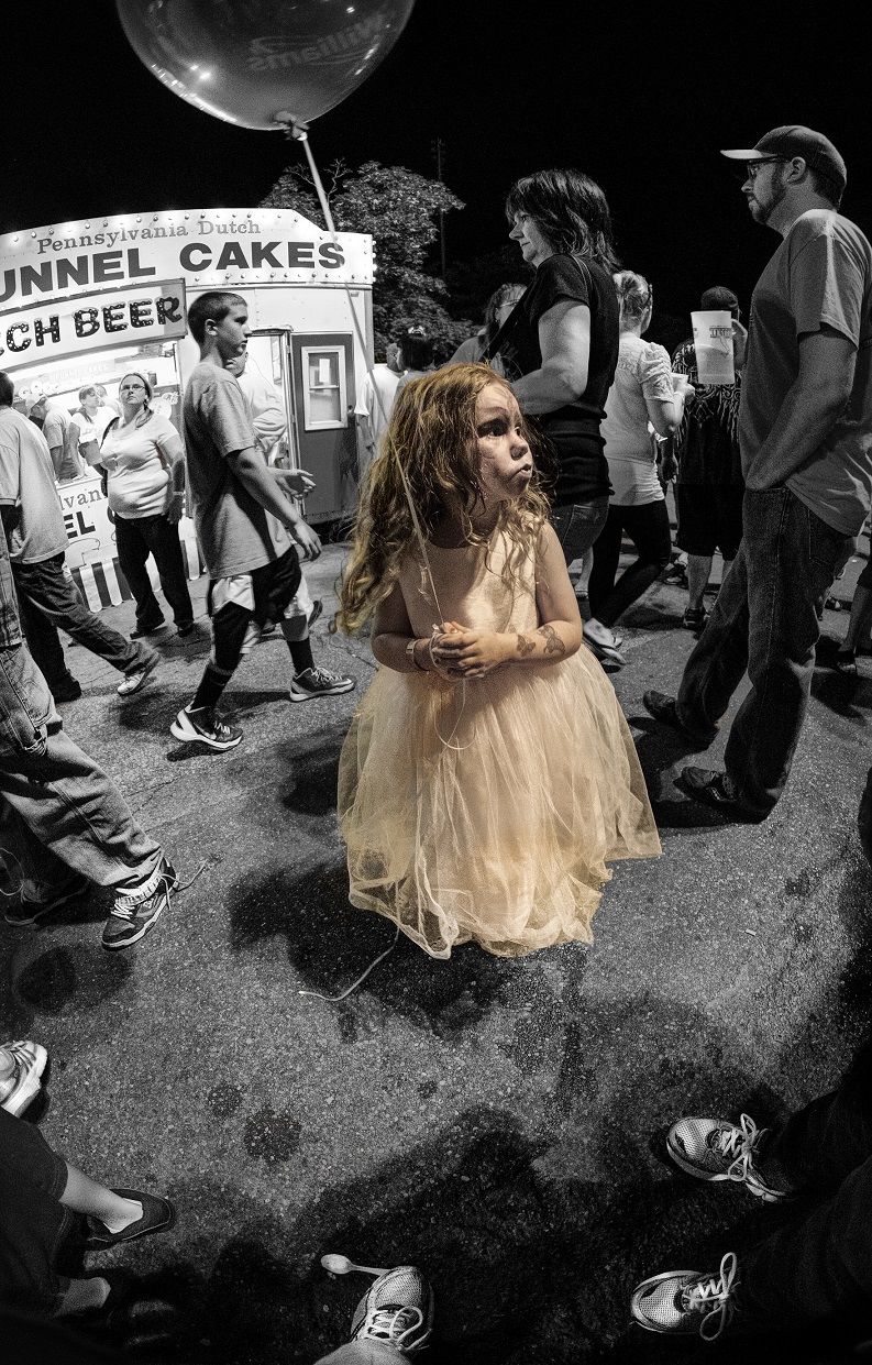

The Lost Princess (Candid)​
