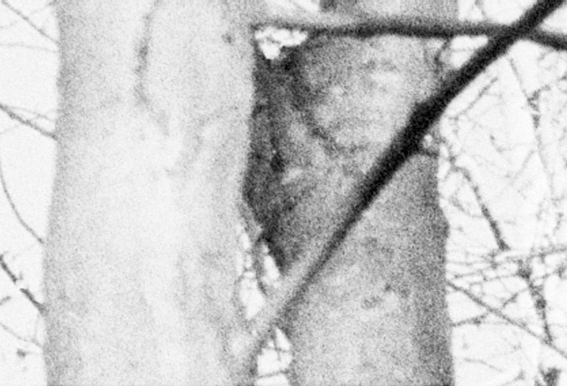

Scan of Grain Texture at 11'000ppi

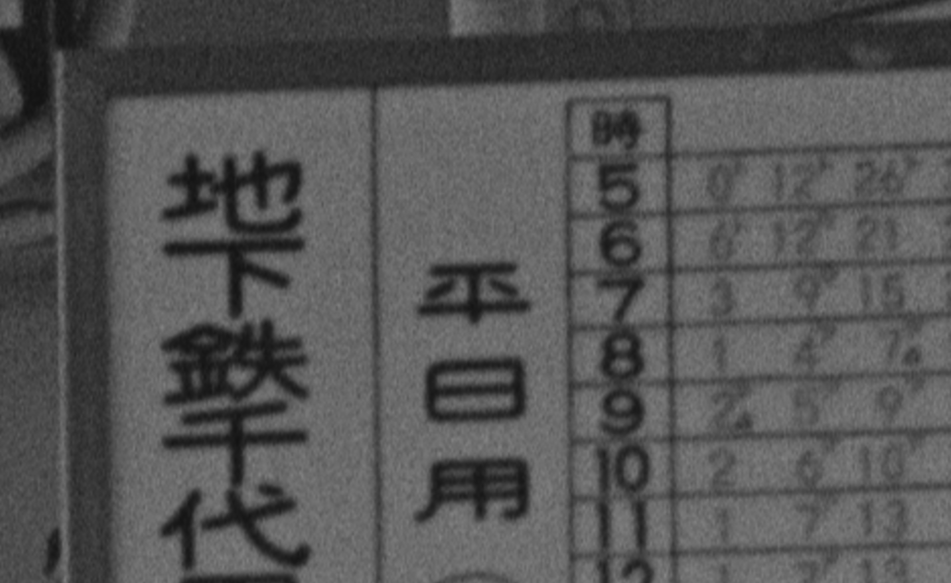

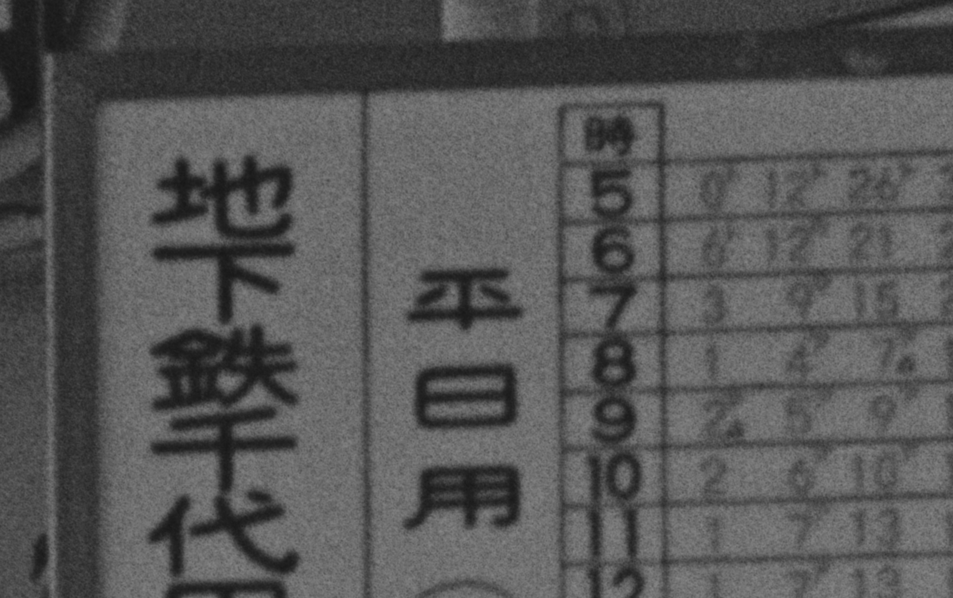

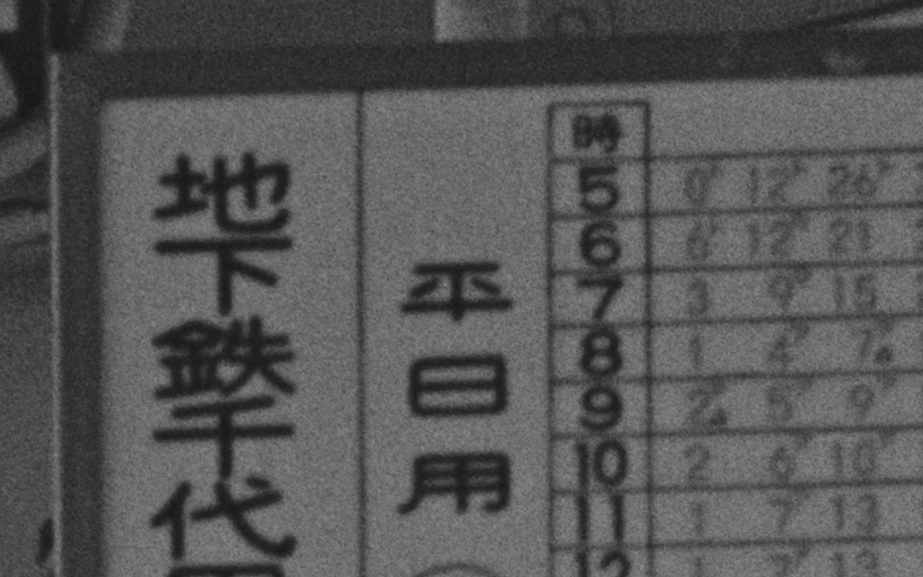

Apropos of which, the attached images are crops from "scans" of a Tri-X negative that I made with, respectively, the Nikon 9000 I used to own, a Fujifilm GFX 100S in single-shot mode (100 MP), and a Fujifilm GFX 100S in pixel-shift multishot mode (400 MP). Lens used with the GFX was the 75mm Apo-Rodagon-D 1:1.
well, the Nikon 9000 will give you close to 4000ppi of real resolution, but with quite a bit of scanner noise which will influence how the grain looks.
the 75mm Apo-Rodagon-D unfortunately is a rather poor lens and will not get you much over 6000ppi no matter what resolution the sensor has, but even so it shows that the Nikon scanner fails to resolve the grain structure properly.
if you print small or like soft looking grain, of course both setups will allow for decent results.

that's an interesting question. what I've found is that the appearance of the grain in films depends on a lot of factors...
for example, even on fully analog prints, grain will look different on different print sizes, different enlargers (condenser vs diffusor box) and to some extent even on different papers.
or for film scans, it will look different when viewed on an older 96ppi screen or a newer retina screens, or when printed on a lightjet or on a inkjet.
with scans, the tricky bit is to differentiate which details are coming from the film itself, and which are from the scanning method, ie noise, aliasing, synthetic pixel pattern.
as an example:
I scanned with an Epson V850 for a long time, which has quite soft optics, so scanning higher than 2400ppi didn't give me any more detail of the image, but it introduces a small synthetic pixel pattern that could be mistaken for image detail because it looked less soft.
similarly, drum scanners add quite a bit of noise that people often mistake for grain texture.
and the Imacon/Hasselblad scanners are very good at assembling the pixels so that the grain looks sharp and detailed, but it's quite edgy and not really the original shape of the grain.
in the examples of the T-Max 100 and Delta 100 scans above, if you open the images in a software that allows you to view them at 100%, you will see the true grain structure with practically zero noise or synthetic digital pixel pattern at this specific resolution.
there will always be some aliasing in any digitally sampled image (or sound for that matter), but if the frequency is high enough it's not going to be visible (that's the concept of oversampling).
I'll see that I can scan a detail in 20'000 and 40'000ppi next time I've set up the system for that resolution (takes quite a bit of time to adjust). at 40'000ppi the grain in many films (specially grainy color negative) starts to become less defined and more like clouds, so while we could say that is the "true" shape of grain, it's not how we usually perceive it (those who have seen images of films under a microscope will know what I mean).

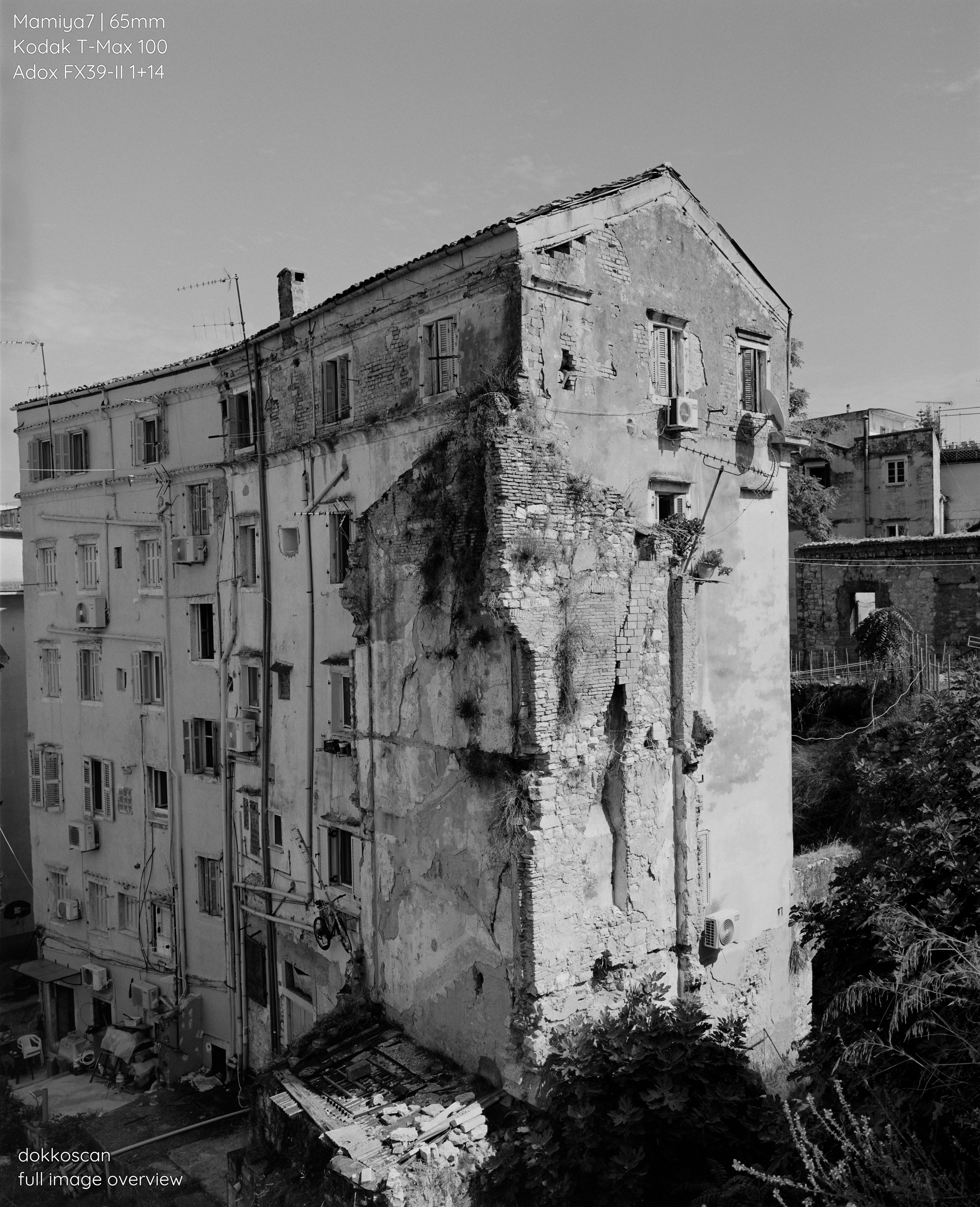

since there was the question if high resolution is only of benefit on microfilms, below a scan of a Kodak T-Max 100 negative, shot handheld with a Mamiya7.
first the full image for the overview:
and here three crops of 11'000ppi at 200% for retina sceens (best to open in a separate browser tab to see in full size):
