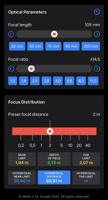

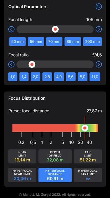

Ground glass focusing will never ever be accurate on a folder. A. The film plane is not where the ground glass rests. B. The ground glass is too coarse and the contrast and image too small to accurately focus on. Also fiddly as hell.
Optimum focus distance is far more important than infinity focus with a front cell focuser. Unless you plan on only using the camera for horizon shots. Even at fifteen meters accurate focus is important with 6x9.
The optimum focus distance is often found by dividing the focal length by 20.
So a 105mm lens like the Vaskar should be optimized for about 5.25 meters (5 is fine too as long as you’re consistent).

I’m taking careful note of this. Just one question: if instead of a folder I was dealing with a 35mm camera with a 40mm front-cell lens, your rule of thumb suggests the optimal distance would be 2m, which would be close to the minimal focussing distance. Is that really correct?
To tell you the truth, it really don’t know if it’s about an optical fundamental or if it’s just used as a convenient number, that was used as a shorthand.
It’s a number I’ve seen mentioned many times on forums where old repair people and experts chipped in, and in books on vintage cameras.
However, 2 meters doesn’t seem too close.
It’s where many subjects will naturally be placed.
After all we are talking about a very very gradual and slight transition from optimal to a little worse, but correctable with stopping down.
It’s less gradual the closer you get to the camera from optimal, until you get within about 1 meter for medium format and 80 cm for 135.
That’s why diopters was popular instead of just cranking the lens all the way out.
But still you’ll have to look hard to see a difference from a unit focuser.
From optimal focus to infinity, the transition towards worse is even slower and hard to spot.
In fact it mirrors DoF transition in general for the lens.
